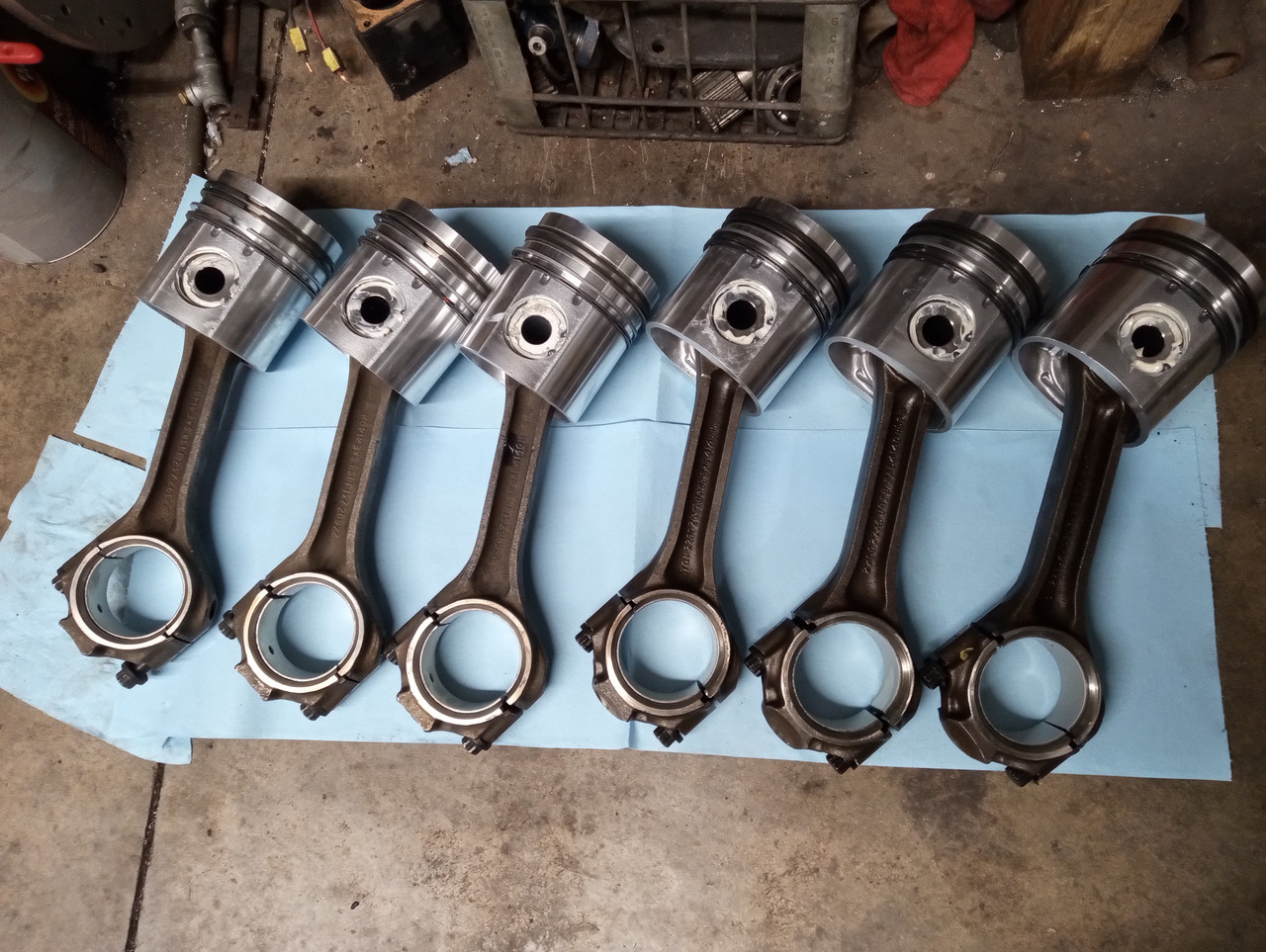

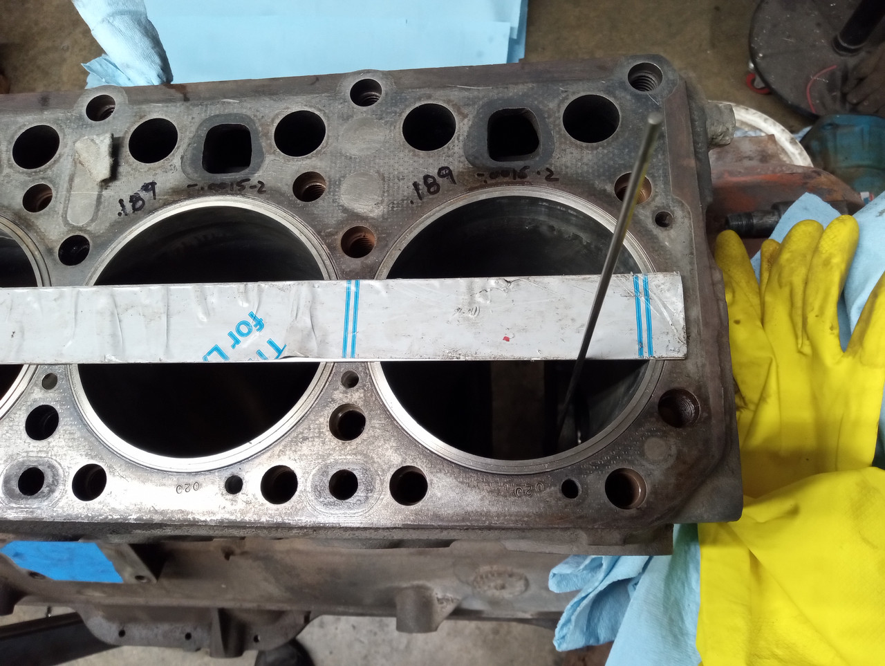

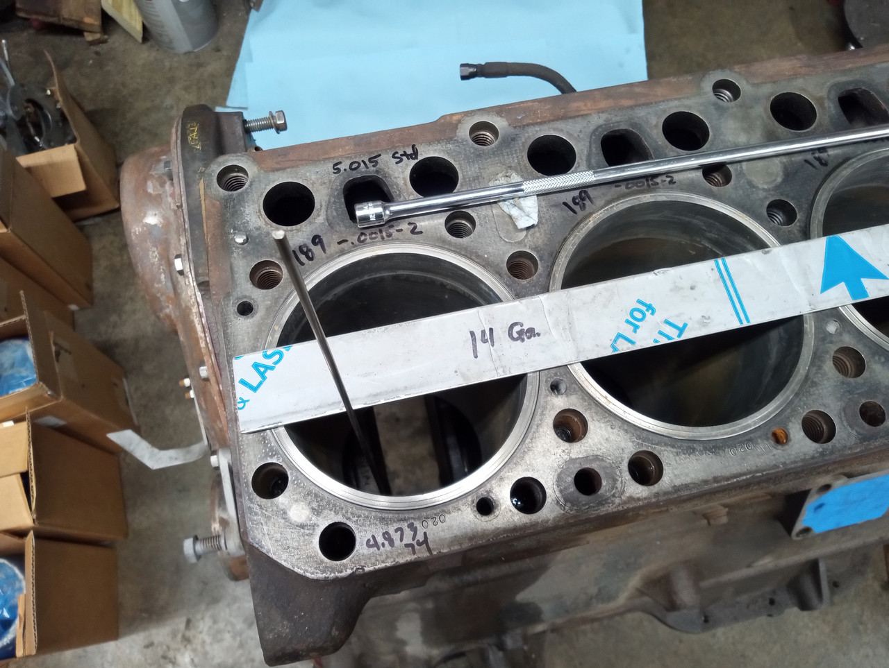

12 hours ago, Freightrain said:
All 6 ready....
I played around with oilers.  Not sure when I will get alignment tool so I think I will go off law of averages and get them all close to the same.
I laid a straight edge across block, used a piece of .125 TIG wire and measured all the locations from top and side of bore.  4 were close to same, two needed some finesse.  They are pretty close now within about 1/4" of each other's location.  I assume it needs to hit the bottom of the piston(basically missing the rod end).  Kinda up in the pocket behind the pin.  Using an old piston I just eyed up where it looks best.  Again, OCD is making it rocket science and probably was just fine before I moved a couple a little.
 Me thinks You should be fine doing that! as for the seal are you using the wiper ring or just a bare seal!?
