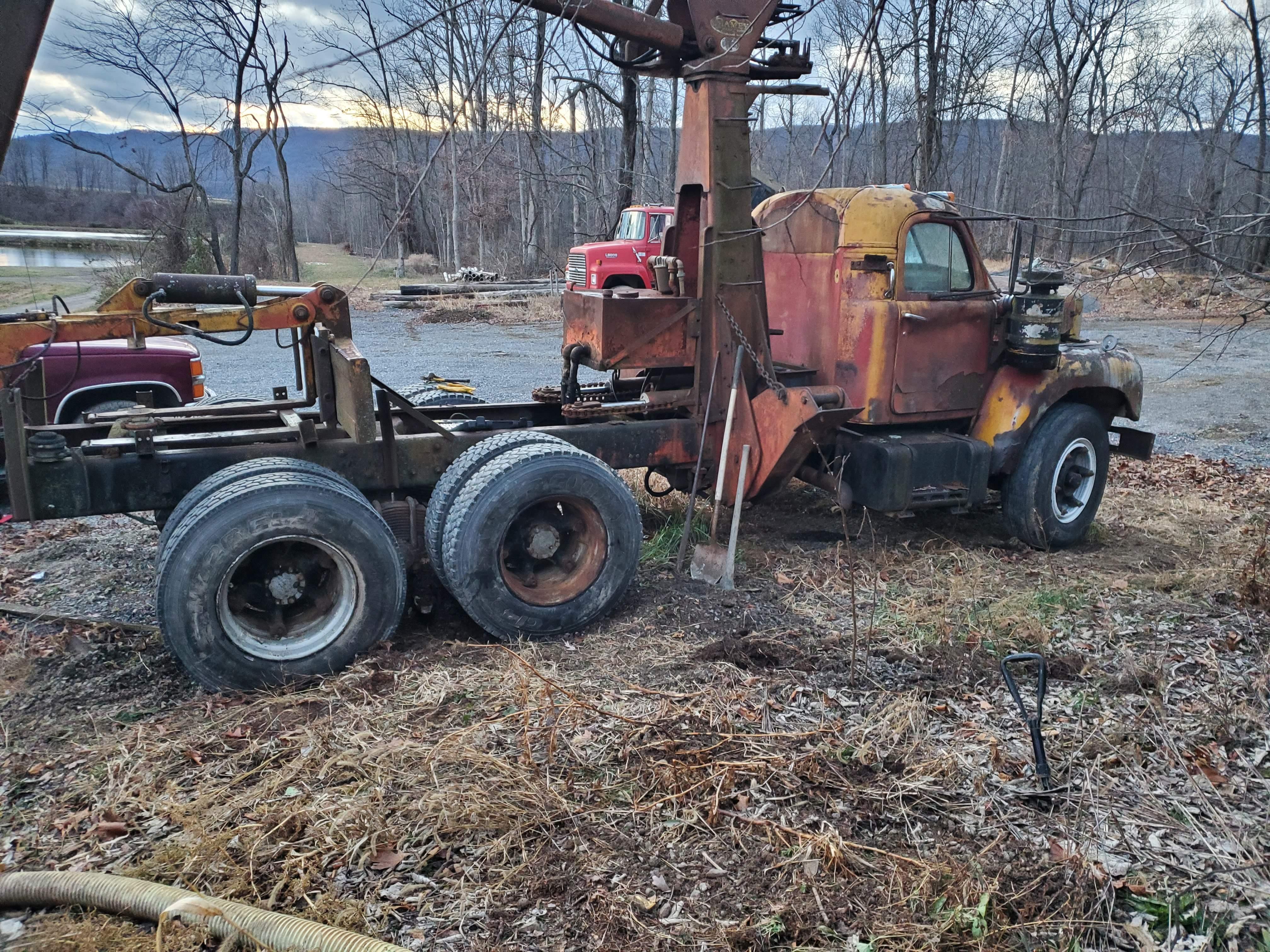

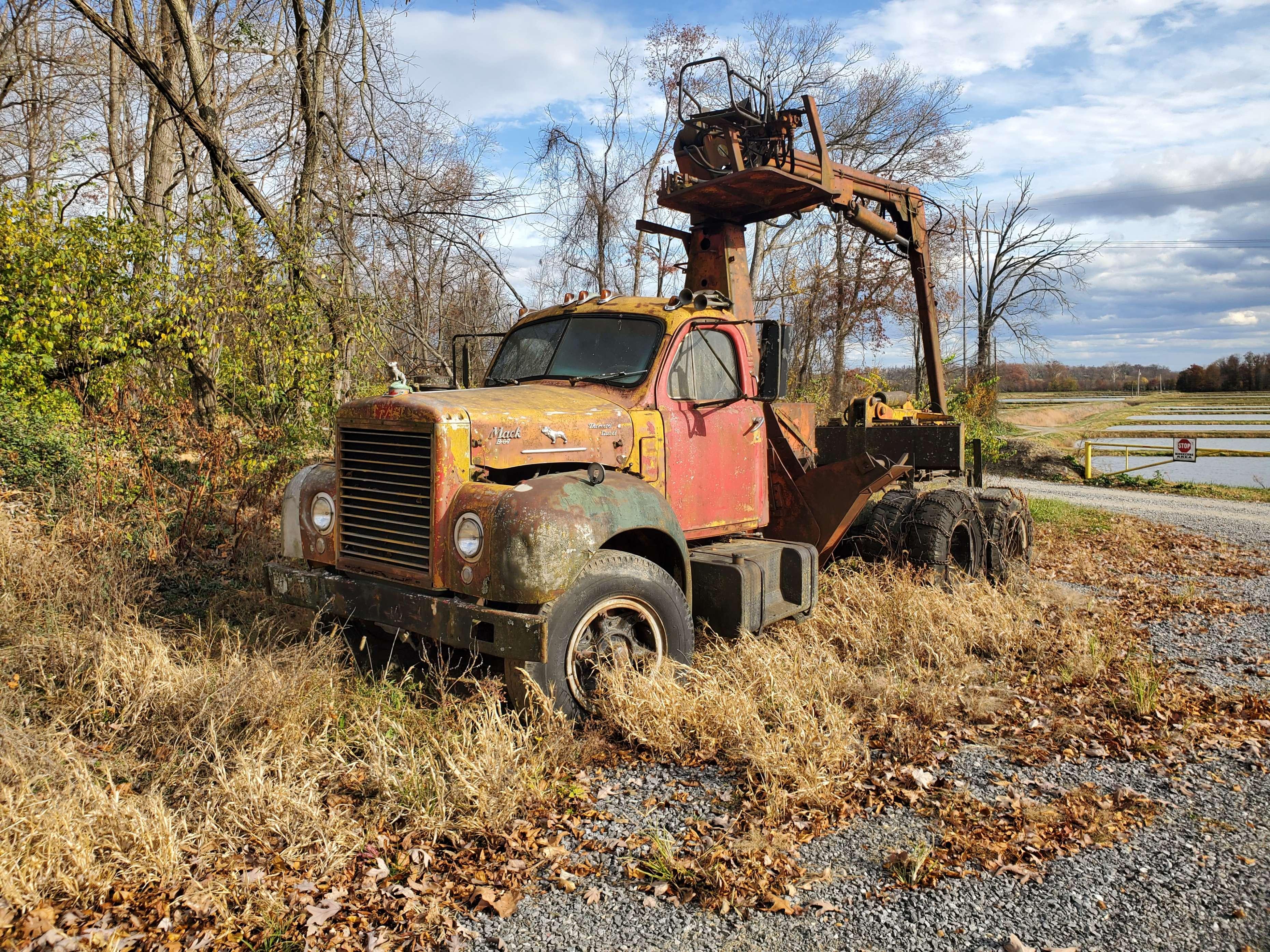

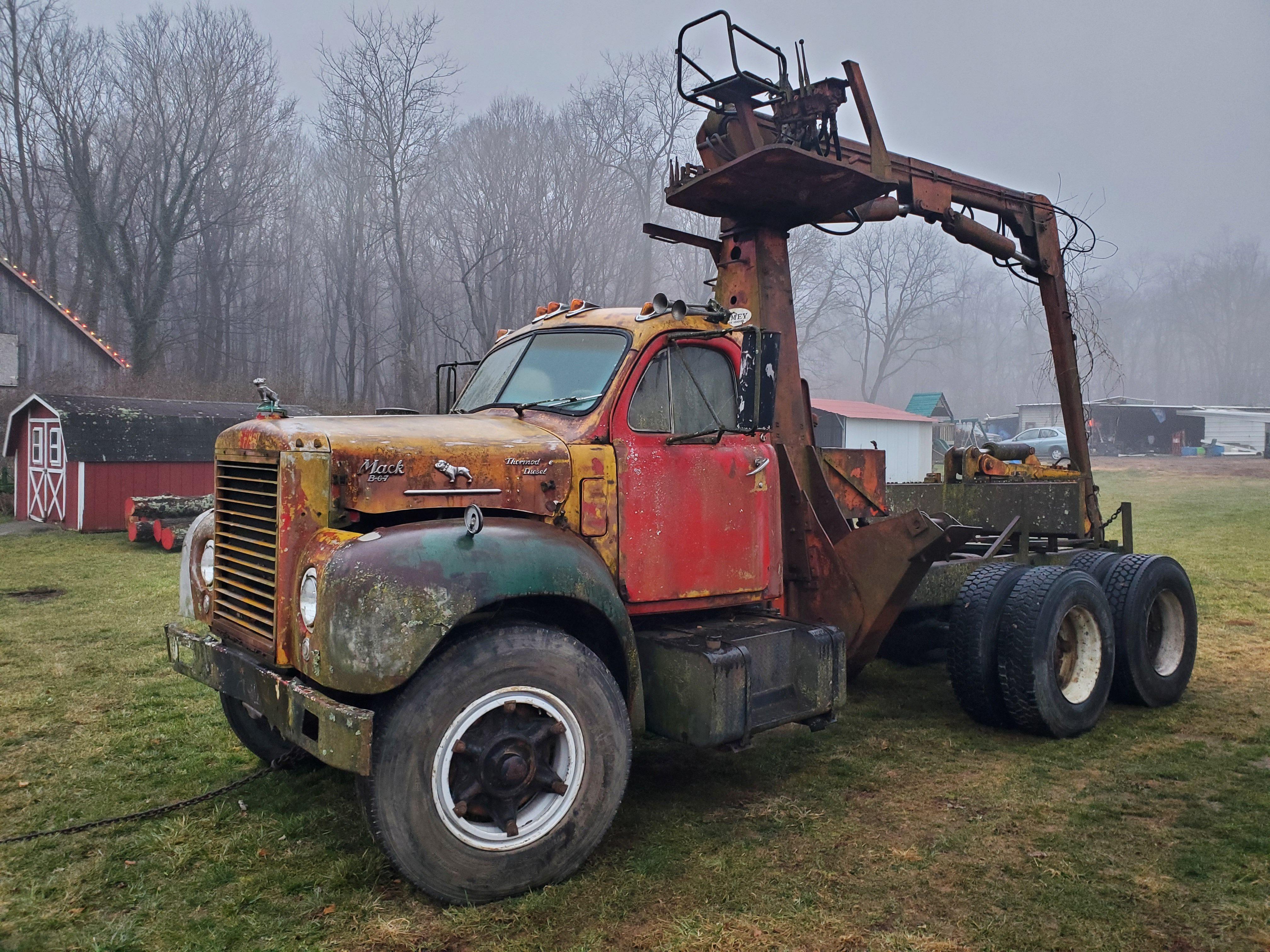

My grandfather assembled Mack trucks for 34 years and there has been talk in the family on and off for years about buying a B model Mack. Long story short, he bought a "toy truck" for me for Christmas.
The truck was built January 6-7 1964 for Gateway Transportation in Saint Paul, Minnesota. In 1974, it was acquired by a local fishery who put a Ramey pallet loader on the truck. The truck has never seen pavement since. The pond ice doesn't get thick enough to kill the fish anymore and the truck was just setting around. The old guy who has worked there most of his life would start it up to keep it running until one time he tried and it just cranked without firing. Not sure how long ago that was, but it was within the past 5-10 years.

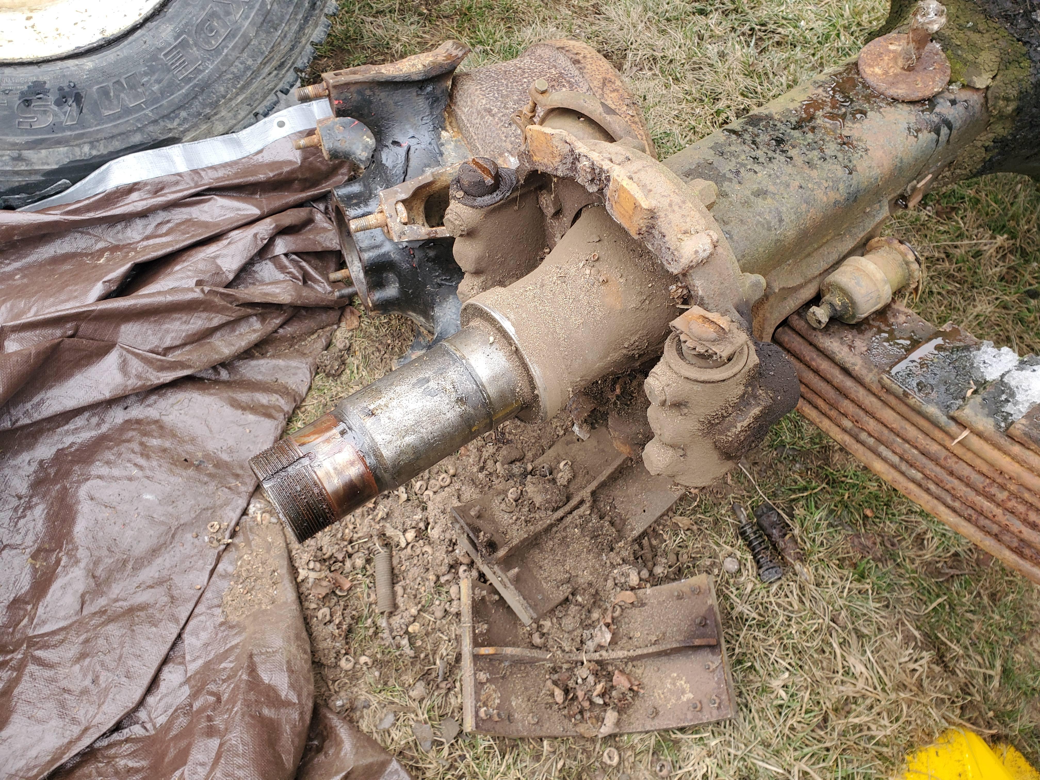

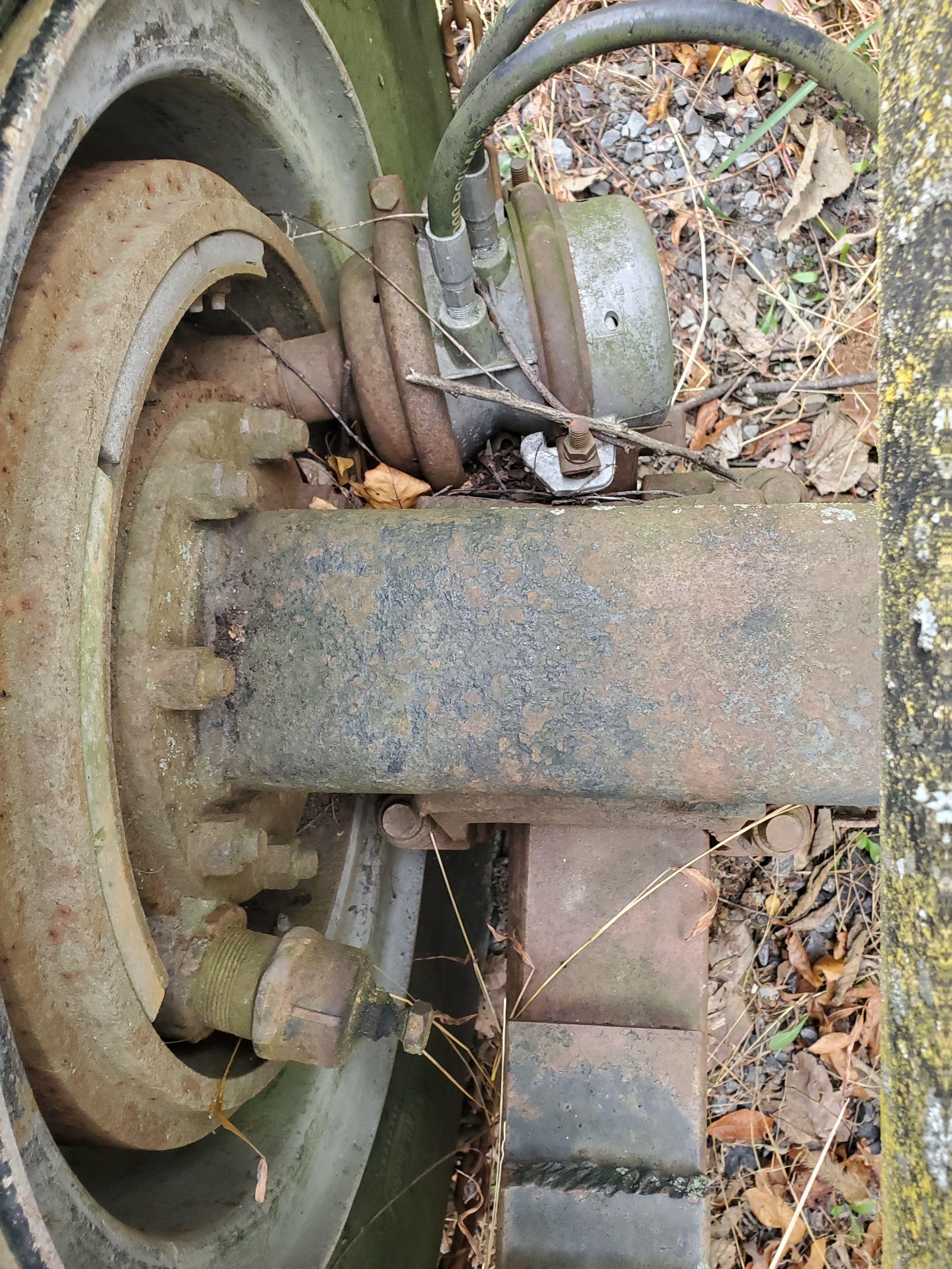

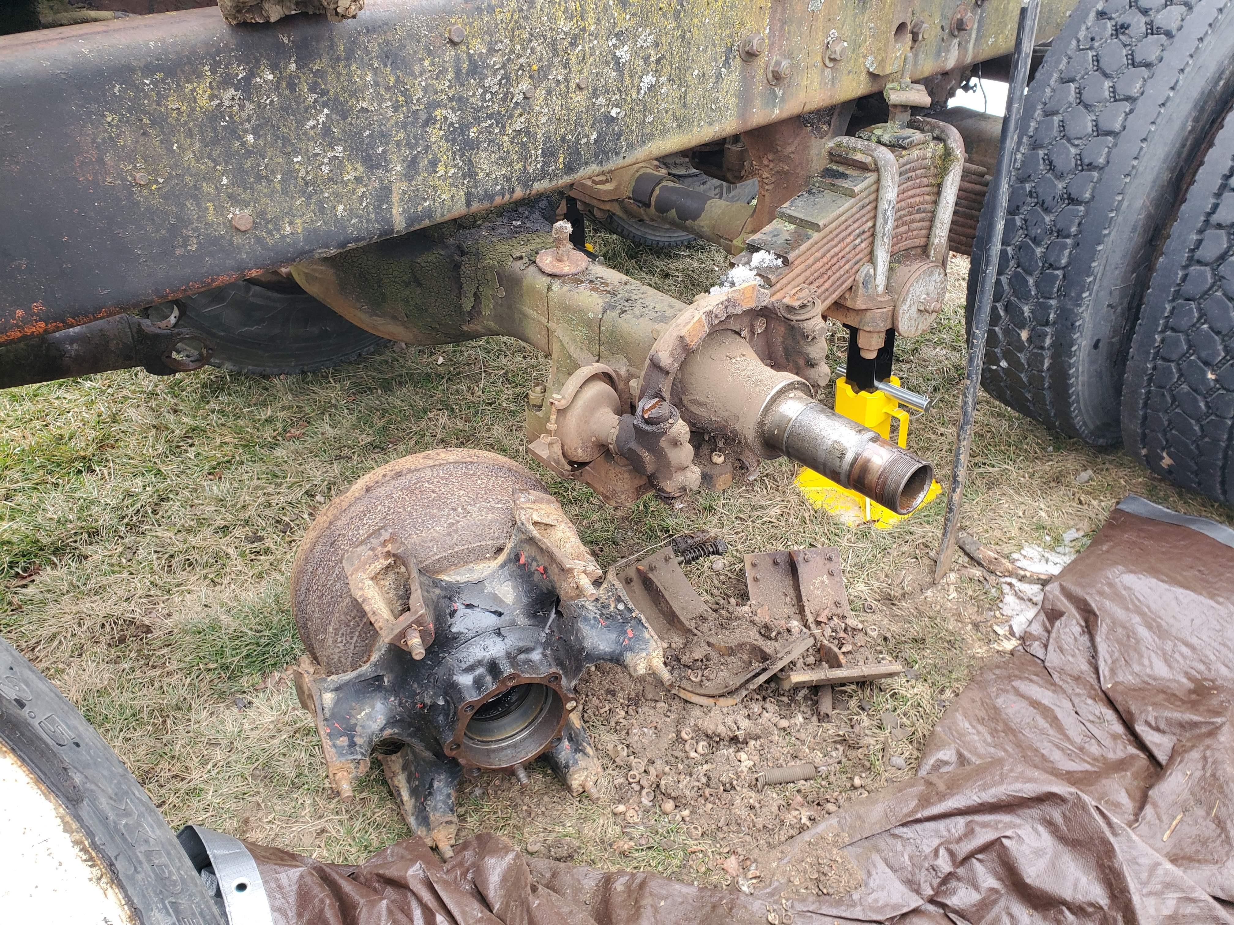

I acquired a set of solid rims & tubeless tires and had it towed to my house. I'm starting with the brakes and axle assemblies to avoid the temptation of driving it without brakes. It has 15"x7" wedge brakes. While I'm at it, I want to address the leaking seals on the carrier assemblies. I'm not sure where to get parts. I don't just see parts list/diagrams. Also I am not aware of a parts locator like the NAPA/Autozone has on their websites. Any advice on where to start?

Good for you for attacking the brakes 1st. I would have put them ahead of rim changes.
Wedge brakes have their share of detractors, and not somewhat without reason. When working properly, they are capable of stopping the truck with smaller drums and narrower shoes all while using less compressed air, all while being self adjusting decades before auto slacks where common. That is the good.
The bad is, they have a tendency to freeze up if the wedge piston seals are damaged or missing. From your pictures I would say they are missing.
The key to them is no rust or oxidation, plenty of lube on the adjuster and good "soft" rubber seals keeping the moisture and brake dust out of the actuators.
By attacking the brakes first, you will know if you can bring them back.
Be very careful to note how things are assembled, and make sure you can get full kits to bring it back. There is a little ratchet spring that turns the adjuster depending on how much movement is required for the linings to contact the drum.
 When they are all restored, they can be very good, but if it sits they freeze up easier than S cams.

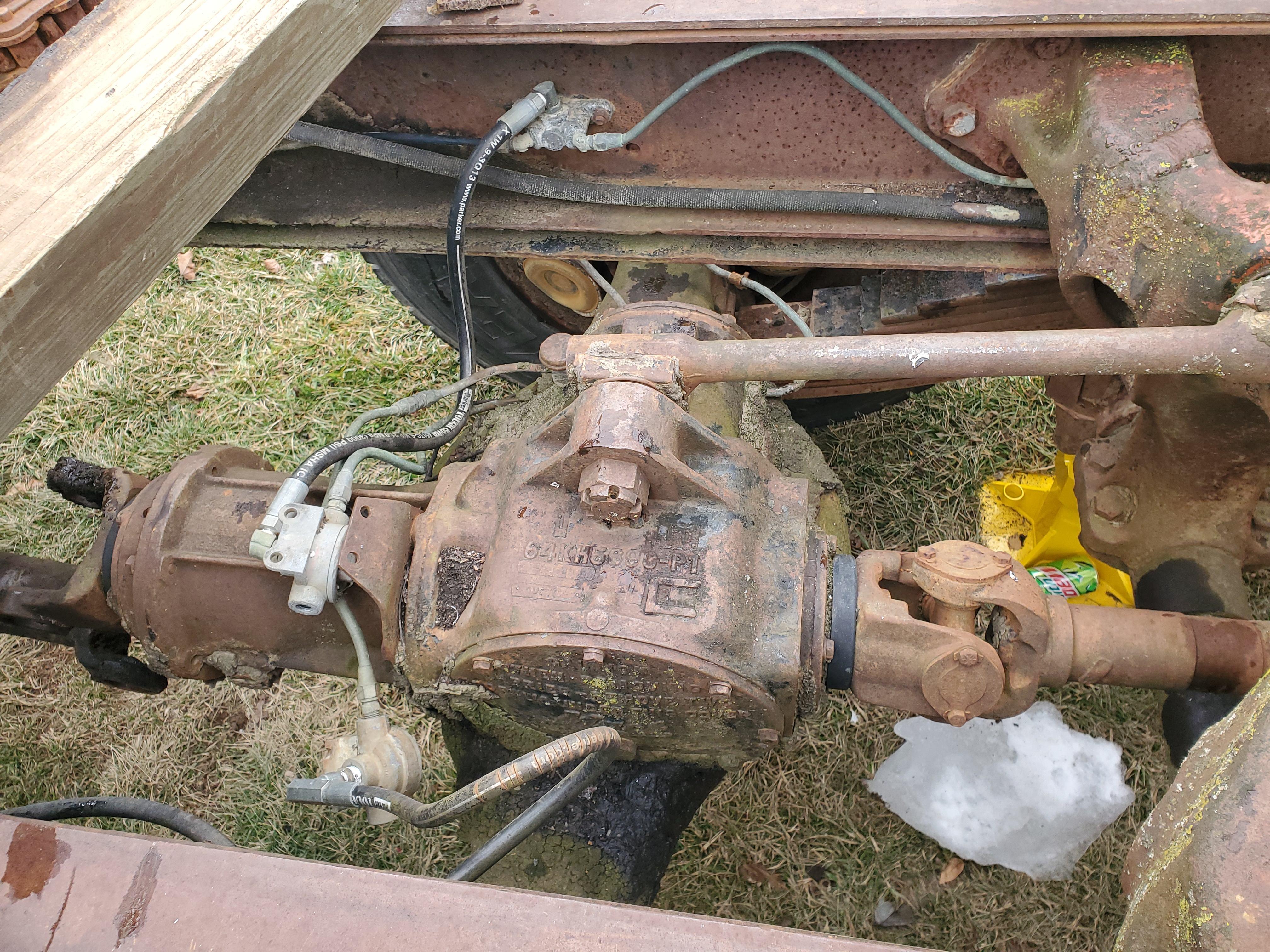

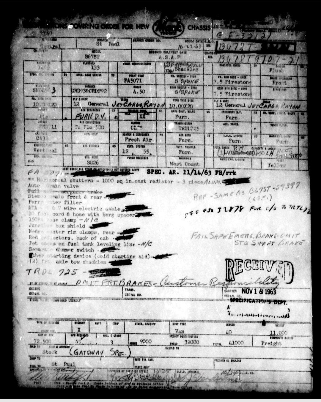

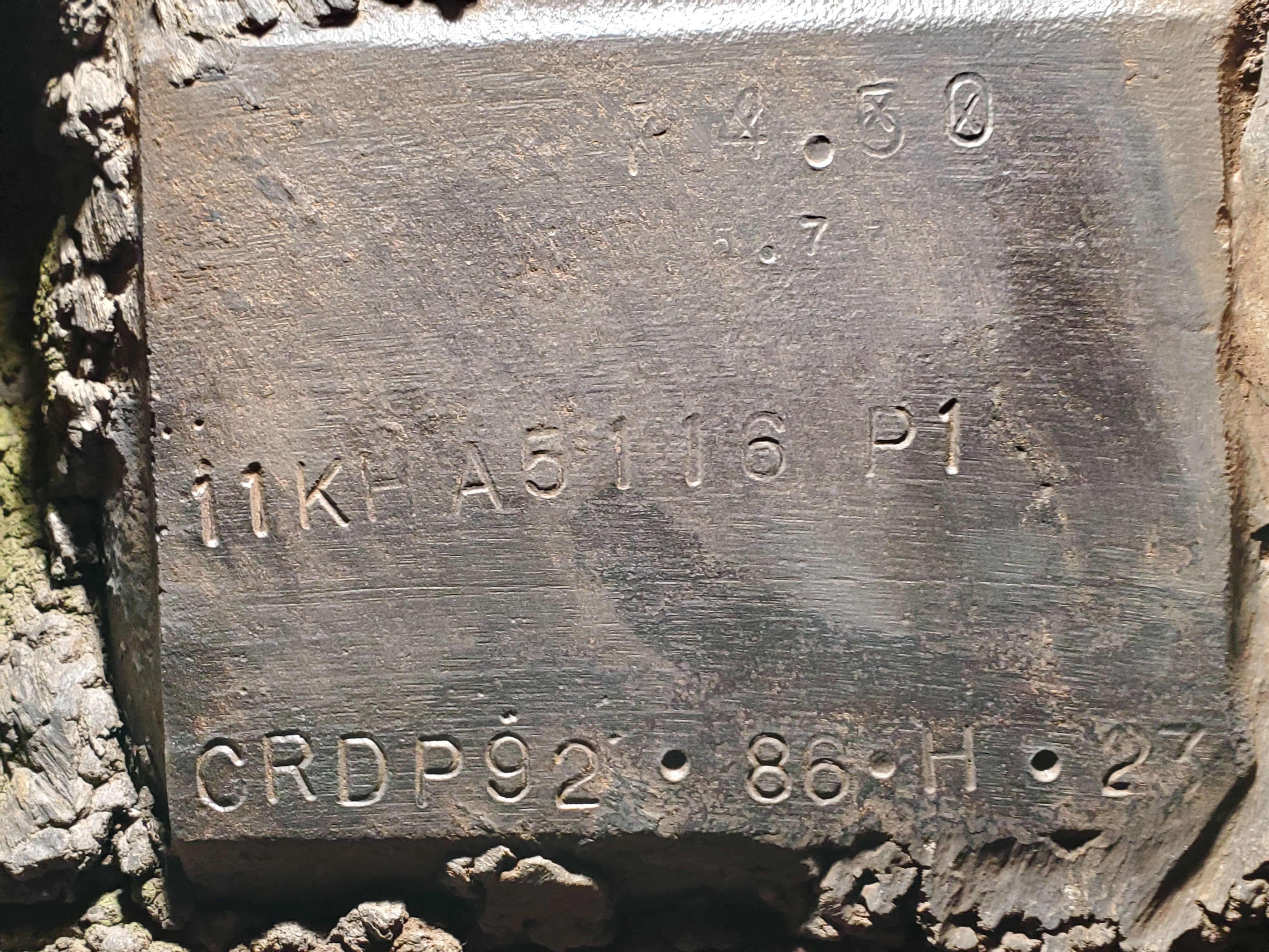

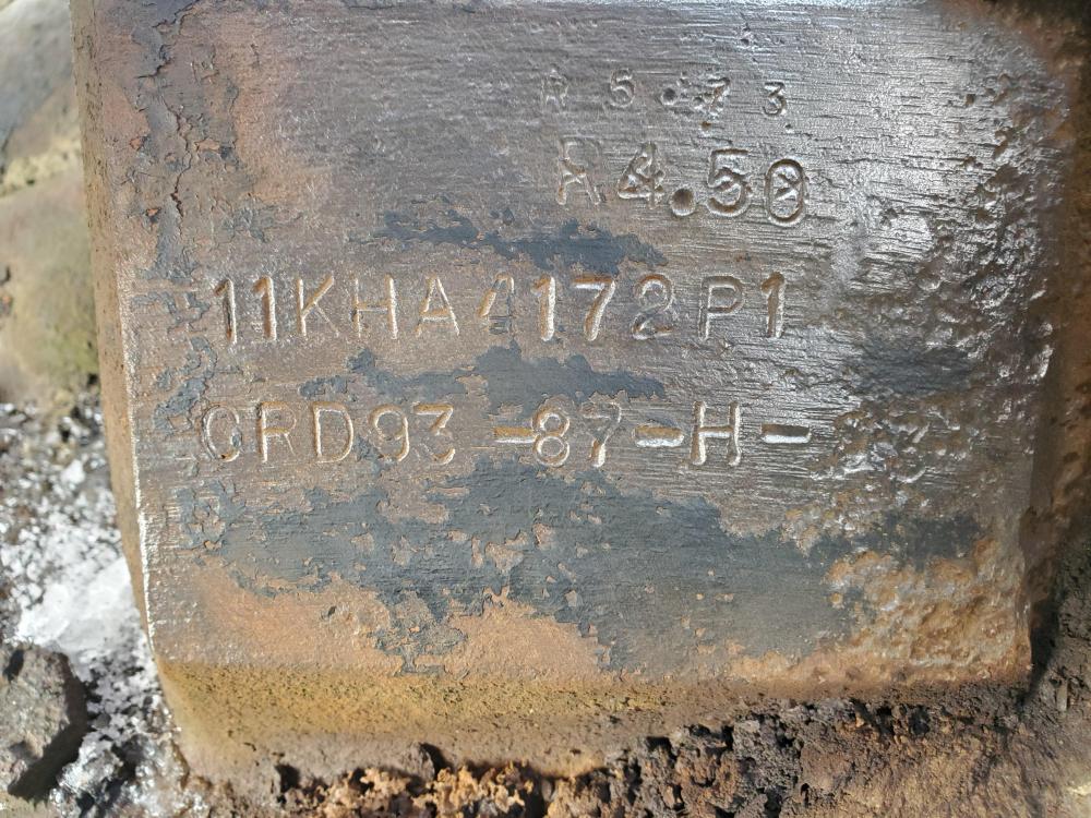

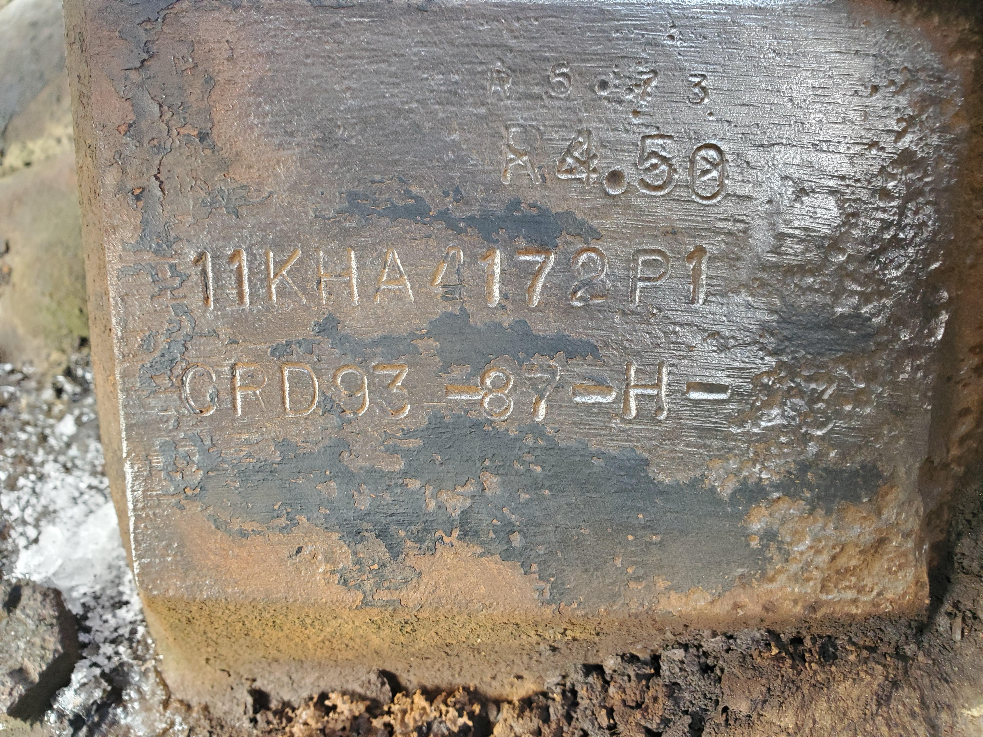

Not exactly sure how to interpret the carrier data, but I wonder if it got another rear end when the loader was added. There is a weld on the frame between the cab and axles. I haven't measured the overall length, but I think it may have been lengthened. There are no holes anywhere for the 5th wheel that would have been used by Gateway originally.

Geoff Weeks, thanks for a strait forward overview of wedge brakes. I've read some very strong opinions in here against them. Initially the truck is just a toy and will only be driven on the weekends for fun, and if it does do any paying work, it won't be frequent. My preference on antique toys is somewhere between original and functional, so I'm not sure if the wedges stay or not. I lean towards keeping them as long as they can be rebuild for a reasonable price.
It is almost always cheaper to go back with what it came with.
It may look simple to change the spiders, but there can be a ton of stuff that has to be changed that isn't immediately evident.
 Like: the flange the spider bolts onto, being different for wedges than S cams or even being "clocked wrong" for S cams.
What you have now, did at some point in its past, all work together. When you start changing stuff, you may find what "looks like it should work" doesn't.
I have one truck with Wedges on the front (built that way).
Unless you have an exact parts truck with the same rears and suspension but with S cams, there are a lot more questions than answers.
Not only with the spiders be different the drums will be also, S cams need 16.5 x 7" to do the same work.
Every once and a while I see "loaded spiders" for sale on the internet for wedge brakes, as the military used them
A hobby truck that isn't going to be worked hard and put up wet, should be fine with wedges.
Edited by Geoff Weeks
Every wedge brake tractor I converted to cams the first time anything went wrong with them. And we had a lot of ex Matlack and Chemical Leaman trucks
Thanks for the info. I have a chevy truck that I tried to do a few things to without removing the throttle body and OBD1 computer. Long story short, it runs, but not right. Some things are better left factory.
Kits go for as little as $32 surplus on the internet to over $1000. A lot depends on what kit fits your application and what you can find.
Which is why I suggest takeing yours apart, assessing what is re-usable and what is not.
$1000 per wheel end is very high, but before you consider changing to S cam, you'll need to find old (likely obsolete) drums that fit your 1964 hubs. Back then there were a lot of drum styles and not all are still made. You can't re-use the drums you have because of brake shoe diameter.
If your current drums are serviceable, that knocks a big chunk off the cost of getting working brakes.
I bet if you look, you can find a FIO Military manual for wedge brakes that will help you decide what is reuseable and what is not.

Original 4:50 rears have been regeared to 5:73 ratio.   Terry:MackLogo:
Depending on what the trans is, he might want to just change the whole cutoff.  If that truck had a direct trans in it 5.73 isn't going to give much road speed. It could top out at around 40
  • Thanks 1

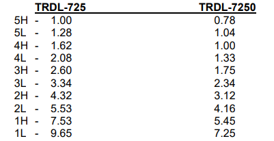

I am glad I came here before spending on parts! I believe it still has the factory 10 speed uni-shift. The spec sheet says it should be a TRDL-725. What top speed would that give me? If I can't get 55-60 mph, then I'm going to rethink my plans with this truck.
My B model had a low rear and a duplex out on 81 I was a sitting duck couldn't get more then 50 miles an hour and in todays traffic that isn't good I slid in a 373 rear and that was a lot better had s- cams and about new brake shoes and good drums. The duplex started to jump out of nineth gear so in went a 13 speed triplex and I can cruze 70 on the highways.
Looks like it was a factory tandem since the build data says B67 "ST". The S means tandem. And T means factory tractor. Was probably lengthened for the pallet loader. A wheel base should be listed somewhere in your build information.
Edited by 67RModel
As built now I think 60 is not obtainable.
Before you do a bunch of guessing, confirm what ratios you both rear and transmission. Do the math and then decide what is the most cost effective way to get what you want.
11x 25.5 tires have a 501 rev/mile diameter.
4 hours ago, Will100 said:
TRDL-725
If that and the 5.73 are correct you are going to end up with 392 RPM at the wheel. Depending on tire size probably a few MPH +/- of 40
A "10R20" tire typically has around 497 revolutions per mile.
Edited by Joseph Cummings
A set of 4.17 ratios (common in maxidyne 5 speed trucks) will give you 65MPH on like 10r20s or 11r22.5
But now you have to think if first is low enough.
So the stamping of ratios on diffs means it was changed from 4.50 to 5.73 gears? Possibly when it was changed  to be an off road truck perhaps. You are doing important stuff but cleaning up what looks to be the aluminum radiator and fender piece, will give you something to look at and think we’ll get this someday! Truck looks pretty good for the life it has lived……Jack
Assuming those new tubeless tires you put on are 11R22.5 (498rev/mile) then you have 5.73 rears and 5th gear is 0.78. In a duplex transmission hi is direct (1:1) and low is underdrive. So with all that said on a 2100 rpm governor you will be doing 56.5 mph theoretically on paper. If those are 11R24.5 then you will be a few mph faster at 2100 RPM. FYI.....
4 minutes ago, Joseph Cummings said:
OK. then 44mph on a 2100 rpm governor with 11R22.5 rubber. 🤣.  I have to think that was slow even back when that truck was in its heyday. I forget the final O.D. ratio in the quadbox but my B81 had 9.00:1 rears and was good for about 42mph on 1200-24 tires maxed out on the governor but it was set up to move major weight. Unless going real local it wasn't even practical to bobtail to shows.
