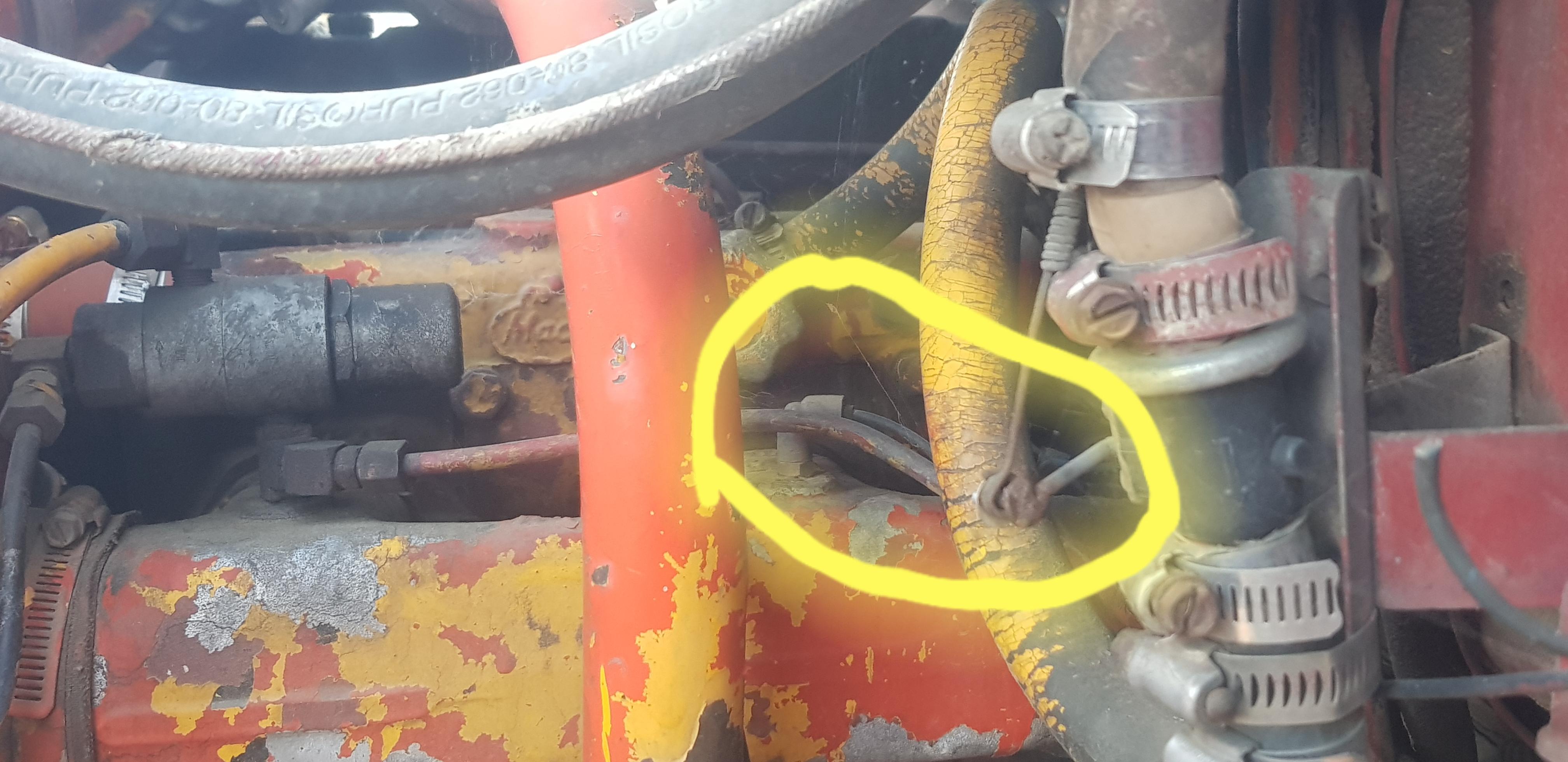

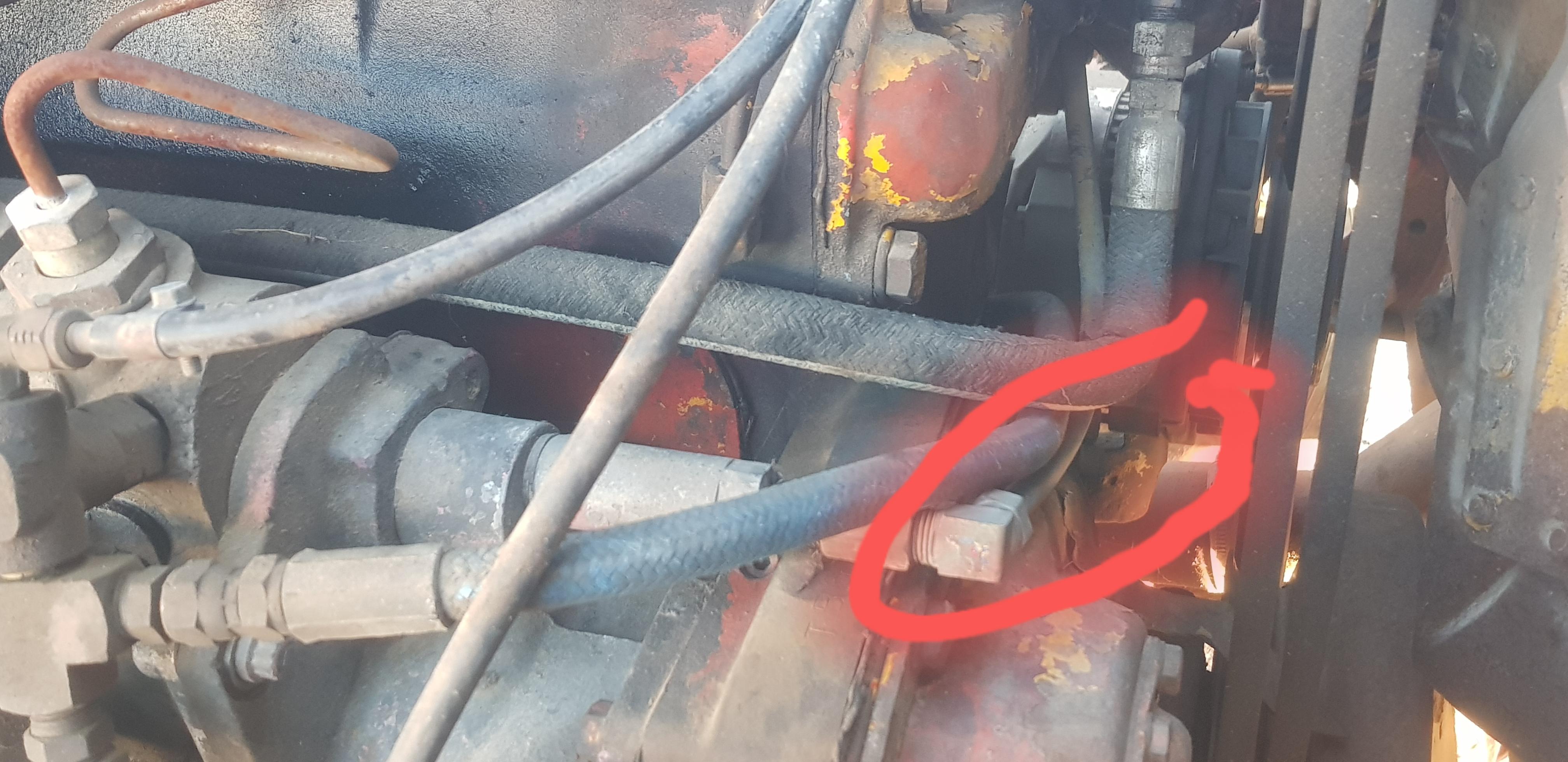

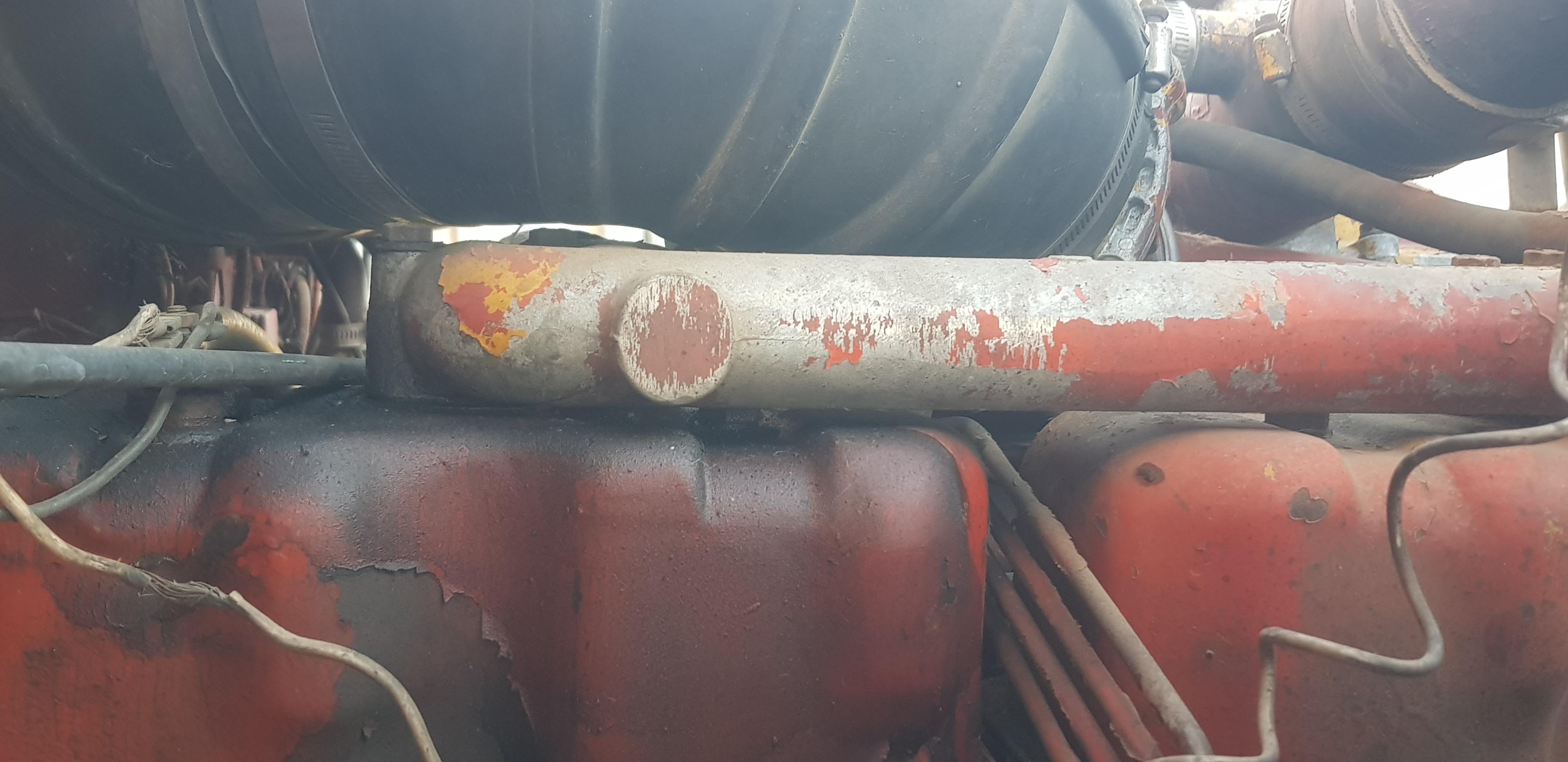

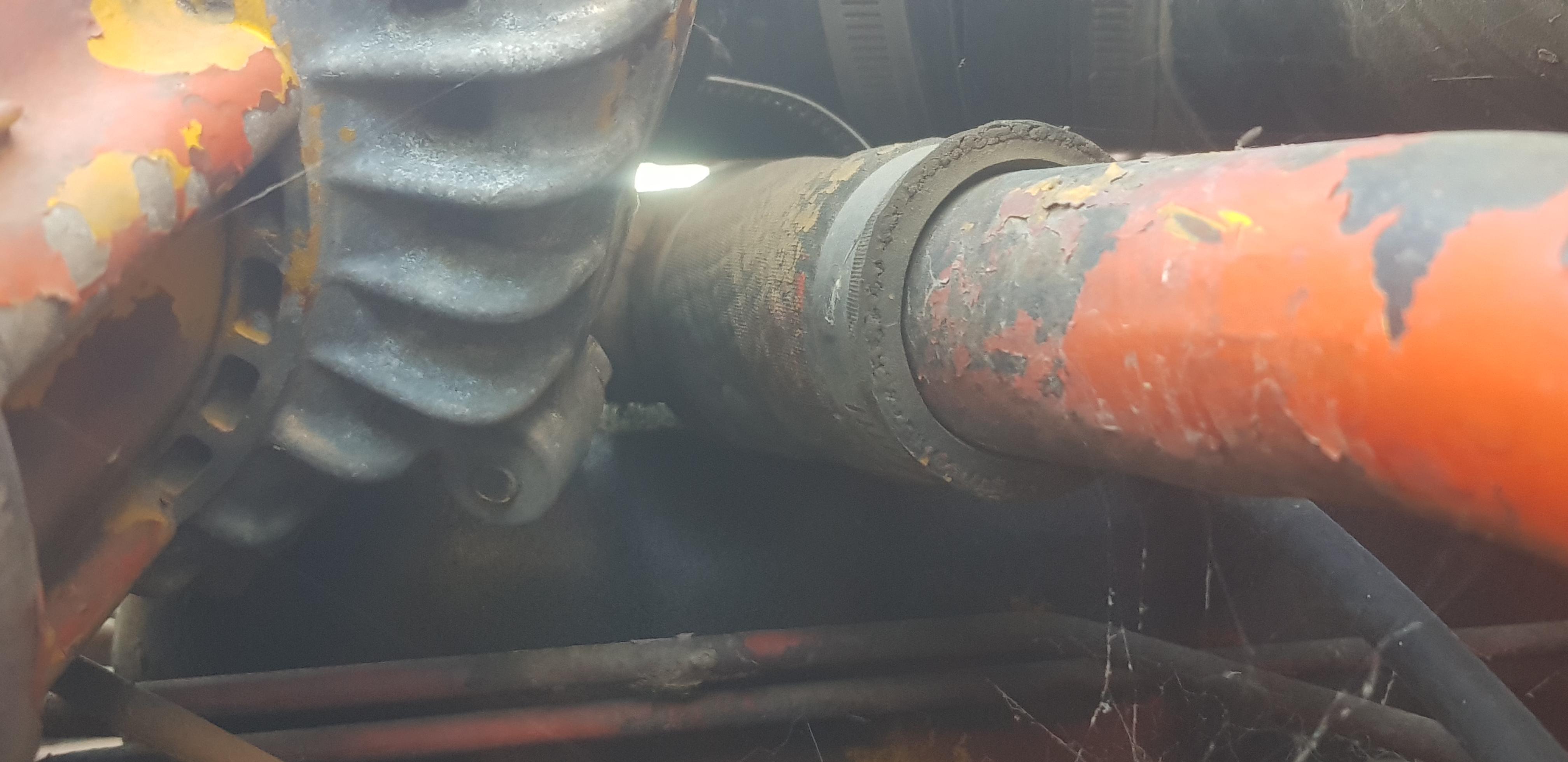

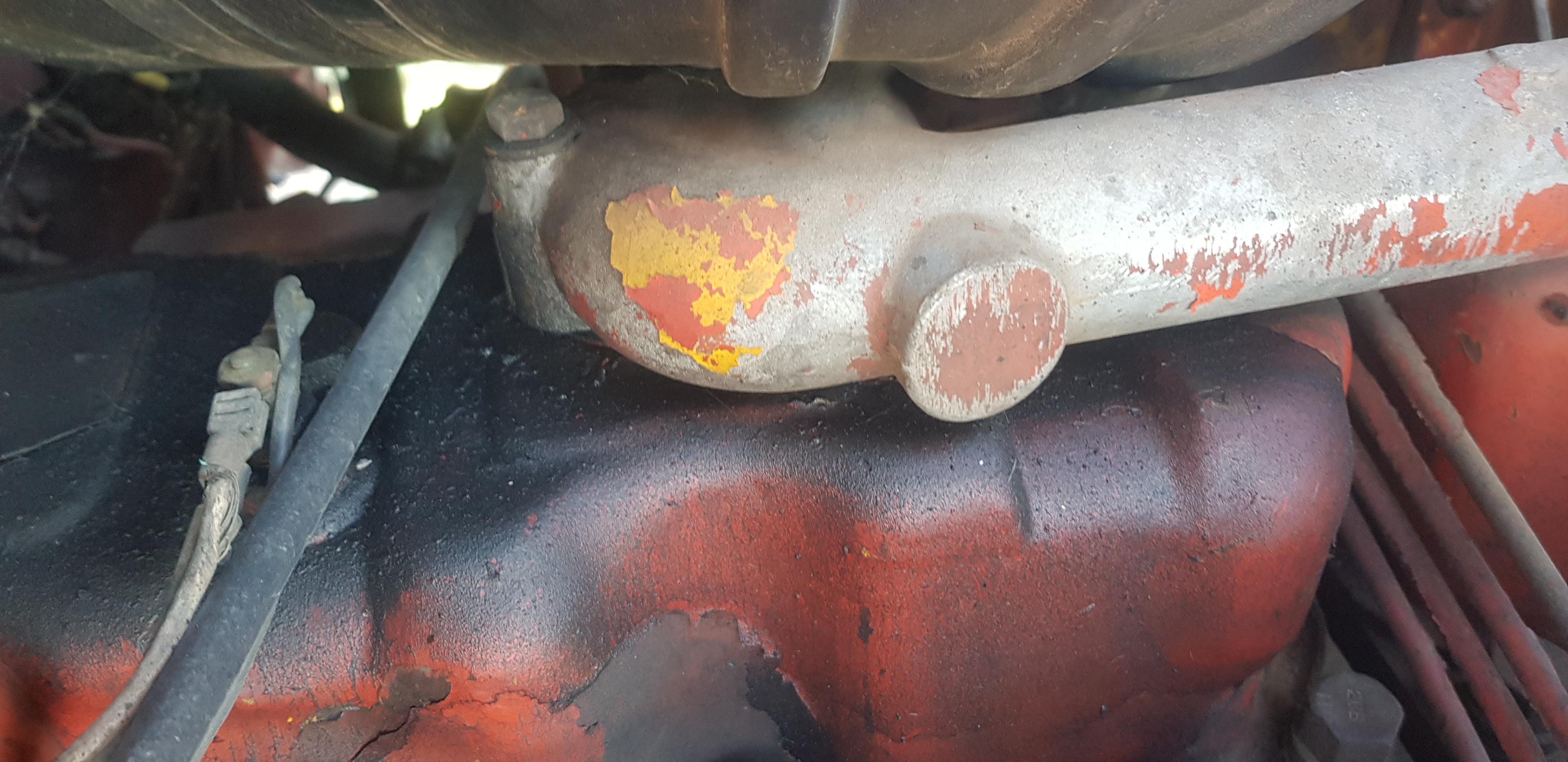

Okay, a cracker of a day so had a captain Cook
Now remember my truck has the steering wheel on the correct side unlike the U.S. trucks
I only mention this because our trucks might be plumbed a little different

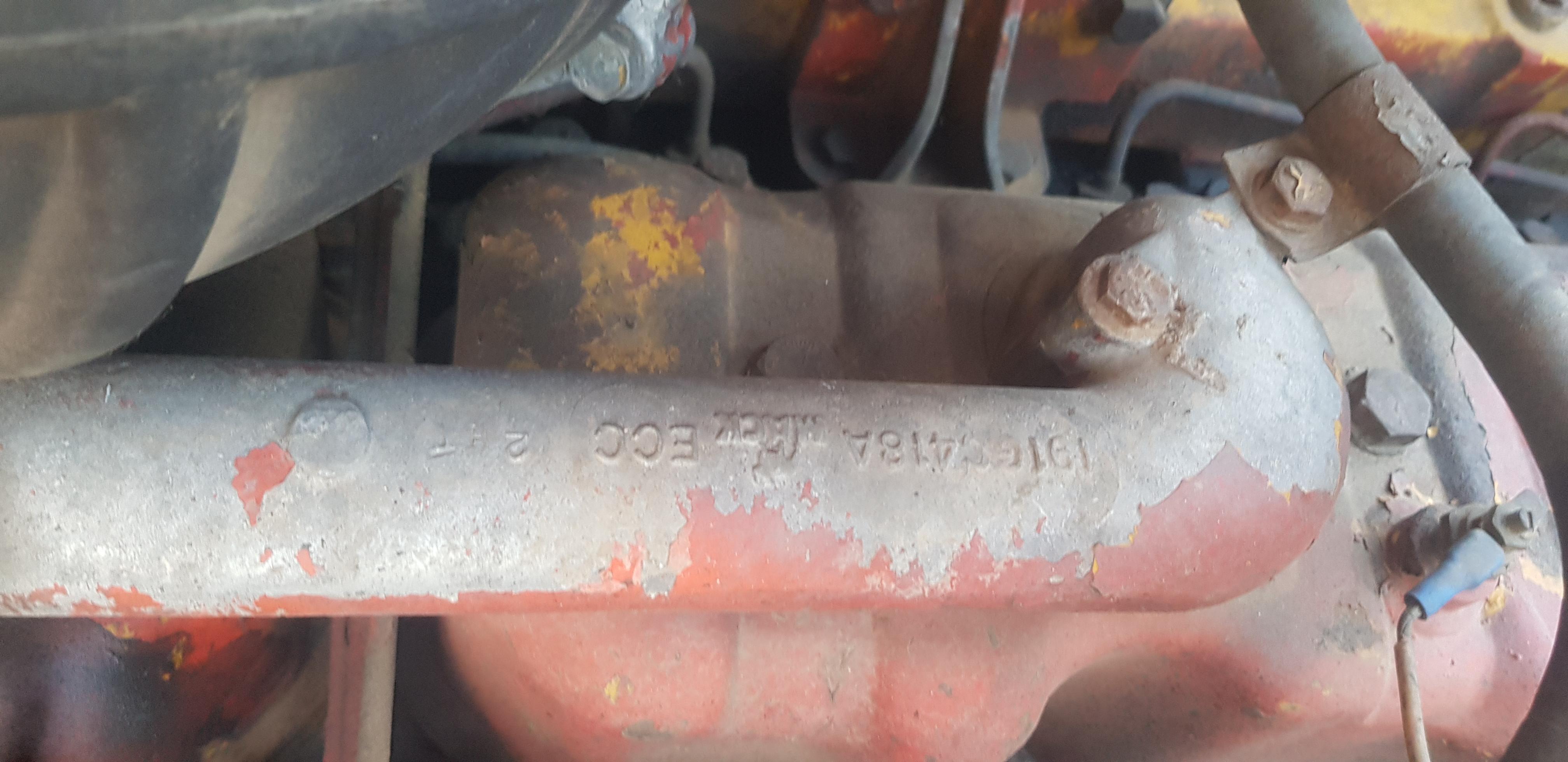

The breather on the rocker cover on mine has no holes for hoses, it does have spots cast into it
and the casting numbers
But wait theres more

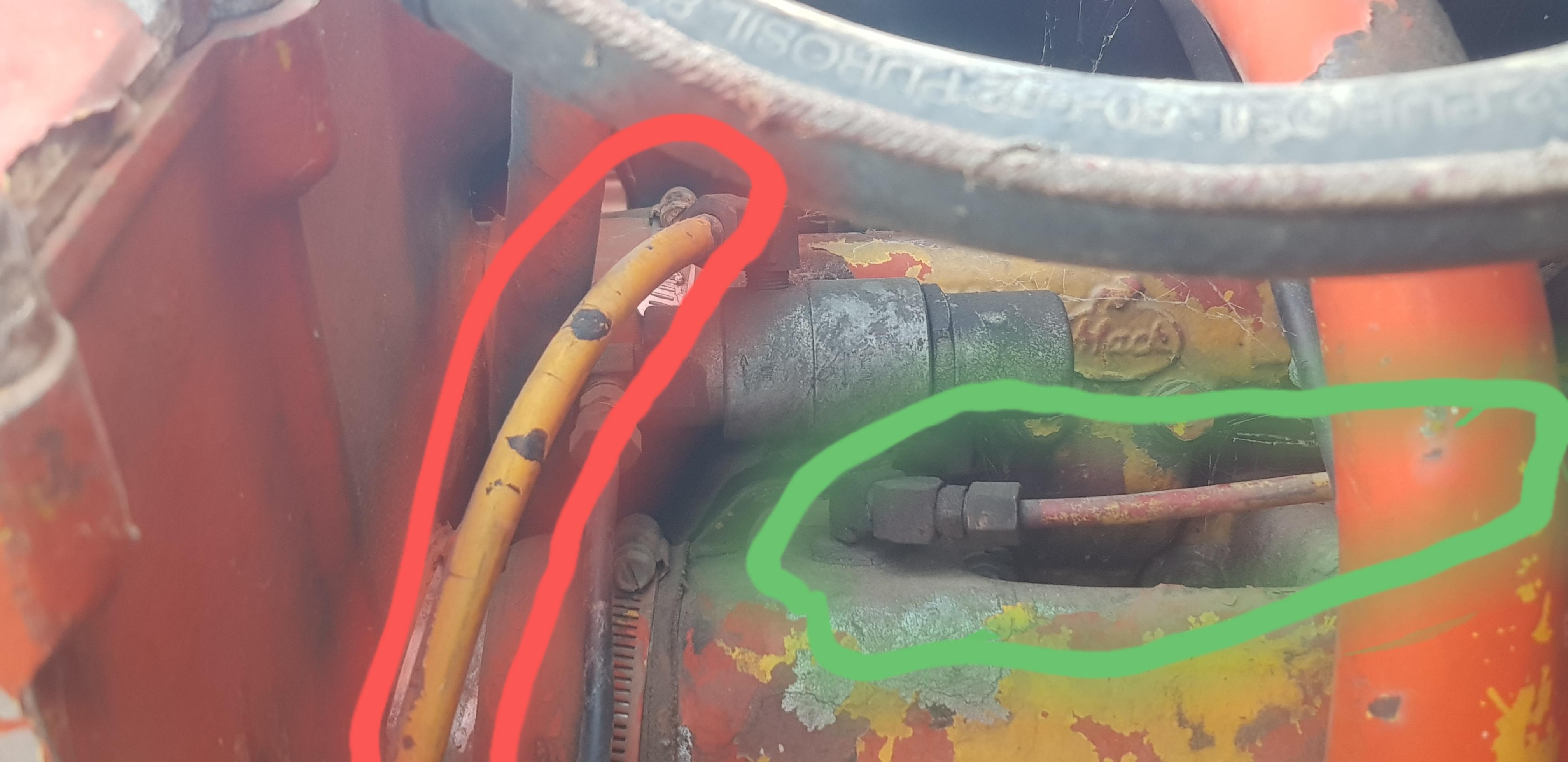

So were do these air lines go
Green circled airline goes to the gear box, reverse, first
Red circled airline goes to the injector pump rack
Now crusieliner 64 Paul
This looks like a simple piston type of deal, I can see bleed holes etc to let air out and or in
Yours should be a piece of piss to fix over a few pints of your favourite larger

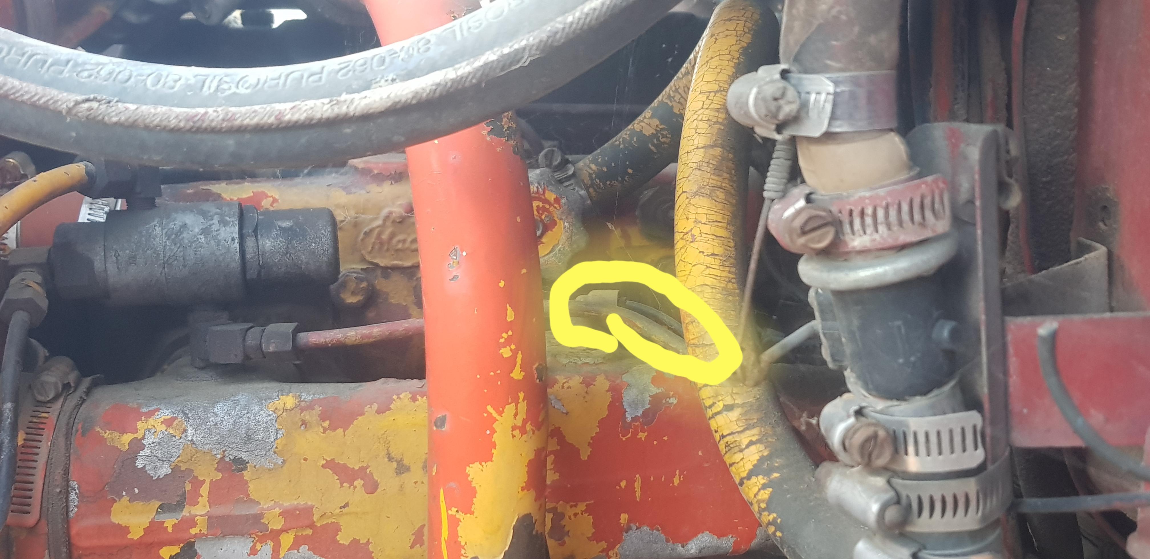

Bellow is the air line to my boost gauge
Hang on I'll zoom in on this
Dunno if any of this helps, bit old mate the sorted your motor has jiggered up the plumbing department
Licensed to thrill your missing a (as the younger set say out here) "a shit ton of boost"
I wonder if the breather is for a cab over type of deal, possibly a garbage truck
Dunno if this helps or not
But everything is a bonus
While sorting the pics I spied this a wee distance away
Yeah a boom of a crane, woopty bloody do Paul
Okay a bit more, fresh meat lol
Not a cool power, but still cool enough
Paul

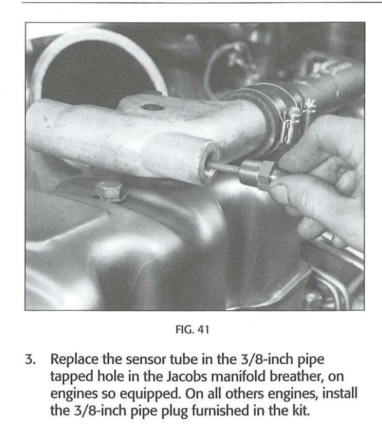

  On 11/13/2024 at 5:34 PM, BOBWhite said:
More stuff I found about the mystery tube:
On pages 17/18 it shows this threaded hole
Sorry I hope I didn't highjack your thread too much! What were we talking about again? Something about a boost gauge? lol
Expand

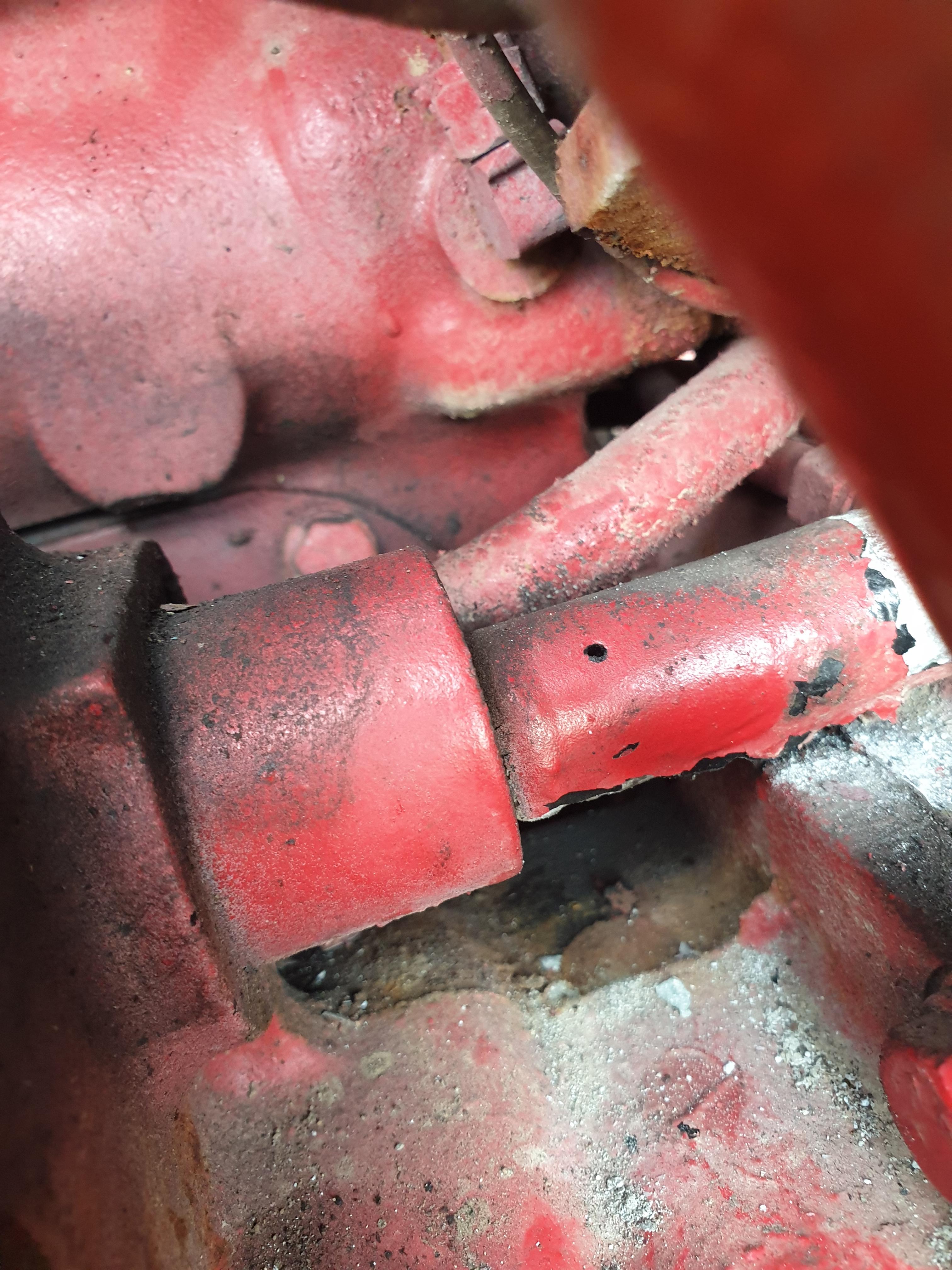

Interesting pic Paul.The Puff Limiter on our EM6 is leaking air from a small hole on the cylinder thats screwed into the injector pump.see photo.We're told this cylinder cant be overhauled.We blocked off the air line from the valve on the inlet manifold to stop the leak....
Paul

Do you know where those air lines from the puff limiter go?

There is no overhauling that it was sold as a unit! Un screw it ! Youll see how it is! Hint a a 9/16 fine bolt will fit the hole ! if the rod is protruding with no air to it it will not let the engine have full fuel!   Just sayin!
Expand
Thats interesting.if we put a bolt in to restrict the rack movement how will it affect the trucks performance?..and cold starting?thanks for the hint.
Paul
Expand
Sorry, I thought I explained that
The one with the badly drawn red circle goes to the little air ram on the injector pump that limits travel until you get boost or are out of reverse and 1st gear
The green line goes to the fear box, reverse and 1st gear doohickie
The uncircled line is the air supply to the puff limiter doohickie
To be honest I only looked at these for a few minutes and relied on my memory
Paul

The bolt must not be thread in all the way no deeper that the cylinder it’s self! Also I maybe wrong on the thread it may be coarse thread! Been a long time since I had to mess with one of these! We used to put a 9/16 flat washer behind the cylinder to speed up take off ! It would make the cylinder retract faster than the rack !
Expand
Isn't that what you're supposed to adjust with shims ?  I think I remember a diaphram being in that cylinder too.  I'd be real surprised if any of that stuff is still available .
Expand
Yup the extension dimension is stamped on the pump at the top! Hence the washer behind the cylinder!
Expand
So far it isnt...we cant find one anywhere.we are interested in trying fjh's idea see how that goes....
Paul
Paul
Expand
So remove the bimbo cylinder and inspect it if it is not protruding ! Put it back in and cap the line to it! There appears to be no shims behind that from what I can see! Put a thin washer behind the cylinder and put it back in with some silicone or pipe sealer on the treads!
