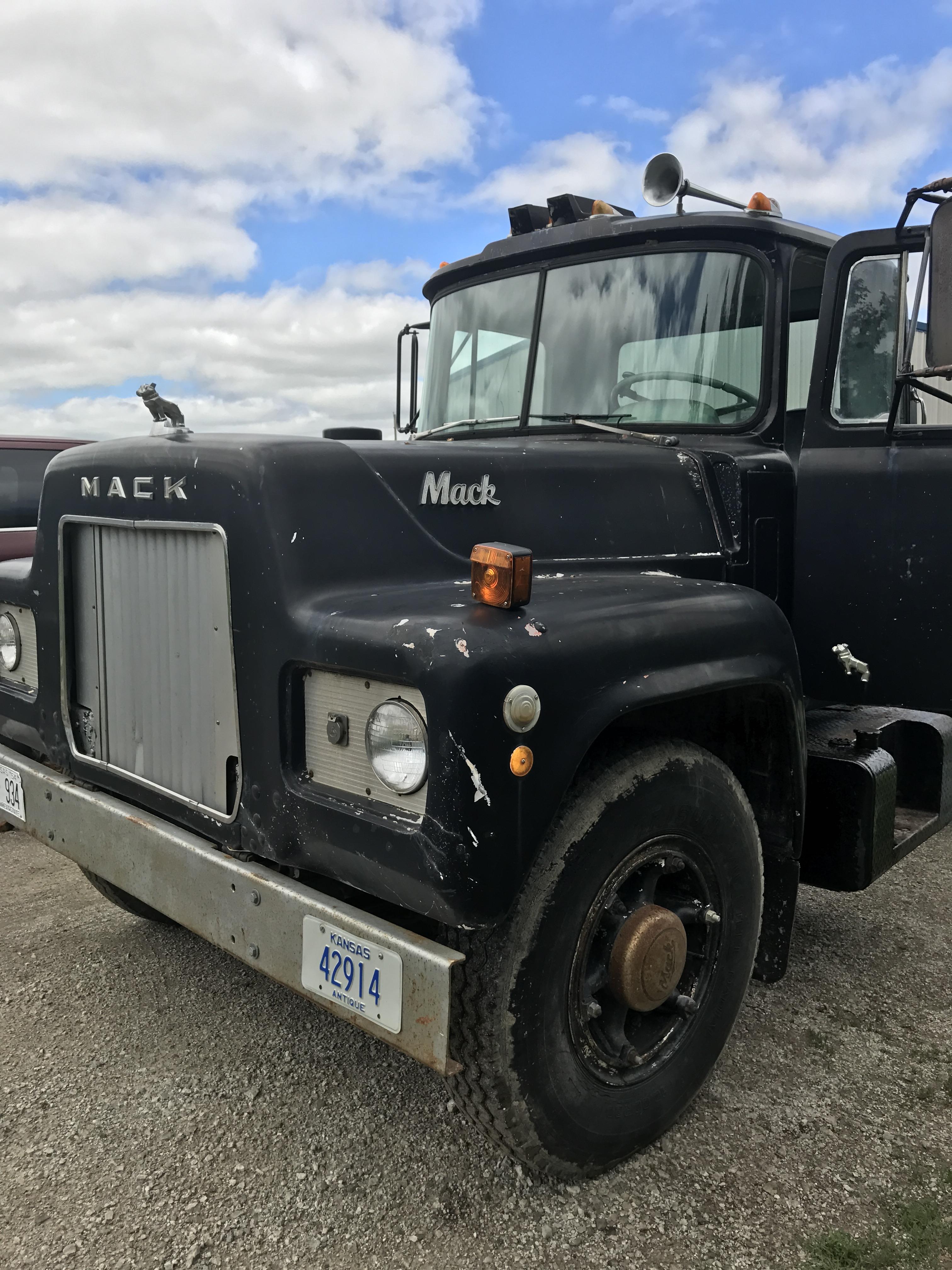

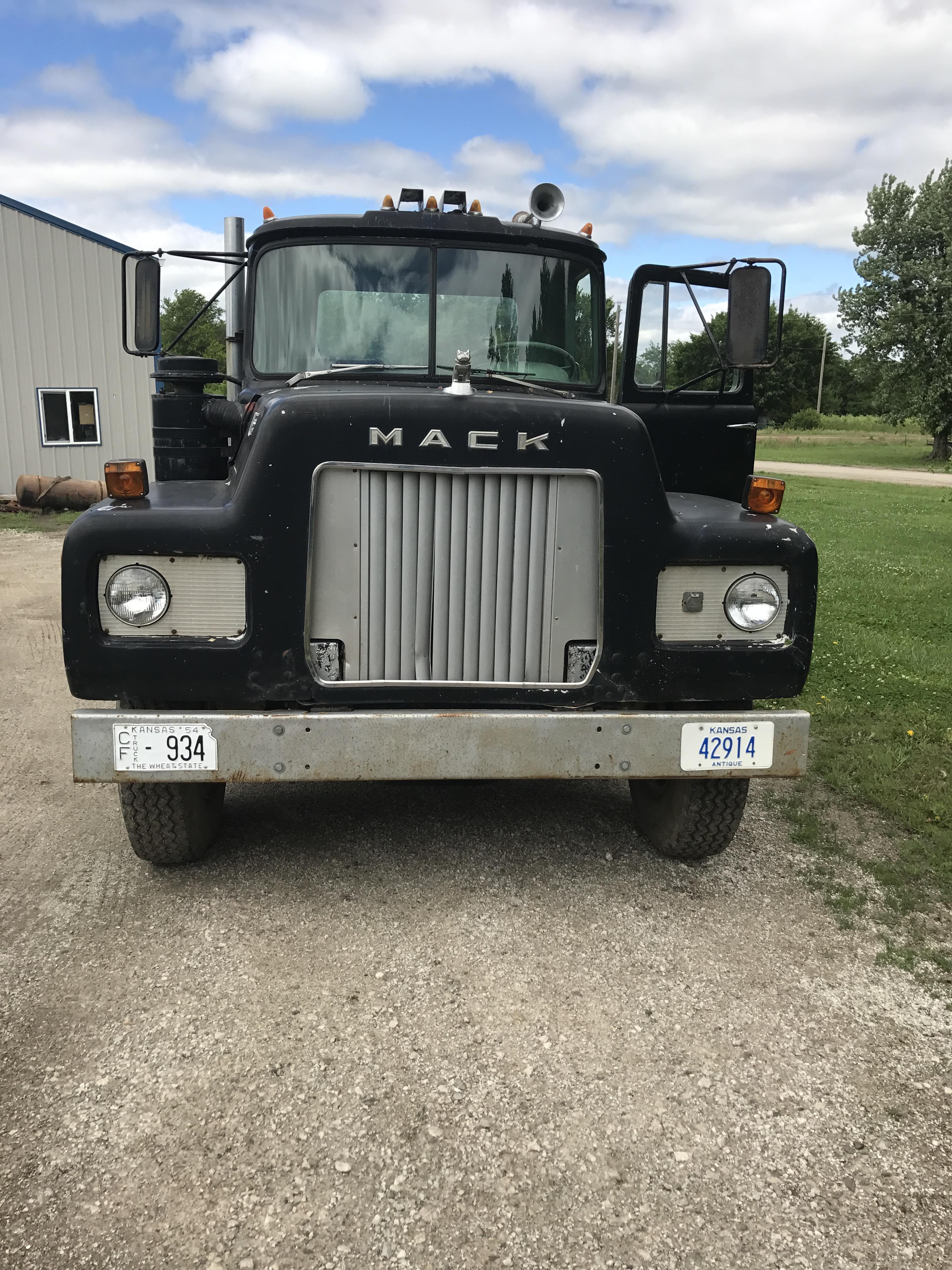

So I have an old Mack truck. The title was lost and the previous owner had it titled as a 54. But it has a R600 body. It also has all original interior and engine/transmission (2 stick). I have looked for the serial number on the engine but can’t find it. Can anyone tell me where to find it and what year they think the old Mack is? And how much it is worth. IMG_0322.thumb.jpeg.abe3492ad0c1d5190f606b16c9661fef.jpegIMG_0321.thumb.jpeg.c36850312422f6e8d18096ba5654a1dd.jpeg
It should be stamped back of the engine right behind the rear  head good luck … quick guessing value is 8 to 10,000 depending on condition of everything cab  looks real good according to the photo it was probably a kit they were putting together in the middle 60s. I’m sure more guys will chime in
I believe they call them. BCR’s quite common back then…. bob

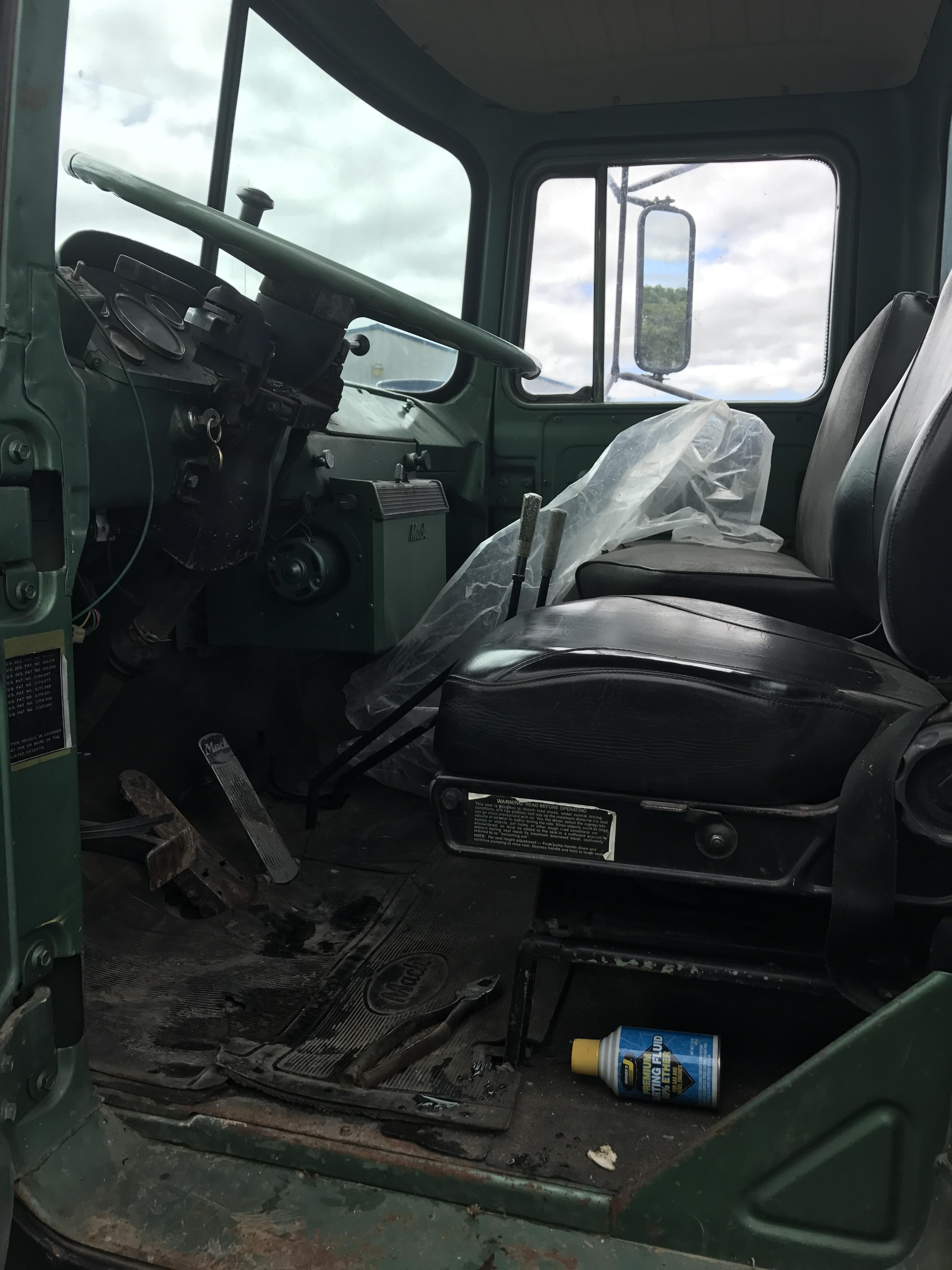

are you actually looking for the trucks V.I.N.  ?  i dont like the can of ether..  thats a bad sign..  how about some pics of the engine, which is probably an E-6..  on the frame behind the right steer tire is the trucks V.I.N. also on that triangular part of the door frame in the picture.
Joey Mack- the ether was never used on the old Mack. We have an old Allis tractor and have had to use it on tractor.

another possibility in conversation it may be a '64 not '54. was involved in two B C R conversions ; this could be a BCR. which for info stands for B model converted to R model. does have the B model radiator -looking at the two front side spacers used in very early R's  still having B model components. much like a '66 DM being restored. on BMT.😇
study the pictures show a lot of B model; or confusing could be a very early R. front axle hub caps/ early style R heavy one piece hood and the Mack name front and sides. can't judge by the interior== a BCR comes completely groomed (if ordered as such).

Yeah, I noticed the outer panels were definitely BCR. I’m sure this guy is gonna get an earful , but I’m sure that’s what he’s looking for. Happy Easter. Mecho… bob
would not  go with definitely a BCR;; your DM also has radiator side panels if I recall correctly. also number one R model ==R607T- 1001 has the side panels since that is one very early R having many B model parts. HAPPY EASTER  to You also Sir.

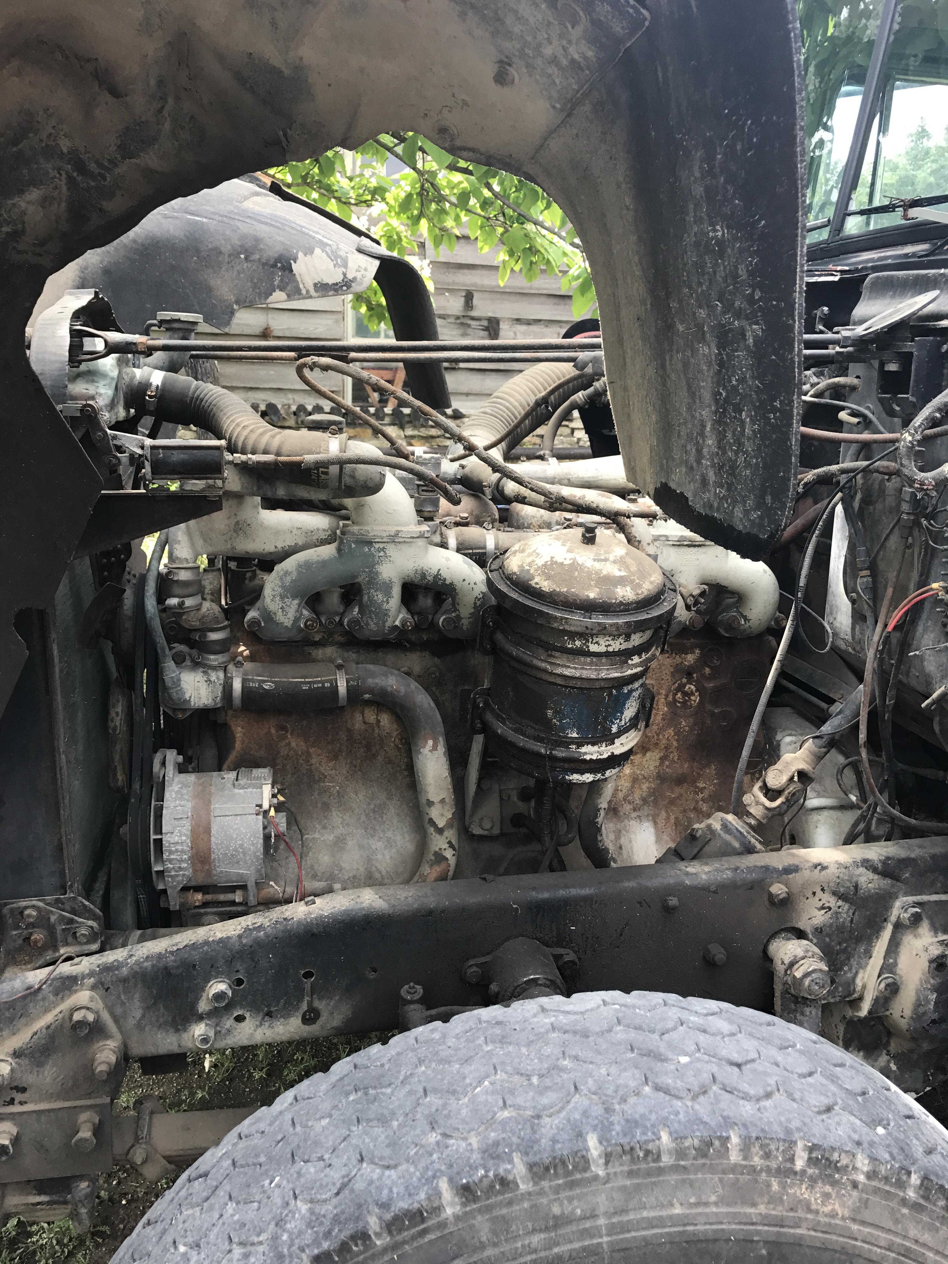

Thanks for the information everyone. The neighbor borrowed it to haul some big rounds home so I haven’t got a chance to look at the engine block yet for numbers but I will as soon as he brings it back. Here is a picture of drivers side of engine  this was when we first went and got it  the other side has the Mack logo on the engine  it needed new batteries but fired right up  IMG_0320.thumb.jpeg.2c550e28dac85ff2a10a65d827193cf3.jpegIMG_0316.thumb.jpeg.2934669cce0613f759573997d2652dc4.jpeg
these latest pictures favor more the B C R idea. 1- those radiator front side panels look to be VERY EARLY change over or homemade. solid metal work not factory metal with imitation grooves pressed in. 2- other then someone installed an alternator, engine goes to the "B" model family. early intake manifold/ much older oil filter.3- radiator smaller B style having framework around it going to fire wall. 4- older style shutter stat. 5- oil fill on front valve cover; not side of block,6- non turbo? . 7- radiator fill =older version. 7- starter might be on passenger side; can't see in picture. still a real nice unit.

Thanks mechohaulic! Yes it does not have a turbo. Still waiting for the neighbor to bring her back so I can search for the serial /VIN numbers. I will post more engine pics when he returns the old girl.
I guess that was what I was trying to say the BCR has its own panels different than mine… bob
