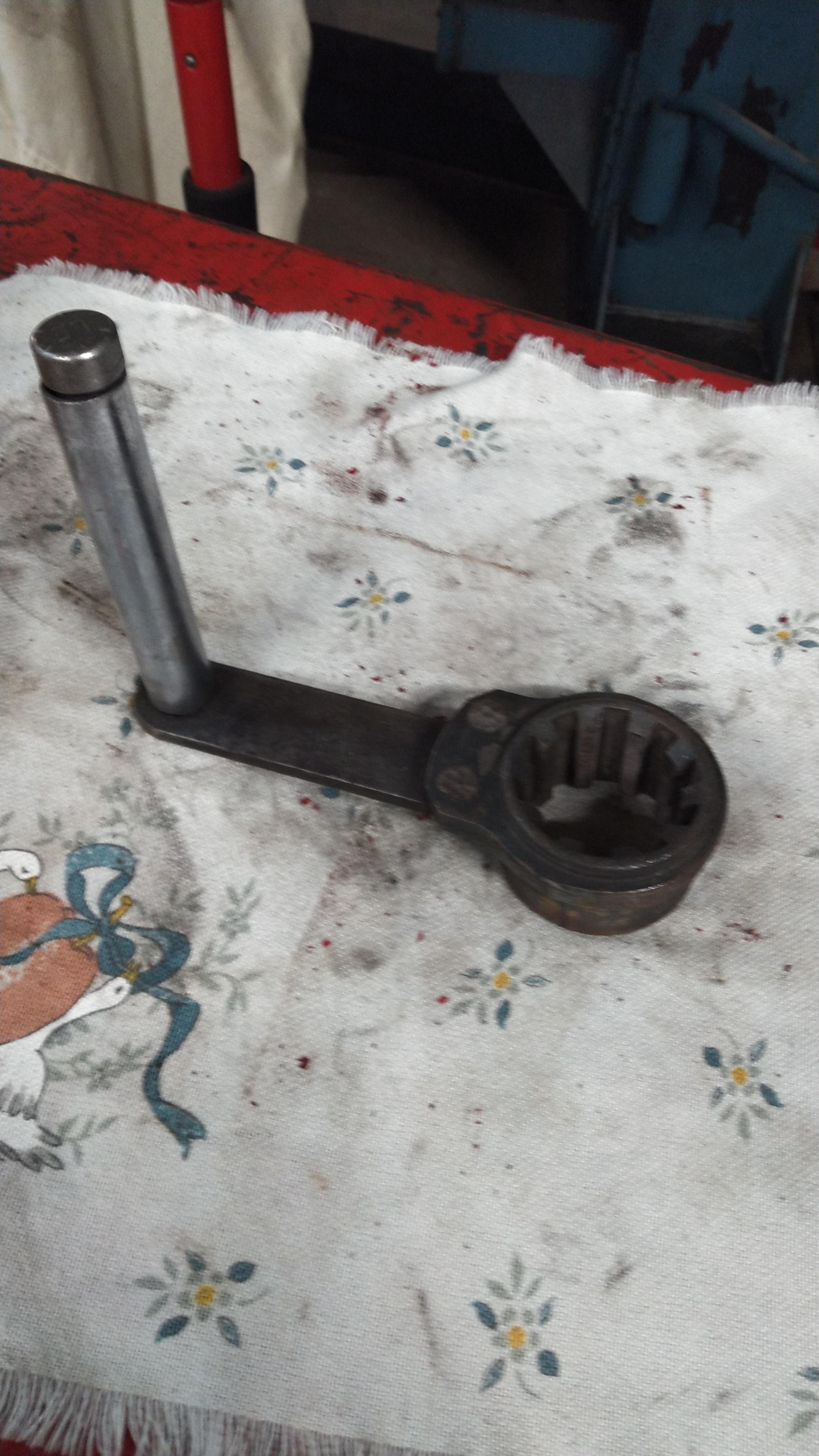

the transmission was re-built..  When I used to rebuild transmissions, I stripped them clean..  when the transmission was done I would hook air to it and bench test it for shiftability including range shifting.  I would put the stick on it and hook shop air to the shift cover, run all lines correctly and use my home made crank to operate the transmission and all its gears and ranges.  then I would set the PTO'(s) and be done..
