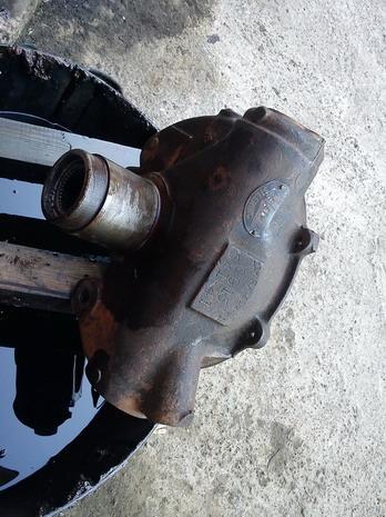

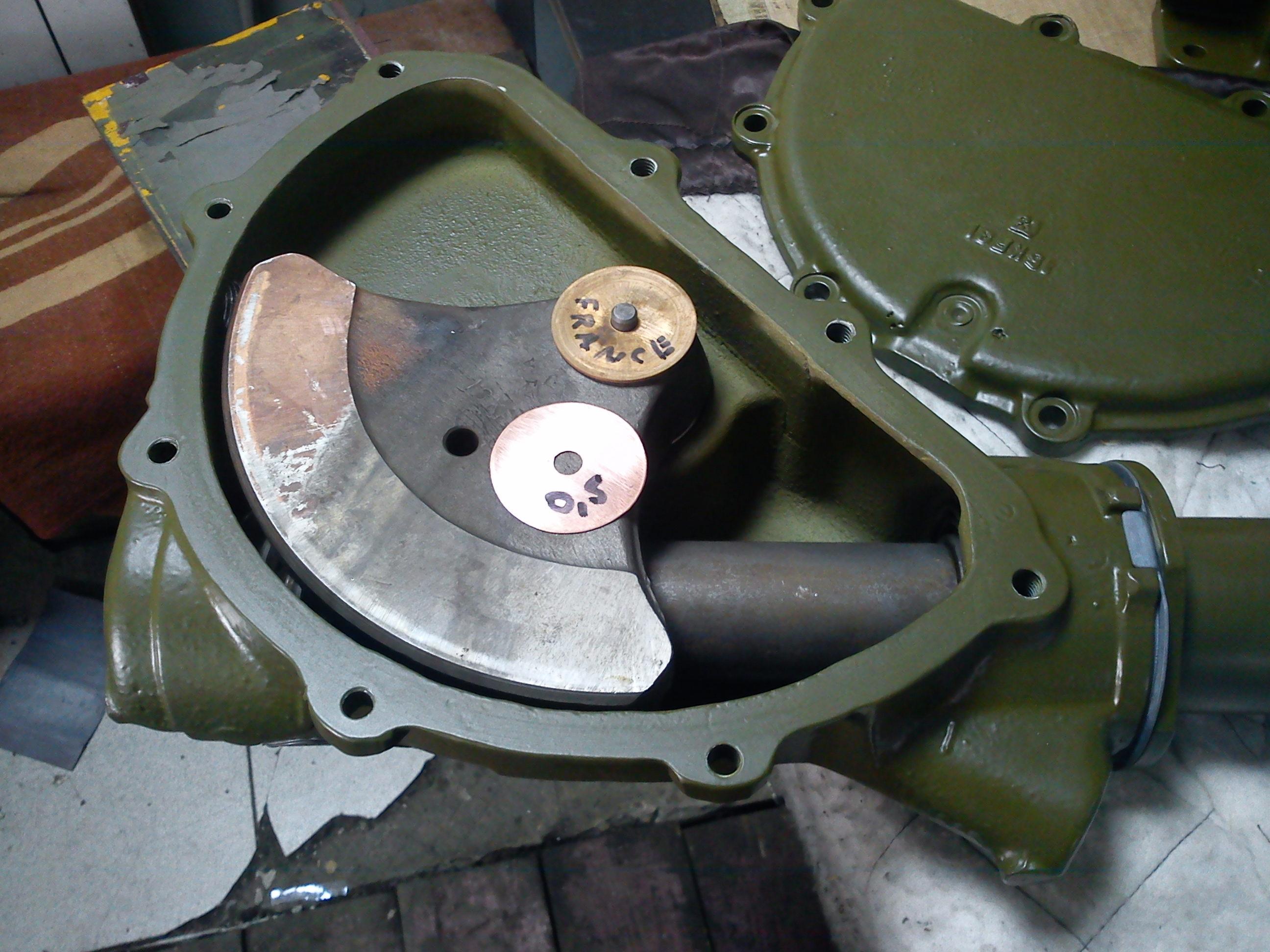

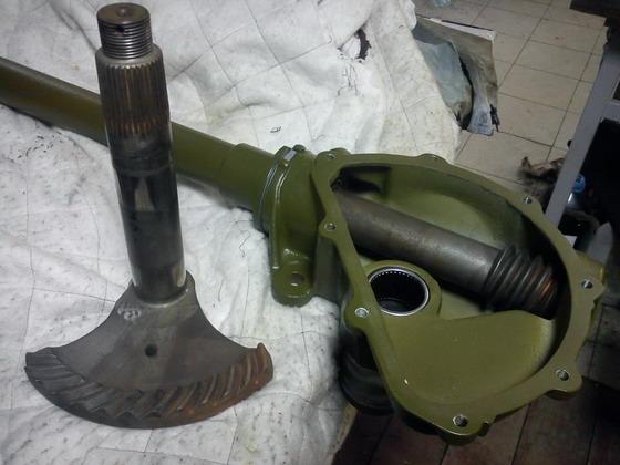

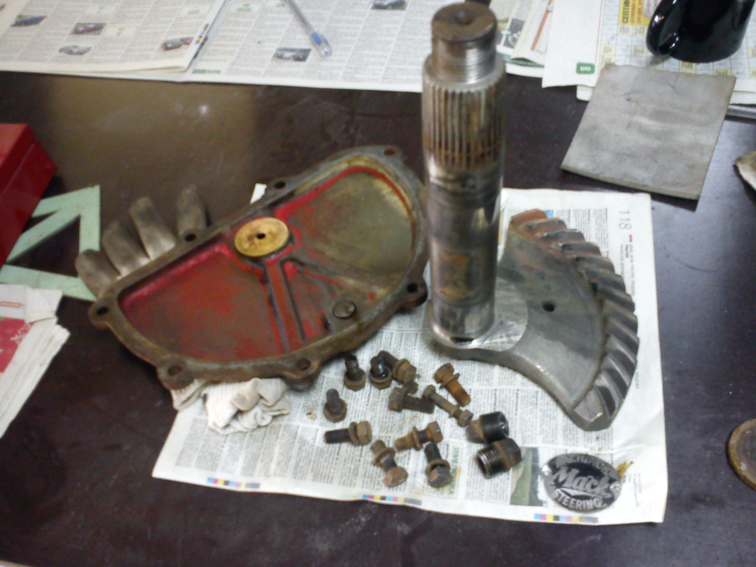

Here's a bit of what to look at. The unit is SG-16 made by Mack in 1945. Earlier than yours but from your description I guess very similar. Steering shaft put into a long tube you see in the cab which is attached to the top of the housing under the hood. No U-joints. I indeed had to remove the steering wheel when dismantled the unit off the chassis and that was a trouble with splines stuck to the shaft. Having no luck with simple movements I tried attaching a puller but ended up with a chiesel hitting from below the steering wheel and cracking its lower skird. Found no other way. But looks like you may try removing all the column off the housing together with the steering wheel. My style had the column driven into the housing with threads. Bend off the lip of the lock washer and turn the column (the tube) counterclockwise.
The gear itself is a simple warm and sector. My model had the Pitman arm shaft spinning in two needle bearings not cooper bushings. Originally the gear showed excessive play either so I went through it and finding play of the shaft and seeing no wear on its journals I started a hunt on the bearings. Those were marked Torrington-something and after stiring a pot at my local parts supplier I in a month and a half purchased... one bearing. And after telling them "Yes, that's true, I asked for two" and two more months to wait (and paying double shipping cost) I grabbed the 2nd one. To my big frustration after reinstalling both bearings the play rest as it was with the old ones. So it looked like Mack minded that way from the factory (and I didn't liked it).
The warm and sector teeth didn't have any notable wear either so my further look put on the bronze bushing the sector seats against and limits its end play. I made additional shim and if assembled with it the shaft had no radial play and all the gear lost 95% of its play too. I was pleased but not cheered since if the shaft had no tight vertical support in the bearings it would lean (dance) under steering force trying to brake the cover or so. And the thickness of the gasket was a mistery to me too since it influences the required bushing thickness.
That time I ended up with the original bushing and no gasket (put sealer) and some notable steering wheel play of a couple of inches I would like to minimize for perfection. But I never drove multiple old trucks down the road so kept it about the way Mack made it. Much later a large factory repair manual happened to appear in my hands and Mack engeneers were offering to set the shaft end play by thickness of the gasket (!). That was written there with a comment of no shims of other than standard thickness were avalible.
The truck is still in the shed having no engine and cab on so no comments on driving experience from my side. Hope the pics will help you.
P.S. As I remember the warm could be removed from the steering shaft in a case you find it bad and no need to remove the steering wheel for that. Also look up for the electrical horn wire as it goes through the steering shaft getting out of the gear at its bottom end.
Thanks for the pictures. That's a big help to know what's inside. The last time I remember opening up a steering box years ago there were many  ball bearings that went everywhere. That was on a antique car. I have had the steering wheel off a few years ago so hopefully that won't be too bad but as I remember it is not drilled for a puller. Hopefully I can get the box out in the next few days then see what I run into.
Yes, there's a style of steering boxes with circulating balls. That's good design regarding the function. As I understood it came on the big truck scene a bit later, after those simple warm and sector boxes. The steering box is of screw, nut and sector style. You spin a screw by steering shaft which drives or undrives in/out of a nut. The nut is also a rack having teeth on one outer side. The teeth are mashed to a teethed sector which turns Pitman arm shaft. The balls are put in the threads between the screw and the nut. So the threads operate as a ball bearing. If the box is an integrated power steering the nut also takes function of a piston having seal rings over its body and moving in a cylindrical cavit bored in the housing.
That style usually has a set screw but you can adjust mesh between teeth of the nut and sector only. And if you ran all that adjustment to its limit and still have play in the box that means the balls or their racing surfaces are worn and a fix is replacement of the parts or complete steering box.
