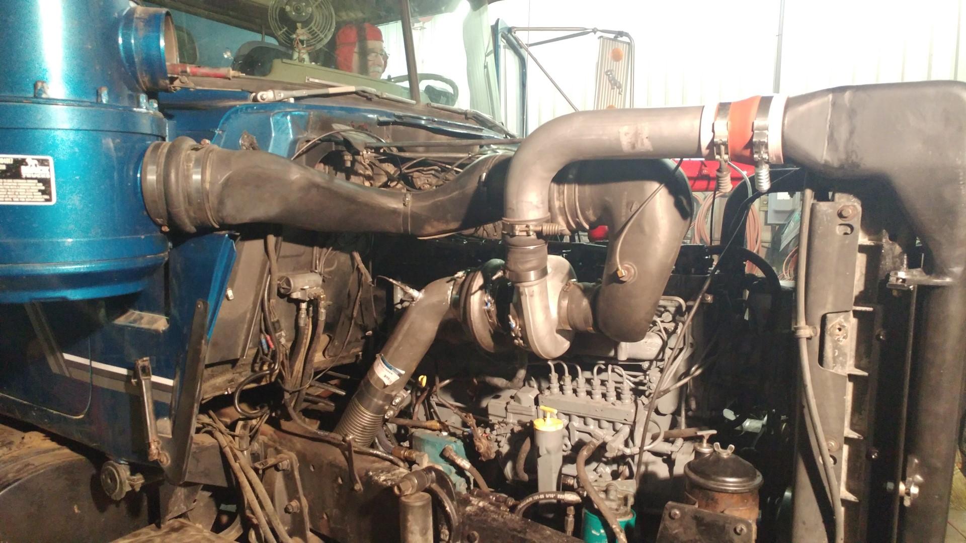

We put on a new turbo on because they other donor turbo was using v-band clamps and we were having trouble finding a connector on the intake turbo side to go to 3.5 inch "barb".  So just decided to update with a new one. It is a Borg Warner and the old one was a Garrett and new turbo is bigger in size than the old one.  Inlet still is 3" but meant for 3.5 inch barb hose to attach.  The Garret had a 3 inch v-band type connection system.

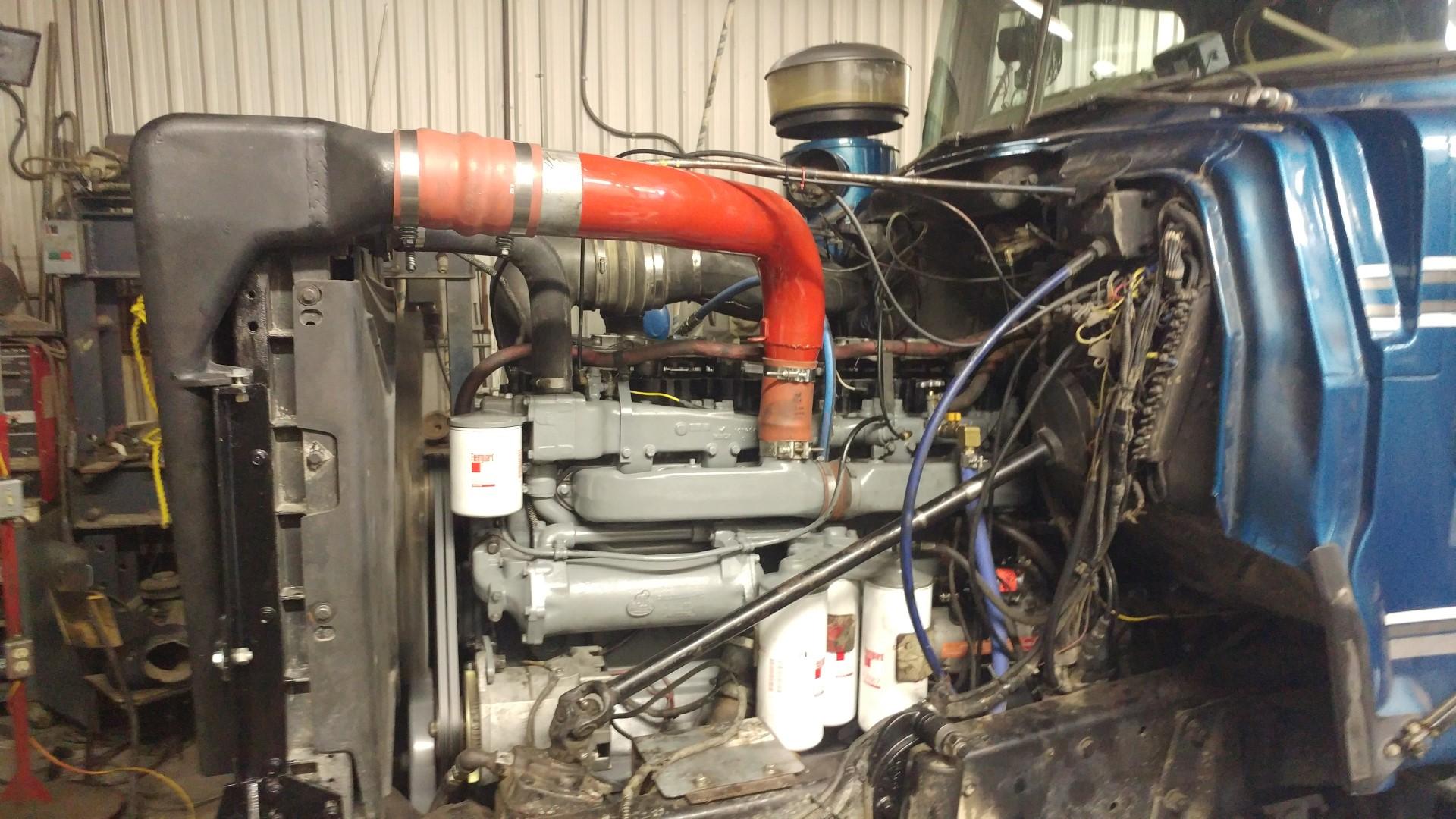

We found an air to air (new) and had the horns turned out like Josh had done by a machine shop.   We found some piping from NW Trucking in Edmonton and so that was a relief.  A driver's side pipe and used intake manifold!  We also  found a jake brake for it (new and made by etech!) from another supplier.  It was old stock!   The jake is working nicely when I manually engage it at the tappet top when I purged air out.  The kit came with a clutch pedal switch and a normal switch for the back of the Robert Bosch pump.   It has a diode in it and I really don't know why that switch has that in it?   I assume our truck is a negative ground setup and not a positive ground setup which apparently requires reversing the diode on the switch if it does.  Taking the foot off the gas didn't engage the jake with the 2 cylinder switches turned on so I have to figure out the electric issues there.  Maybe my switch at the pump isn't contacting?  I didn't bother with hooking up the clutch pedal switch as we never had it there with the Dynatard system in the old engine and I don't think it is necessary or important.    It looked like the wiring harness was intact and in order to install you would have to cut the wire in the harness and put the clutch switch into the system.   I think it is unnecessary?  The low idle needs to be set up and it looks like the max RPM against the pin is 1550.  So I am hoping we can adjust that up to 1800 by turning the screw to allow the lever to go forward a little more.
