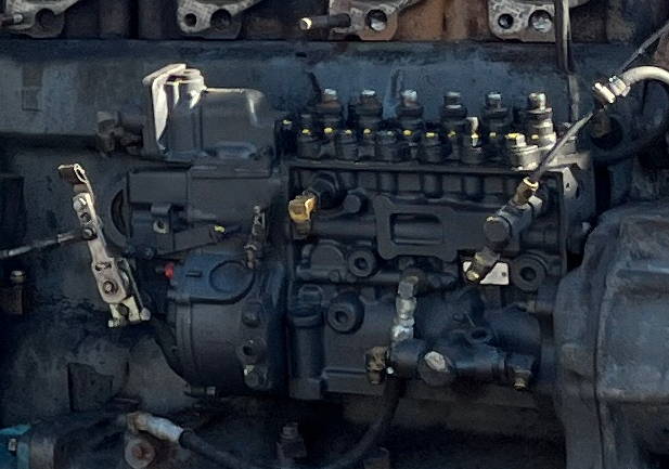

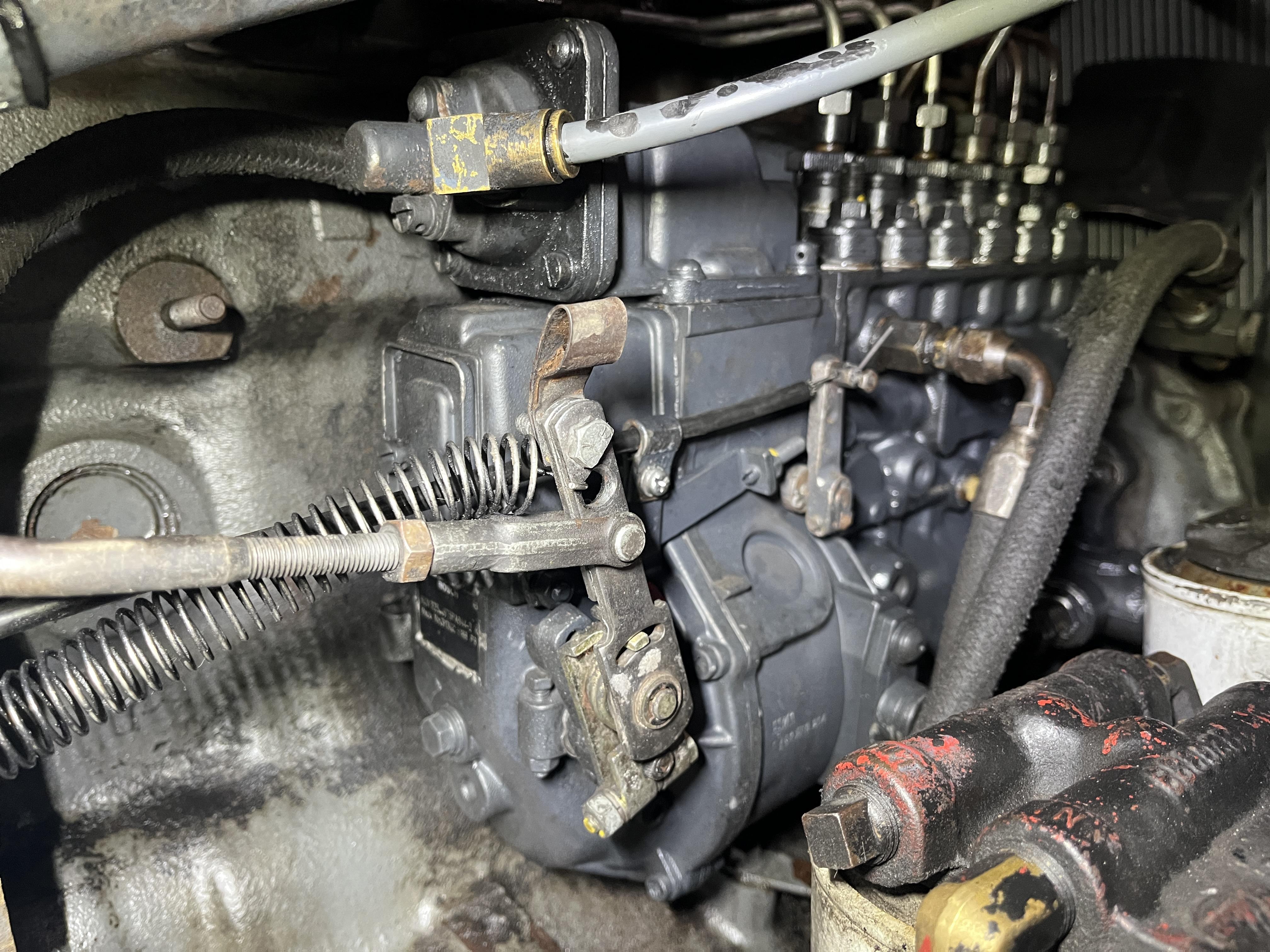

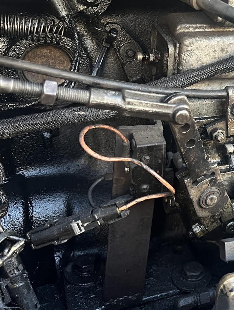

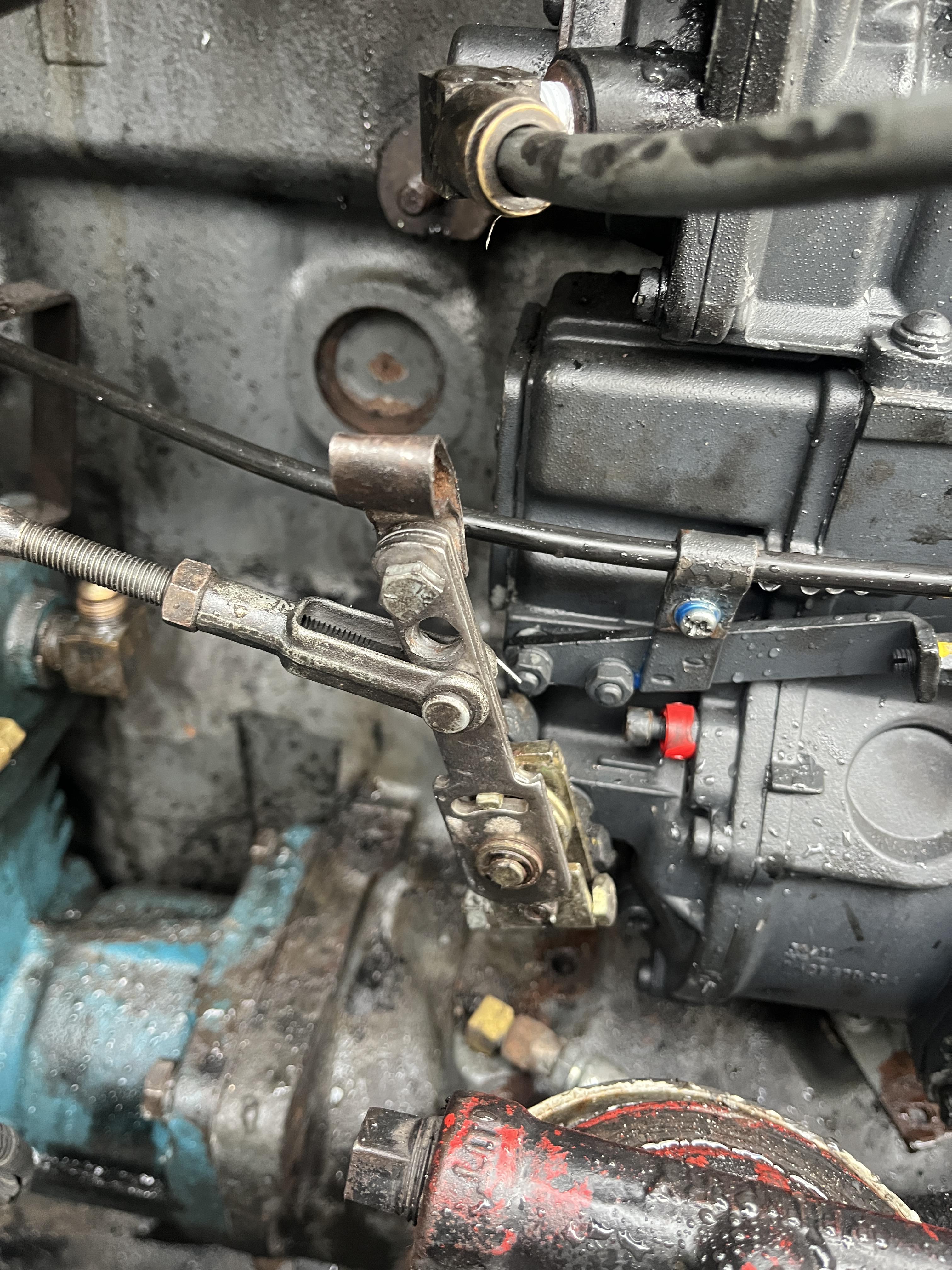

I noticed this solenoid looking thing from a picture I have on the back of the old injection pump on the old engine. Issue is I already sent that engine back so don’t have a clue where it goes/what it does.
Would this affect the pump or timing at all?
There is no timing advance on what you have how ever you can check and set the timing!   Just wondering is the engine equipped with dyna tard?  hard to see there! If so pull the engine brake relay or disconect at the head and see if this changes your issue! I see two pictures here one with a jake switch replacing the original pump cover swiTch ! Is the clean one the engine you are using now???  I think you have a dynatard switching issue here! It will make the engine brake apply in a light load application if left on and not set correctly ! ! Disconnect at the head to be sure! a rubbed wire to ground will set the thing off!  If the stumble goes away you have your culprit!   NOTE If your using the built in switch on the pump theres a specific way to set its a bit tough to explain but will try  if you confirm what your up too there!
