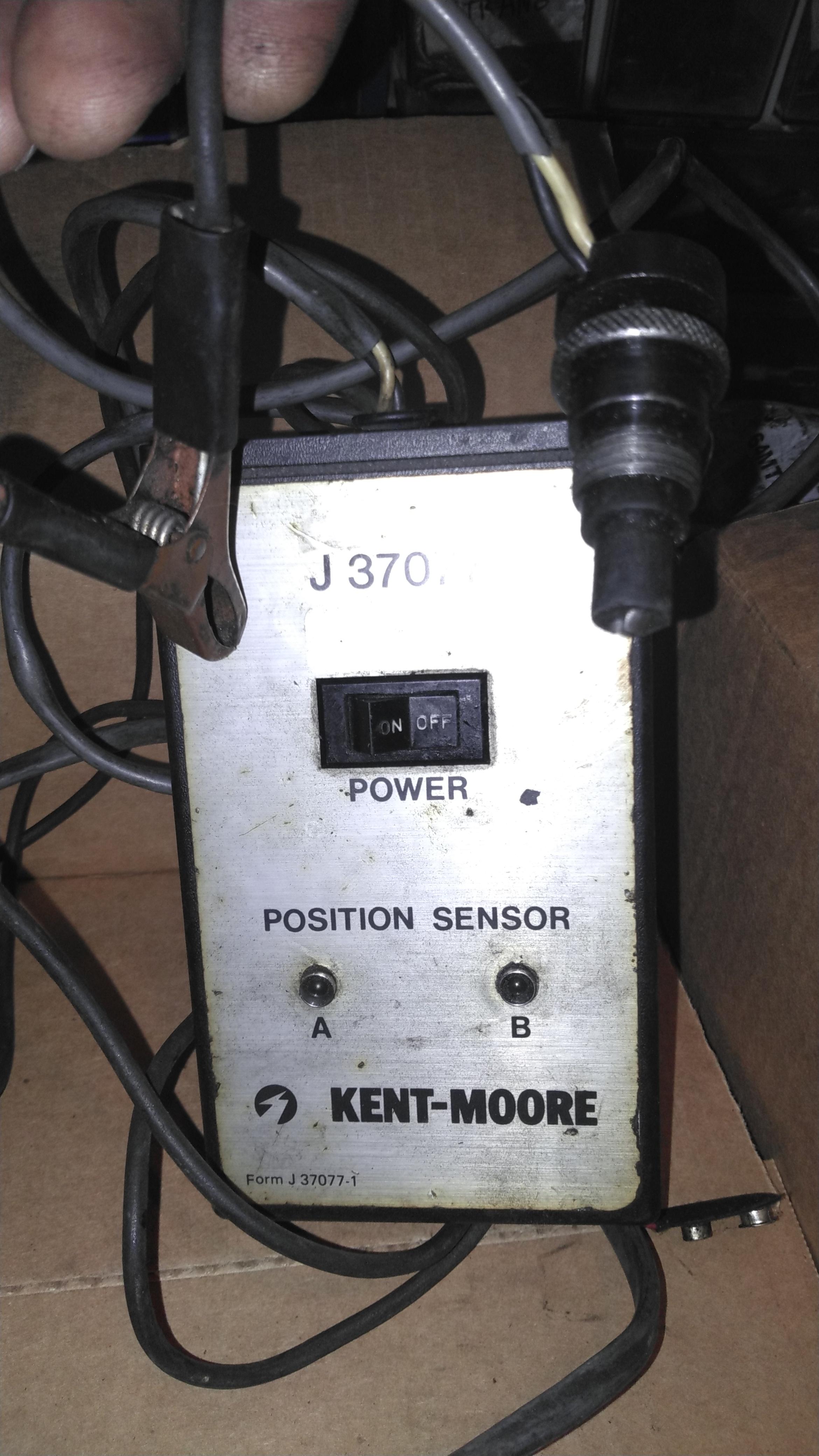

I did some research and believe the injection timing on the engine is too retarded as I have all the symptoms of that. Is there any way to advance the timing a degree or two without the Kent-Moore timing light tool?
I have only ever used the kent-moore tool..  however, i was told that you can look inside the hole and line the marks up and it will be timed..  Maybe someone will add to what I wrote..  I personally am not comfortable doing that.  I happen to own a timing tool, and know how to use it..  Jojo   RobertBoschtimingtool.thumb.JPG.274d8983e5ddcf7d0489cb000635f20b.JPG

Yes! this here is a get by ! if you don't got the tool Joey has there!  Remove the plug in front of the throttle and below the stop  that's where the timing tool fits turn the engine to where its to be timed to example 17 or 19 there should be what looks like a flat blade screw driver DEAD CENTER in that hole! If its not there or not centered is  either on number six or its out of time! Set it  so the spade is centered in the hole remove the front cover and loosen the 4 bolts on the slotted gear  turn the engine to on mark you want to time it to confirm the slot has not moved after you move  the engine on its timing mark tighten the bolts and try it see if you have achieved your goal engine timing is usually marked on the valve cover and the marks are on the flywheel center bottom! and note if you have a 5.9 Cummins with this pump on it the set is very similar. Also note that We have run into a situation where by the spade has slipped on the pump cam ! this becomes a little bit of a pain but can be over come by a different method so for now go with the spade in the hole method! and advance the timing two or three degrees at a time! A bit time consuming But doable!
