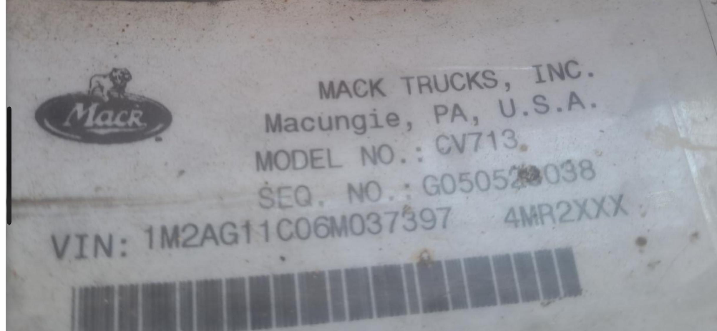

Had a phone call with a strange request
A new in the U.S of A Mack now living in this wide brown land
Off this information can anyone provide any details
Apparently it's a 2005 6x6, that's all I know
Oh and these numbers are no good in Australia so do they mean anything to Americans ??
Paul
Other than its a tandem axle Granite (CV713) not too much I think. One would have to give the last 6 of the VIN to the dealer would think and they could tell you what is in it. Most (maybe all) Granites came with the AI version of the ASET engine. Maybe you could get the AC version in a Granite I really don't know. Quickest way to tell is by the turbo. If it has a variable geometry actuator hanging off the side then its an AC. If it looks like a normal old turbo then its an AI.  Mack axles and transmissions are pretty easy to identify by eyesight.
Is there a tag on the front valve cover? Did you look for the transmission numbers behind the fill plug, also the numbers on the rears on the smooth part of the front of the carrier housing?  Assuming it has Mack rears..
