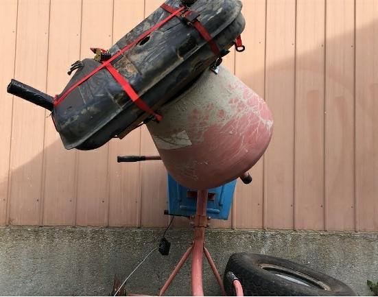

I use small to medium sized rocks from my driveway and shake it dry for awhile, then I use simple green or water to wash out what's left. Never had to do this on something bigger than a 15 gallon tank before though.
I've had success with fuel tank sealing products before but I don't recall exactly what I used. I know it was the kind that you poured in then shook it around to coat the tank. I highly recommend using a fuel bowl if you're going to be using any old tank, especially if you've put rocks or bolts in there. There simple and cheep plus you can visually check for dirt and water. Best of luck!
