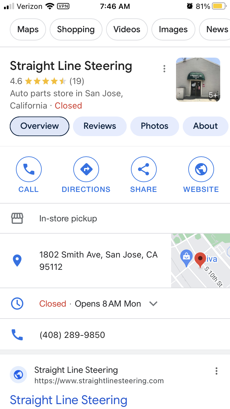

 If you don't want to do it, I would recommend Straight Line Steering in bay area Calif. Give them a call and see what they would charge to go through it. Hardest part is getting the pitman arm off, There are 3 methods that the secure them, again covered in the manual.

Thanks again for all your help I have 3 big manuals a buddy of mine just had one rebuilt probably mentioned somewhere in San Jose. It might be the same place. He said it was relatively cheap. It was only around 250 but he has a 20002 F 600 Ford dump truck
No problem, I can understand not wanting to do it yourself. I did and have the bad back, aches and pains to prove it. Yea, sounds like the same place. They are known, I haven't used them (being in the mid-west) but know people that swear by them.

It was the last time I needed them. They were in use at least through the end of the 80's. It is the two digit boxes that parts are no longer available. If in doubt call Straight Line and ask if they will have a problem.
OK thanks bud. I appreciate the information. I will call them before I do anything.  I’m thinking I might have better luck with them. Then Reno route builder. I don’t know. I would rather not send it off if I don’t have to. Thanks again.
