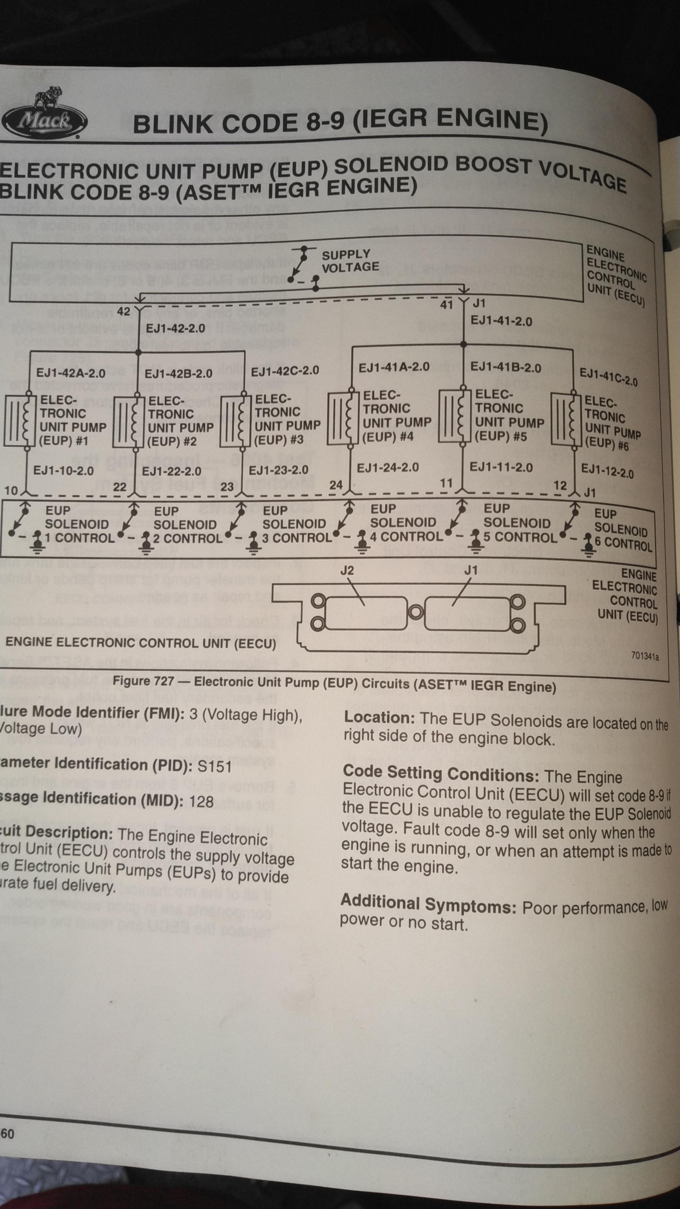

The pumps operate on 2 banks,
1-2-3 (bank one) and 4-5-6 (bank 2).
If my memory serves me right, I believe the engine ecu supplies a ground to switch the pump on and off. If you short out an injector all the supply voltage will drain to ground on that bank, and it will kill the engine. I might be wrong.
V
I did swap out the 5 and 6 injector, problem stayed with cylinder 6, I'll clean up the pins on the ecu and connector, is there a best way to do that? Electrical contact cleaner?
Thank you for the help, that page out of the manual is helpful.
