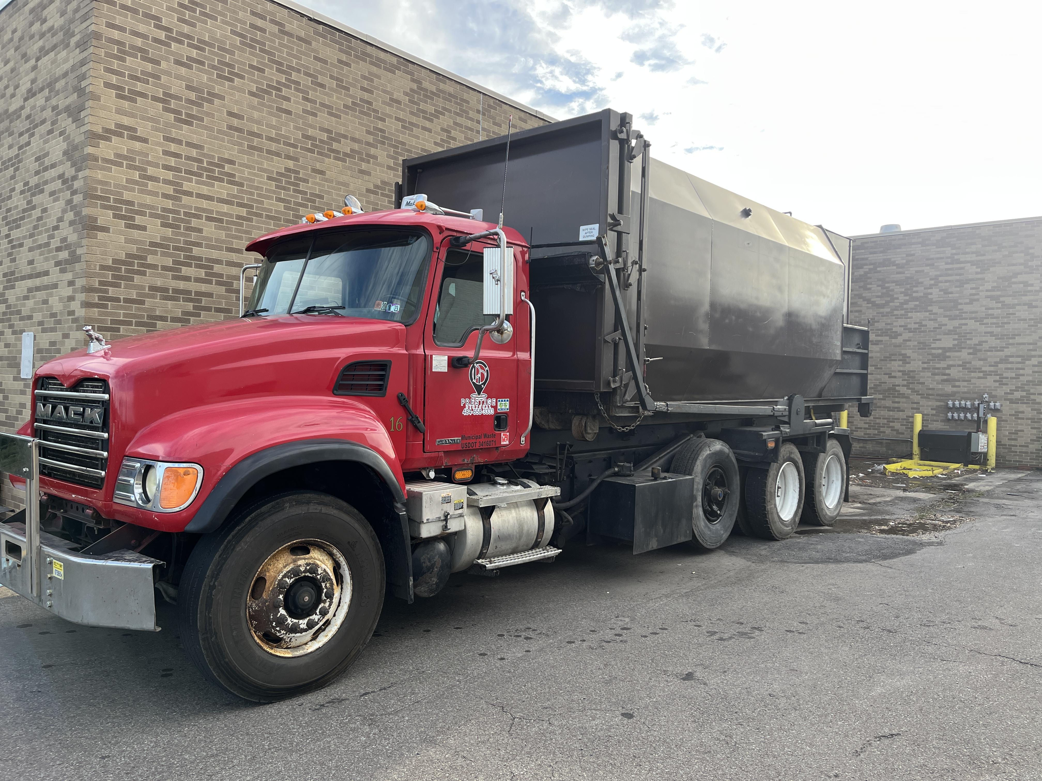

Hi everyone,
I have a CV713 Mack that originally came with an E7 ETECH engine. Along the way, the whole engine was changed out with a Frankenstein parts bin engine before I bought it. The long and short of it is, the ECM on this engine fried out completely, and no data on it is recoverable. My Mack dealer is unable to help, as they cannot verify exactly what engine was put in the truck as they claim Mack/Volvo now requires both the truck VIN and the engine numbers before they can release a tune.
I spoke with the previous owner, who informed me the ECM that was on the Frankenstein engine is the original ECM that came with the truck, so by all rights we should be able to get it programmed by the dealer with just the VIN, but Mack/Volvo is making that impossible now. The dealer was able to tell me the truck came with an E7 ETECH 400 engine. I am in a bit of bind here, as this truck is completely dead in the water and the dealer is basically telling me to pound sand. Any ideas? I did already purchase a reman ECM that just needs to be tuned, does anybody here offer any type of ECM programming services?
Thank you

Thanks guys, the ECM that originally came in the truck is 12MS523M and I purchased the same model number reman ECM. I’ll go back to the dealer and have them give it another go and press the issue further.
Wish me luck!
Would somebody be able to provide me with a VIN number of a 2003 Mack CV713 with an Etech 400? Dealer is saying if they get a standard Vin number they can most likely get the tune released.
