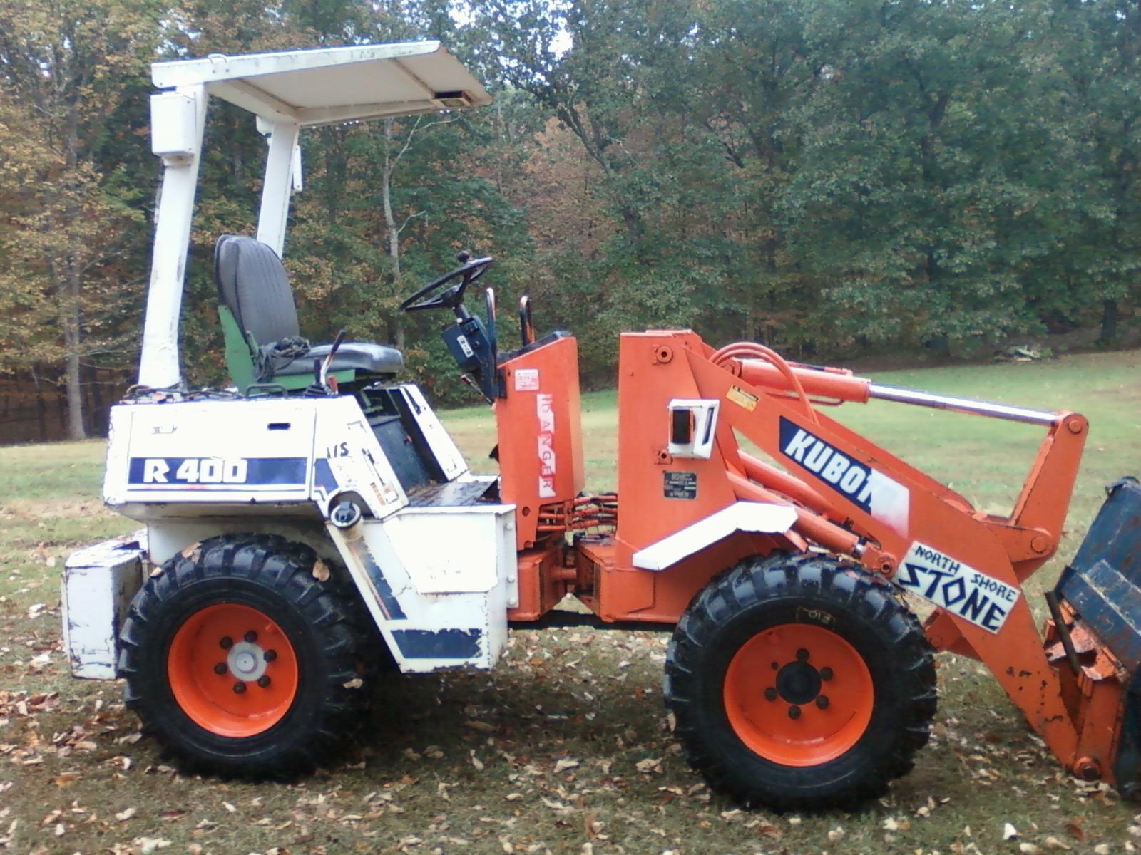

I am in a pinch. My handy dandy Kubota R-400 loader has a bad ring gear in back rear end. Part number for ring gear 68811-2421-0 and Kubota does not show any in America - discontinued part. My next choice is finding a used one BUT it seems these machines are about as hard to find as an honest politician!
Hope my picture is attached. If anybody knows where there is one sitting, please holler!!

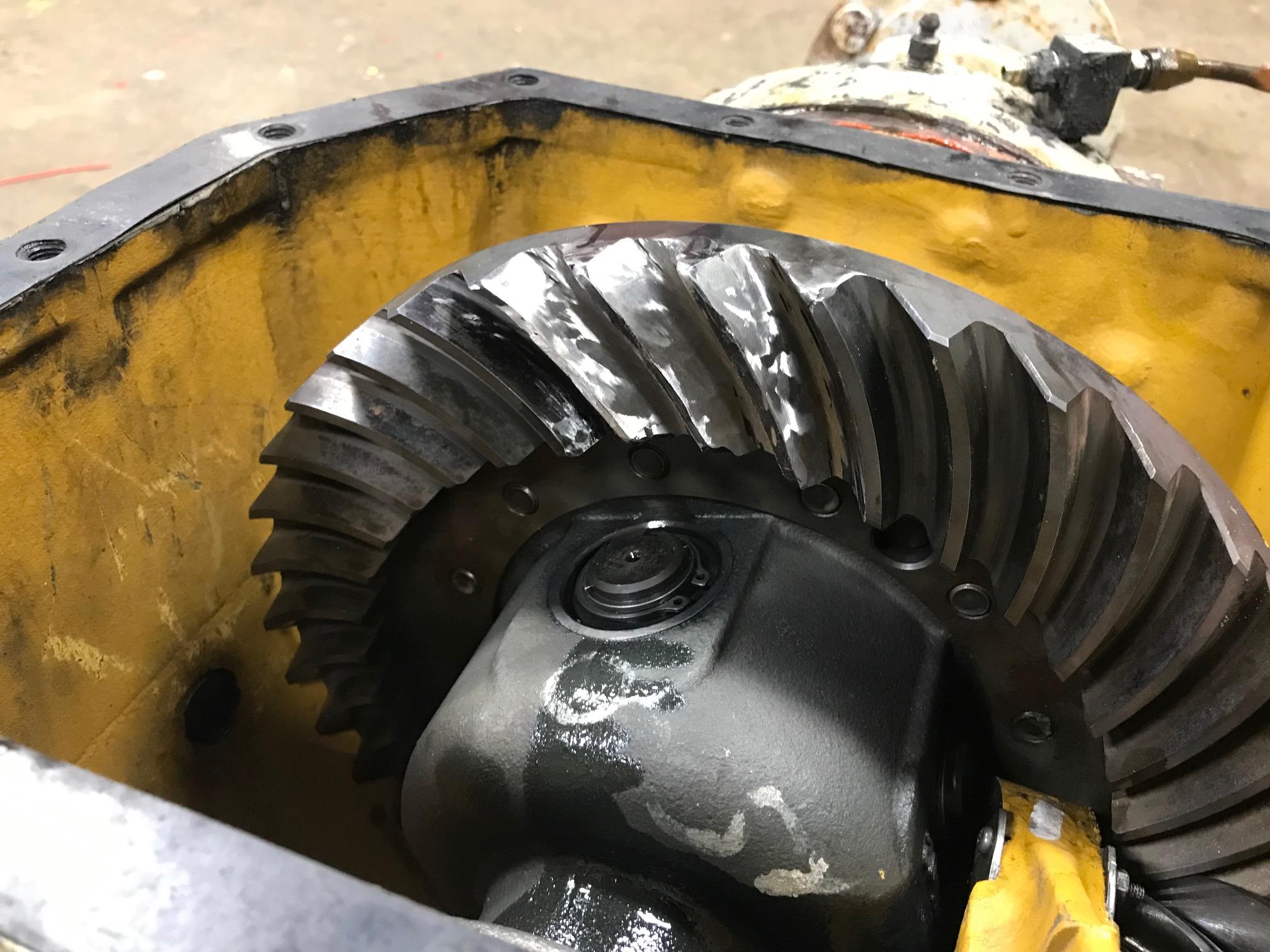

My gear has 3 teeth that have "flaked" out on drive side across the whole length. If I can't locate a used one, then the next choice is to TIG weld these bad places. That opens up a whole new thread of conversation for the next post.
Thanks in advance

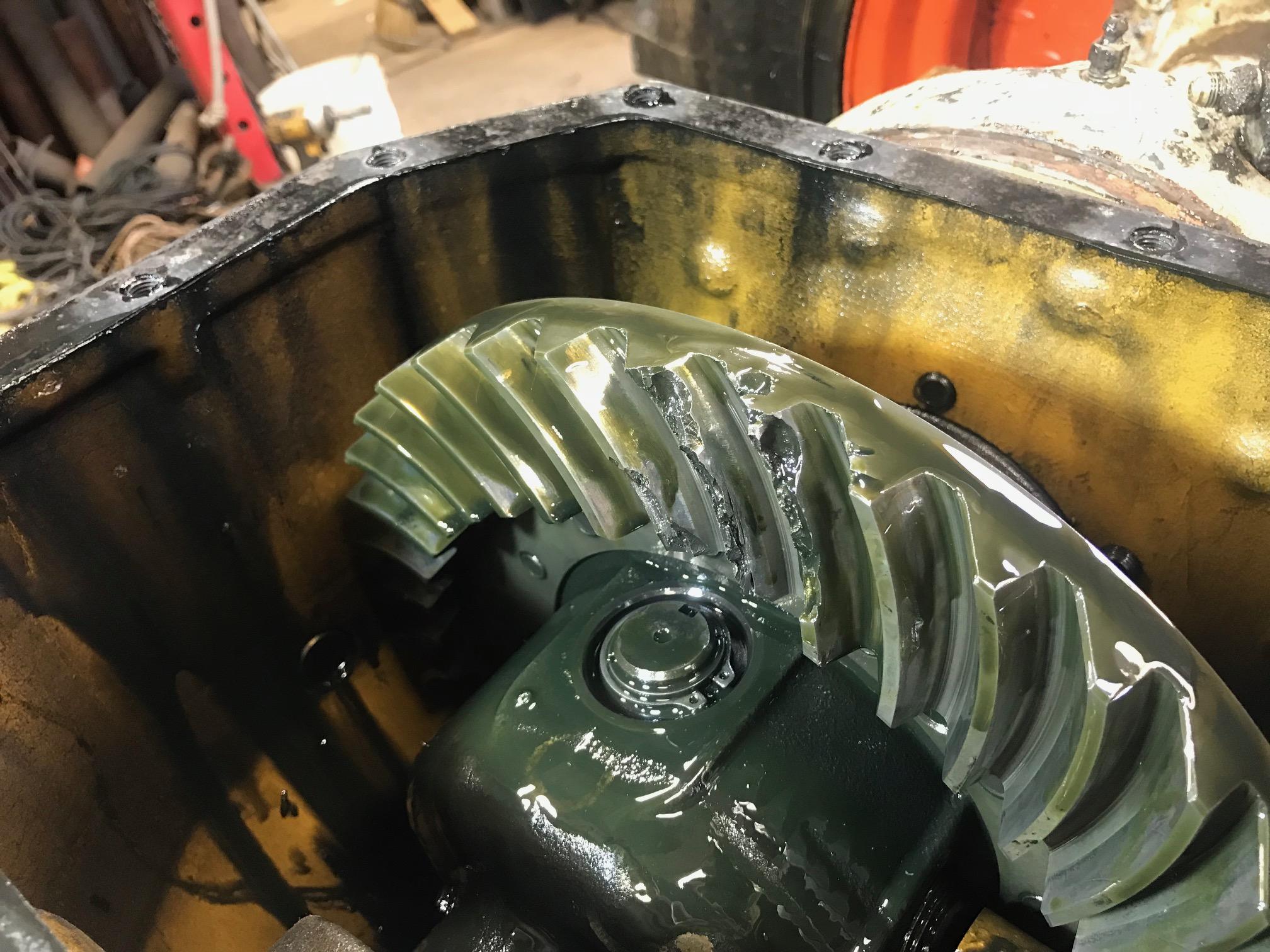

I'm going to post picture of damage. I haven't ruled out welding up the 3 teeth with either stick or TIG. Not sure yet what filler rod to use. I'm open to any and all suggestions. This old loader gets "kid glove" treatment. Just wish I had pulled rear out when I first thought there was a problem.

At least you had a good portion of the root of the tooth to work with. What did the pinion look like? Most times I have seen damage like that the pinion took the worse of it.

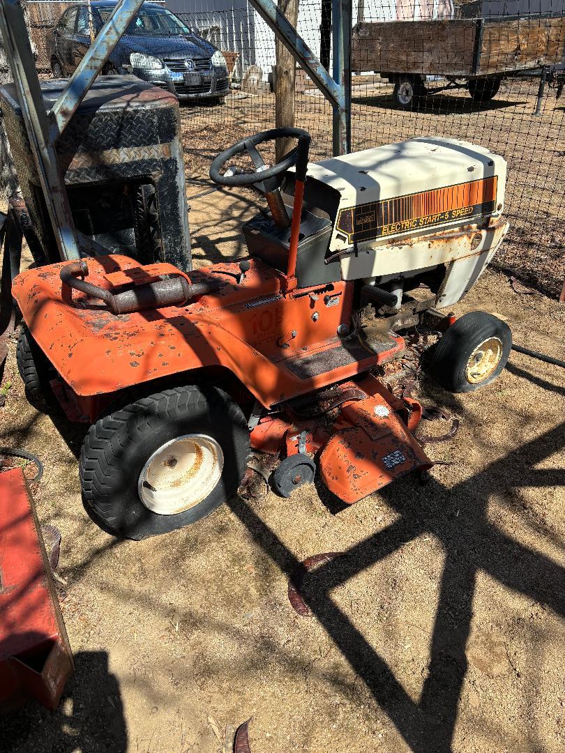

well theres my wonder wagon,,,,bought it like 15 years ago,,and got all the parts to fix it,,,like everything else around here get stuff and it sits for fifty years,before i do anything with them.lol....just ordered 4 new tires so i can atleast move it into the shop ...been sitting so long all 4 are dry rotted from going flat and sitting in the dirt......sometimes when i decide alright this thing is been sitting way too long now,time to do something with it,,,,thanks for the inspiration...bob
