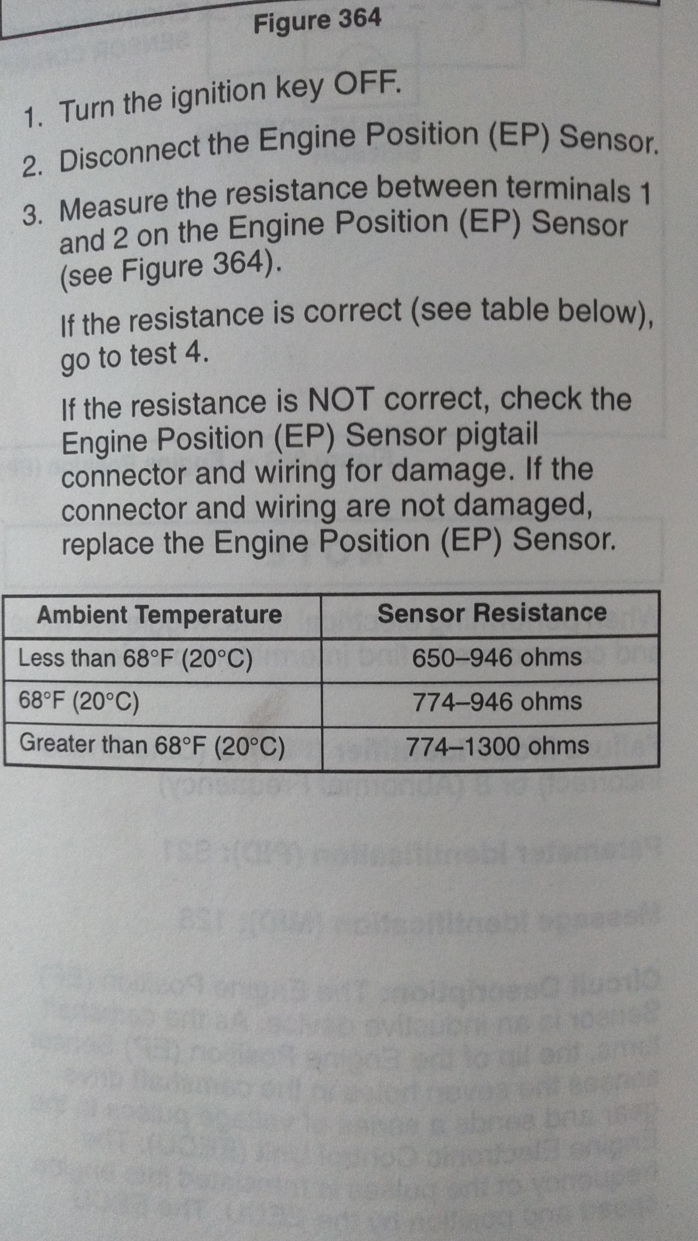

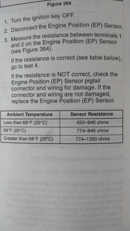

Interesting..... Any codes??  have you checked the Eng. Position sensor next to the overboard breather filter, and the RPM TDC sensor in the flywheel housing, at 10 O'Clock , (left side). you can Ohm them to see if they are open, you can also unplug one and try to crank the engine (after its been running and warmed up) if it cranks on the one thats plugged in, then switch off, and plug the first one back in then unplug the second one and try to crank it. if it doesnt start, the sensor that is plugged in may be bad.... I know "V" has the specs for the Eng. pos. sensor depth to the cam. I have taken the teardrop shim out and "Bingo' it cranks right up..   I will look for the Ohms. I think it's 900-1500 Ohms resistance...  jojo
