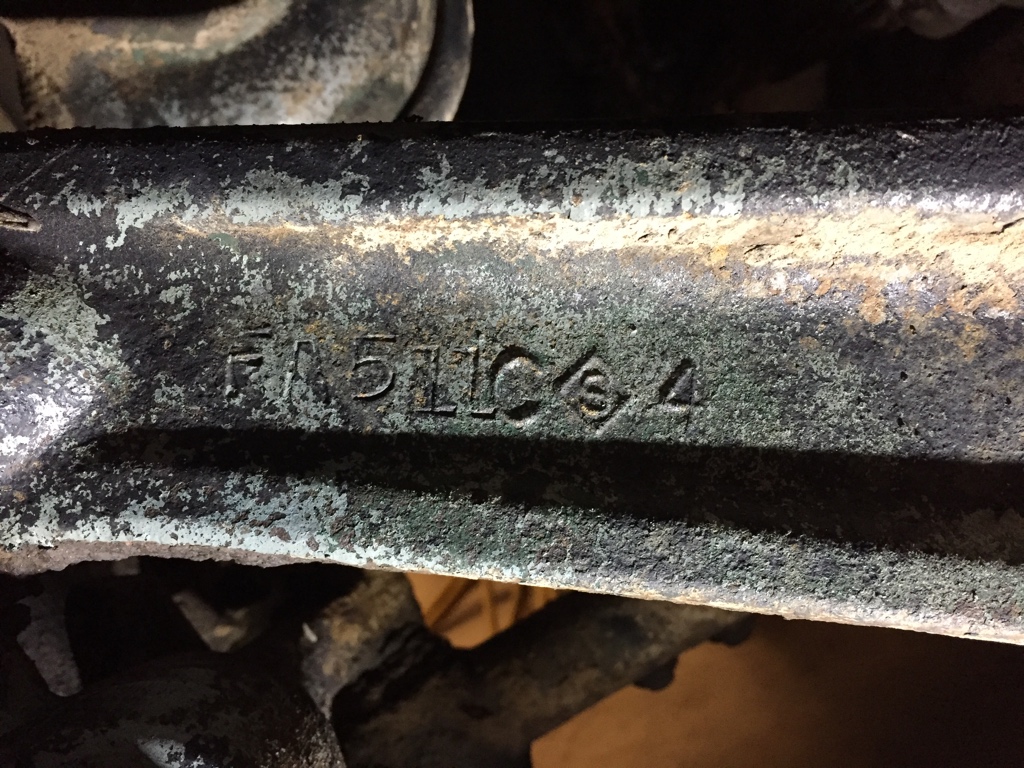

What front axle?
Probably an FA-511, or FA-512 which were very common in that series in those years. The hubs make the axle look narrow compared to the later styles.
The 522 is under a B series and too narrow for the R. The stamping is around the right side spring saddle of the axle beam. Look from the front of the truck.
No. It will be stamped into the axle beam itself below or very near the spring seat and viewed from the front of the truck looking rearward. It could be a faint, or light stamping and may take a wire brush or wheel to reveal it. I have never seen an axle that was not stamped unless it was a Rockwell/Meritor, or sometimes Eaton. If any of the vendor axles, there would be, (or have been) a tag riveted to the front of the axle beam centered under the truck and viewed from the front.
I have never seen a vendored front axle beam under a eastern R model but have on a couple of westerns.
On 2/7/2021 at 4:24 PM, Bigdogtrucker said:
looked around on the front of the axle couldn't find it could it be in the back possibly?
Easily. My R-model axle beam had its stamping at the front. I type "had" because I removed it from the truck at a certain time. I investigated it through very well before sandblasting and paint and found no reason I couldn't put it backwards installing back on the truck. So you know where to look at. My understanding you will find the stamping or a ground off spot where it was.
Although the axle will physically bolt in backwards, I'll wager it would really be an adventure to drive. You have steering angles which would all be incorrect. Negative caster where the original was positive. Incorrect camber for both sides of the truck. Steering axis inclination really out of kilter. Many of these angles are designed and machined into the axle, and spindle forging(s). King pin inclination for instance which is 7 degrees positive in this application. This is never neutral but rather positive meaning to top of the king pin is more to the rear than the bottom. Reverse the axle beam and you reverse the angle which directly affects caster, camber, toe out on turn, etc.
Naw, really don't think your axle is installed incorrectly myself as you would know it at very low speed and find it most likely uncontrollable at normal speed.
I've seen some of those axle stampings be quite faint over the years and obscured by rust/corrosion. You can usually find them with a heavy wire brush on a small grinder after you get the axle beam down to shiny. It is always preceded by "FA" and a number. Sometimes there is a hyphen after the "FA", sometimes not and just a number unless as Vlad has mentioned, been ground off for some reason.
