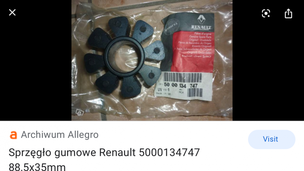

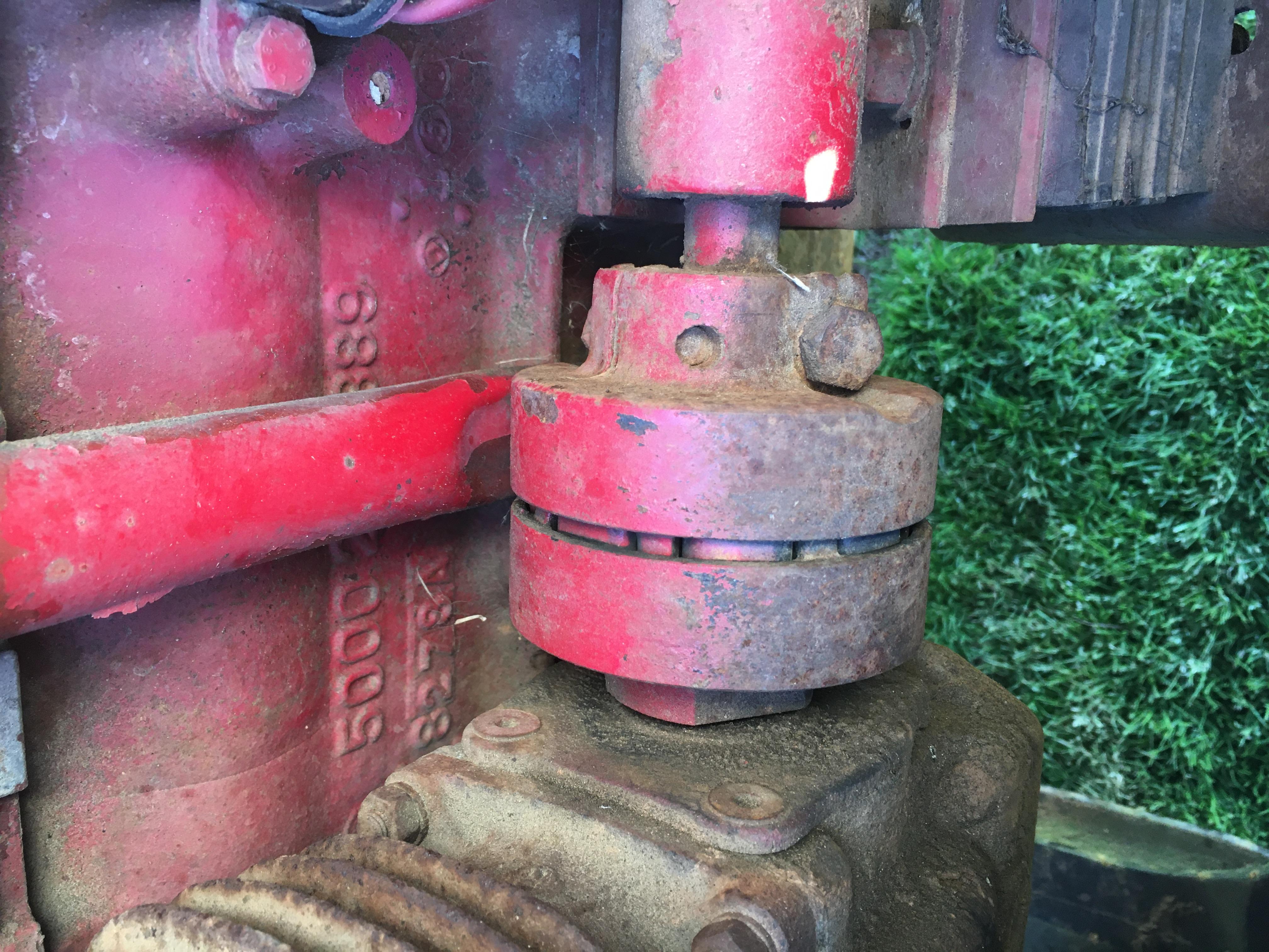

I have a 1989 Mid-liner MS200. The coupling in front of the Knorr-Dahl air compressor has become very noisy until the unloader valve opens. This is my first truck with air brakes and I’m not familiar with what this coupling is called. I’d like to replace it and am hoping someone can tell me what it’s called, and maybe a part number.

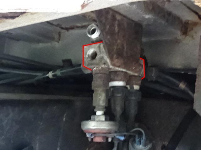

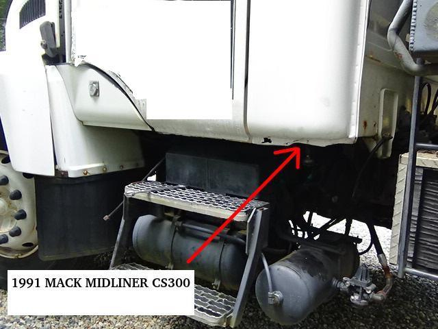

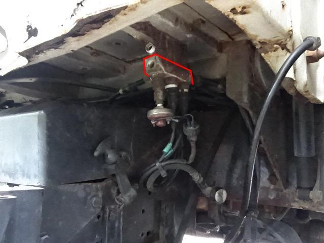

I got the truck last year. All of the brake valves were leaking. I’ve replaced the unloader valve and the foot valve. I’m having trouble finding the parking brake valve and want to replace the noisy compressor drive shaft coupling. Other than the worn out brake valves, the truck is completely solid. Former Penske truck. 125,000 well maintained miles. Not a single leak or wet spot on the 5.5L engine. I believe the truck was parked when the unloader valve gave up and they started looking for parts. I have no intention of ever stepping foot in a Mack dealership. So far, I’ve crossed numbers and found parts on the internet for very reasonable prices. Thanks for any help. I look forward to learning a lot here. Of course, the pictures turned sideways.

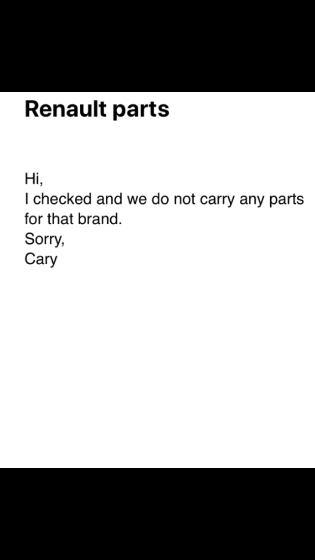

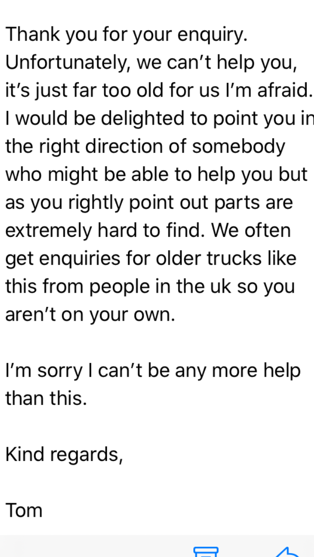

Awesome. The seller on eBay that has the catalog for sale offered it to me for $299.99 today. Is it me, or is that a bit excessive for a parts catalog? So far, the numbers that Panelizer provided haven’t produced much. I know these parts aren’t  exactly on the shelves at Autozone, but I was hoping to shake something loose. Patience. I’ve got time. I’ve emailed a couple places in Europe. I’m a “glass half full” kind of guy, so I’ll fill my glass eventually. Thanks again for the help.
Link to post

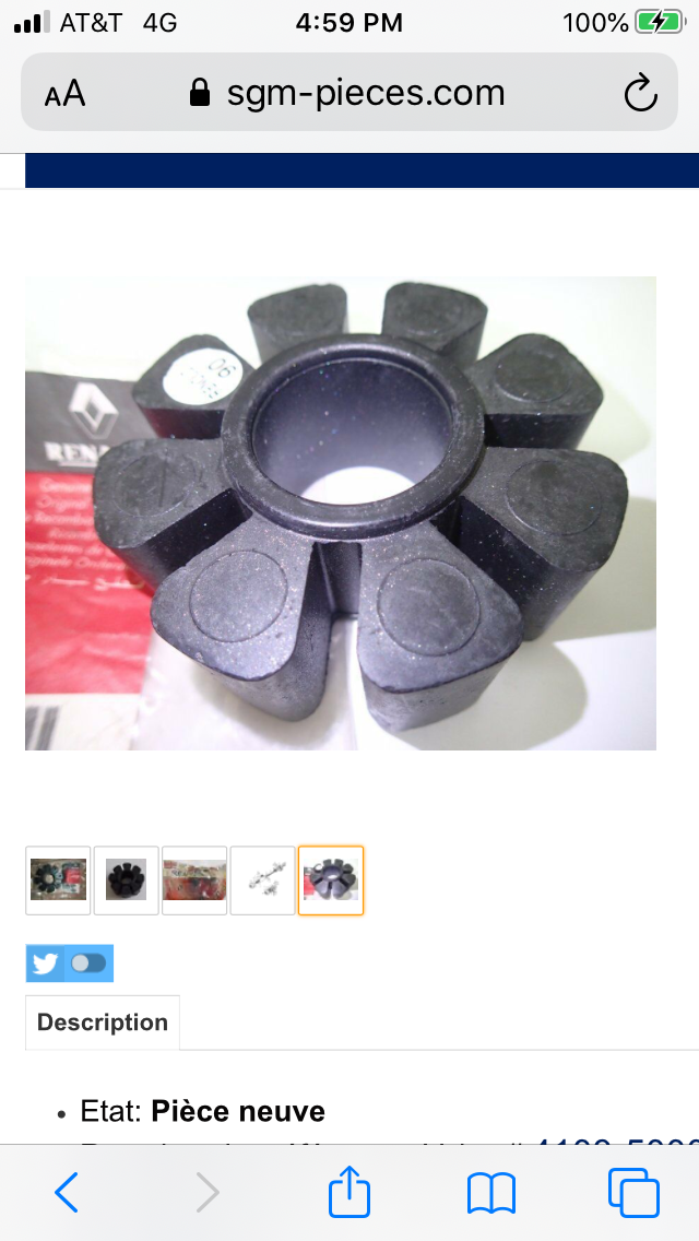

So far, I’ve got a bite in Slovakia. Waiting to hear from France. Looks like it’s less than $50. Just in case anyone is interested. Thanks again for the part number Panelizer. Just took patience.
Link to post
When you get one, I'd get a few 3d printed to keep or sell.
Link to post
For anyone interested, I found one in England and it’s on the way. Thanks again to panelizer for providing the part number. Just a few more relatively minor parts, and it’ll be ready for work again.
