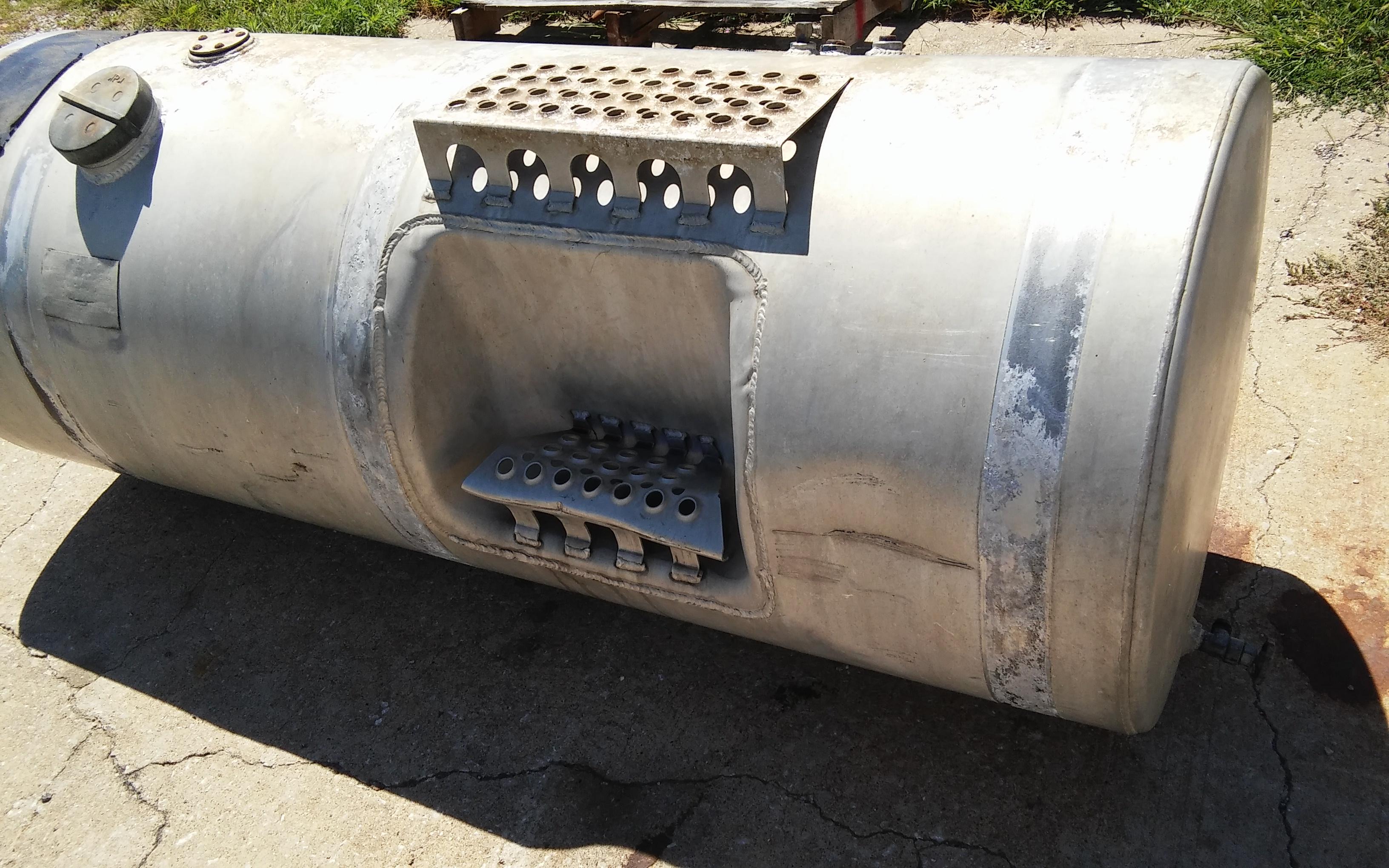

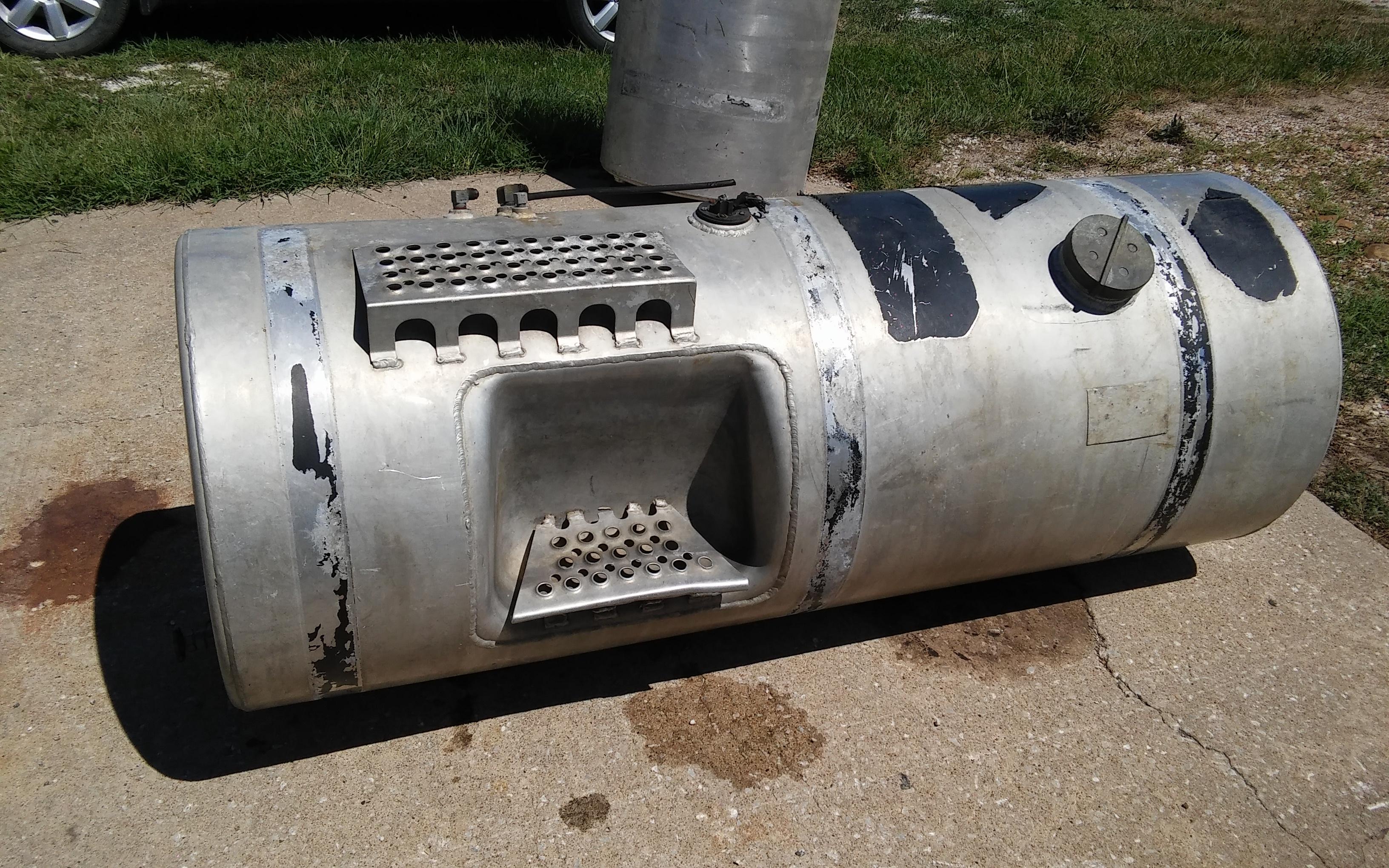

On 10/11/2019 at 5:40 AM, Roscoetaggart said:
hi guys
In the process of restoring my r model currently, I am after two alloy round fuel tanks and have found two that are off an early ch in good condition, will these tanks fit my r model?
Cheers
What size are you looking for (gallon capacity) and are you opposed to buying new? My '95 has aluminum tanks, if you use my vin at the dealer it should get you a set of ~50 gallon tanks....
