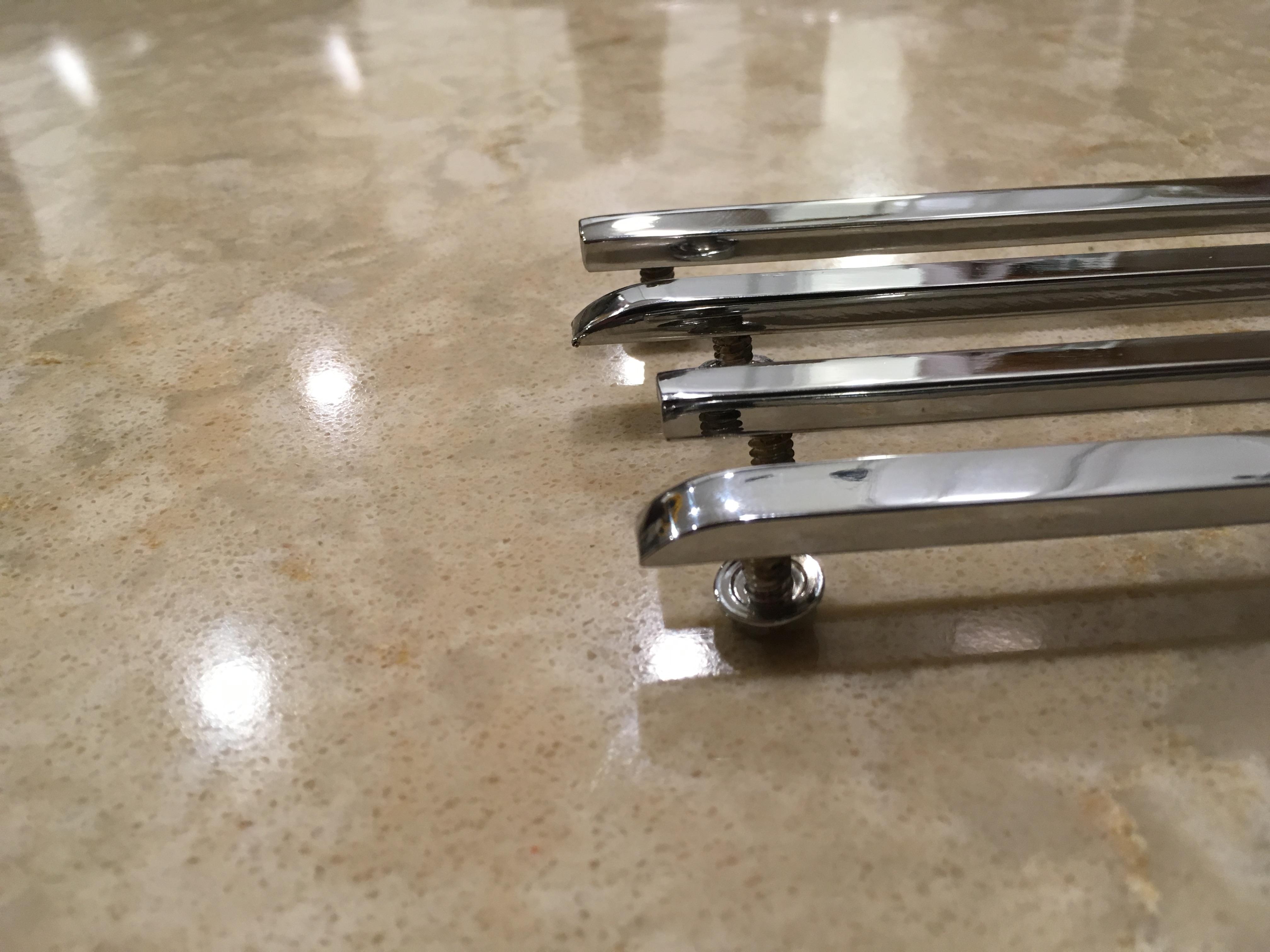

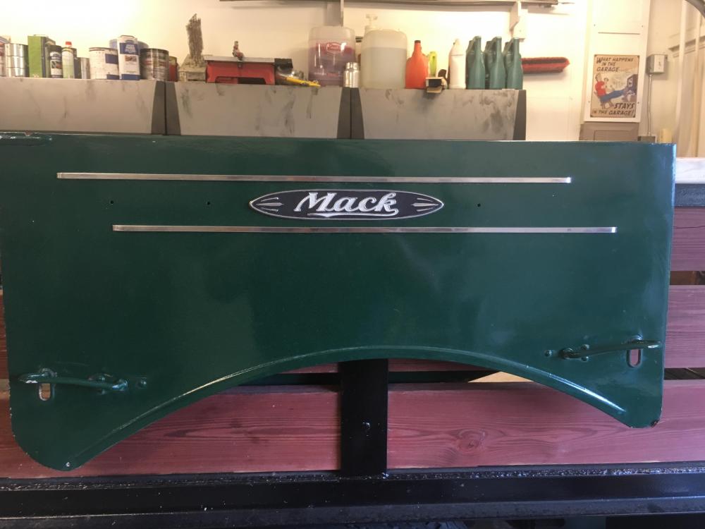

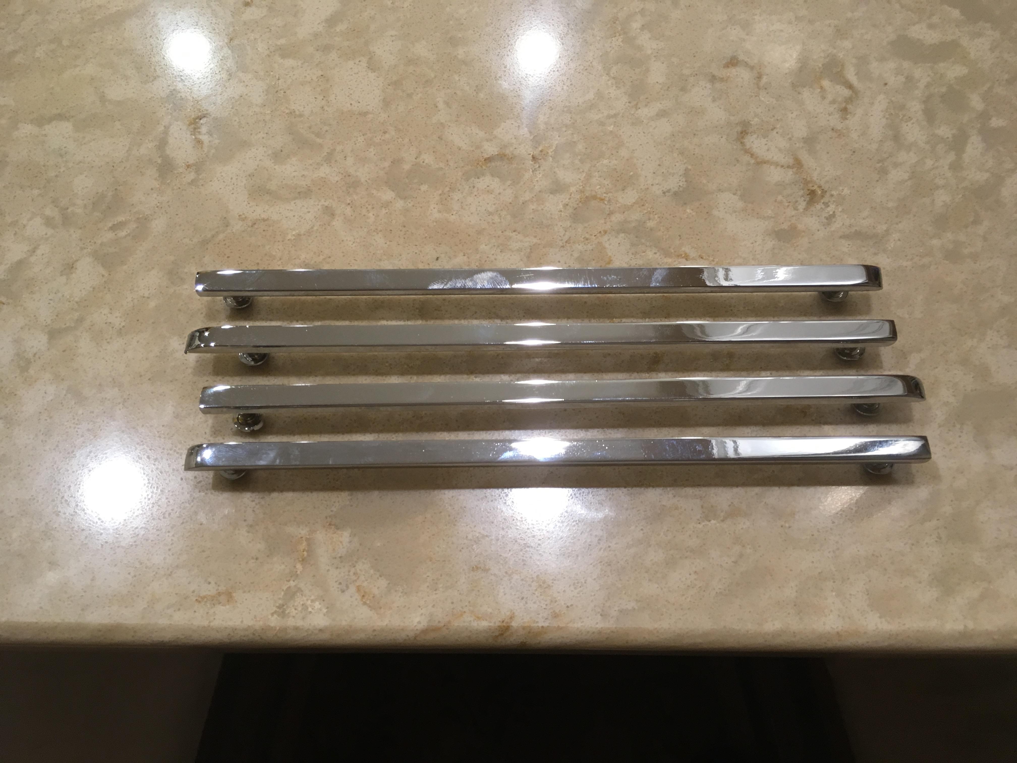

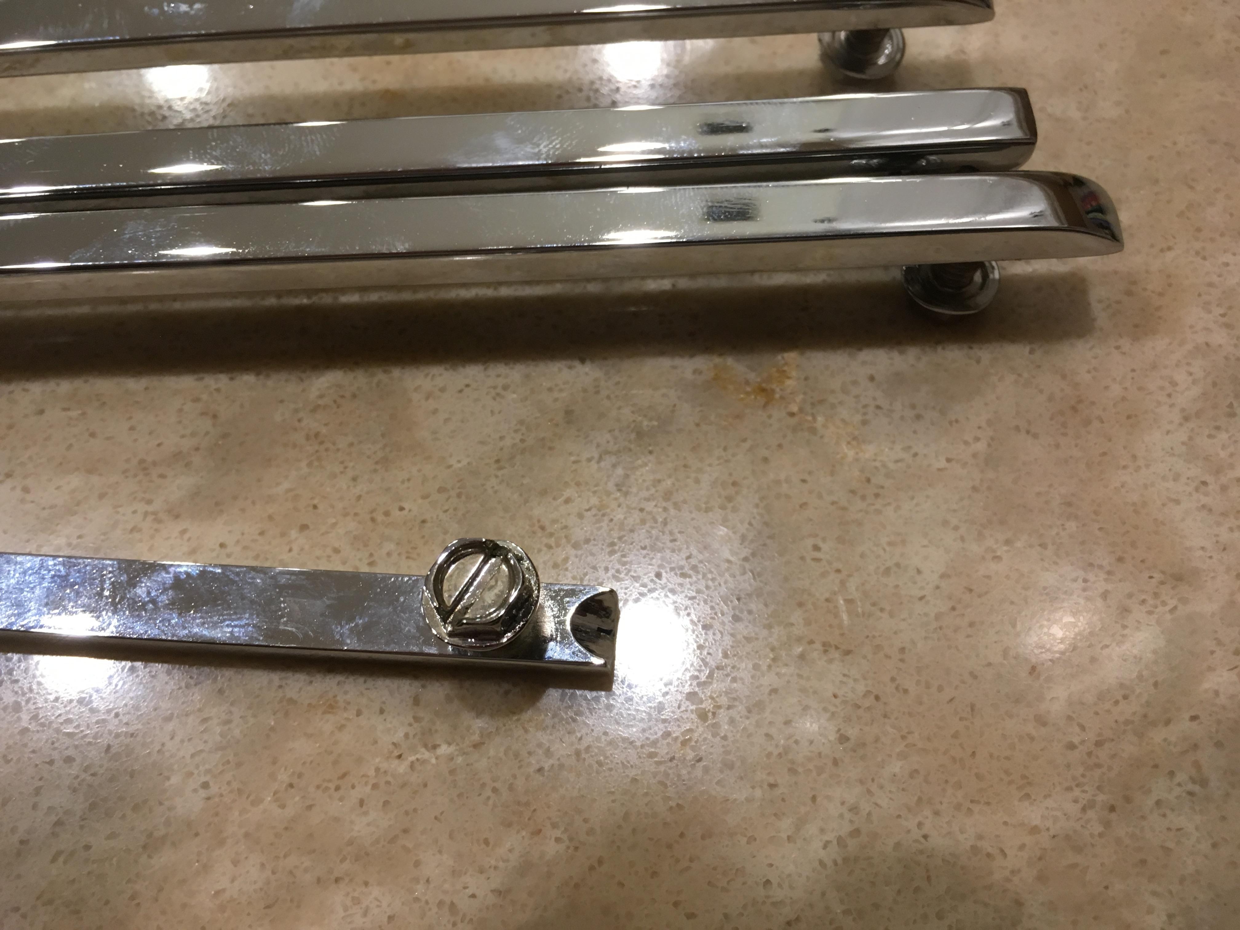

Patience, grinding wheel, files, 1200-2000-3000-grit wet and dry. They are made from 3/16" x 5/16" Grade W1 Steel Ground Flat Stock available from Fastenal in 3-ft lengths for $8.15 (shipping was more than material). I made a mock-up of the hole pattern from the hood so I could lay it on the workbench. I did discover the holes in my hood leaves are not consistent, I don’t know if this was a Mack issue from 1942 or if someone else re-drilled the holes. Drilled shallow holes on each end and used a thread forming screw to allow for connection points for the chrome process. Had them chrome plated locally here in Richmond @ Hanlon Plating Company. In a conversation with Tom Hanlon he said they do a fair amount of plating for antique trucks and tractors . GOOD LUCK  and let me know how it goes.

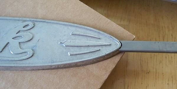

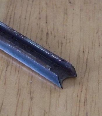

I think I shared these pictures before but it is an OEM strip against the Mack badge.  When I made a set, a friend had some brass stock that is just a smidge wider than original.  I am hoping he has some more brass in stock when it is time to make some more.

The thing that impresses me is you where looking for them.   Then 8 days later you had them made and chromed already.     I wish I was that productive.
I had actually ordered and cut the stock to length months ago but wanted originals. Just decided to finish them the day after my post. The whole process for each piece, grinding the ends and sanding/polishing only took about 25-30 mins each and I took them to the platter the same day. You revealed my lack of patience, especially for these after looking high and low
