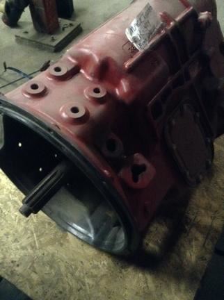

If this  is what your asking about, it is the way it should be.
MACK-T2080-Transmission-Assys-WlunLnhqUE5O_f.jpg.aa1e5204479182f9a796adc0ea3791fb.jpg
Yes about an hour or so if you've done one before. I haven't done one in years but it all comes out from the front. Input shaft cover, a snap ring, bearing and second snap ring as I recall. I think there was also a bearing on the main shaft the Input shaft goes on. Need a seal and gasket for the cover and lock tight the bolts.
Personally for the hour labor I would let a tranny shop do it while you wait.
