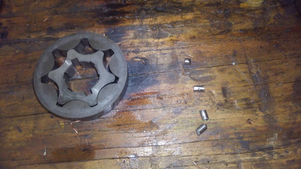

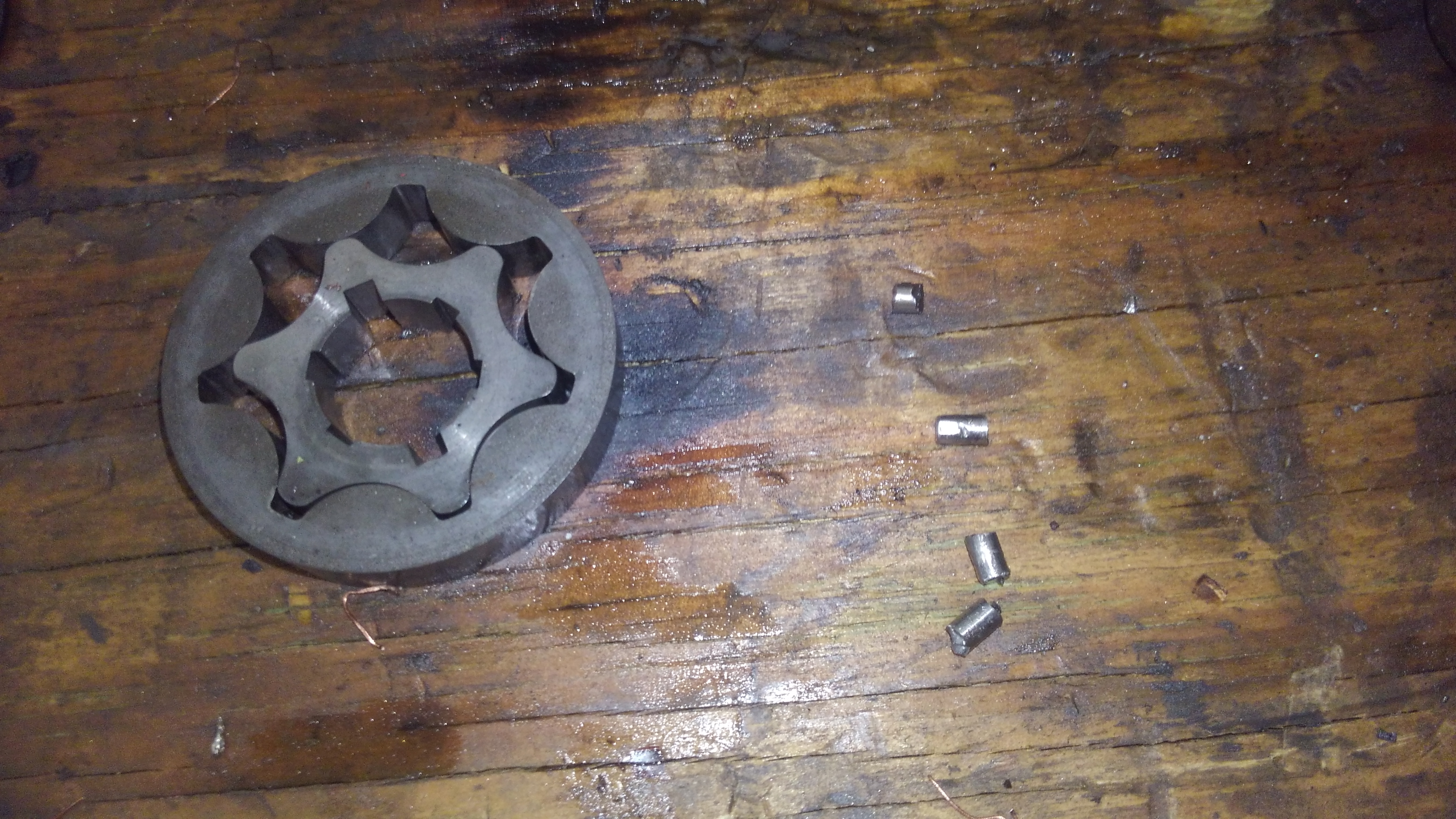

so i think were actually figuring some things out now, i just pulled the dang thing out of the skid steer today and started taking it apart. bearings on the input shaft  are completely fubar. separated the case half's the piston pumps actually look ok. the roller bearing on the back side of the case on the input shaft fell into peices. i got the sheer pin out of the input spline but the input spline is stuck on the shaft pretty good. but while trying to remove it peices of what looked like parts of the sheer pin to the small gear pump that pulls new fluid into the case fell out. so i would guess when the coupler broke it fubared my bearings extra shaft play broke the shear pin on the fluid gear pump and caused my current problems.

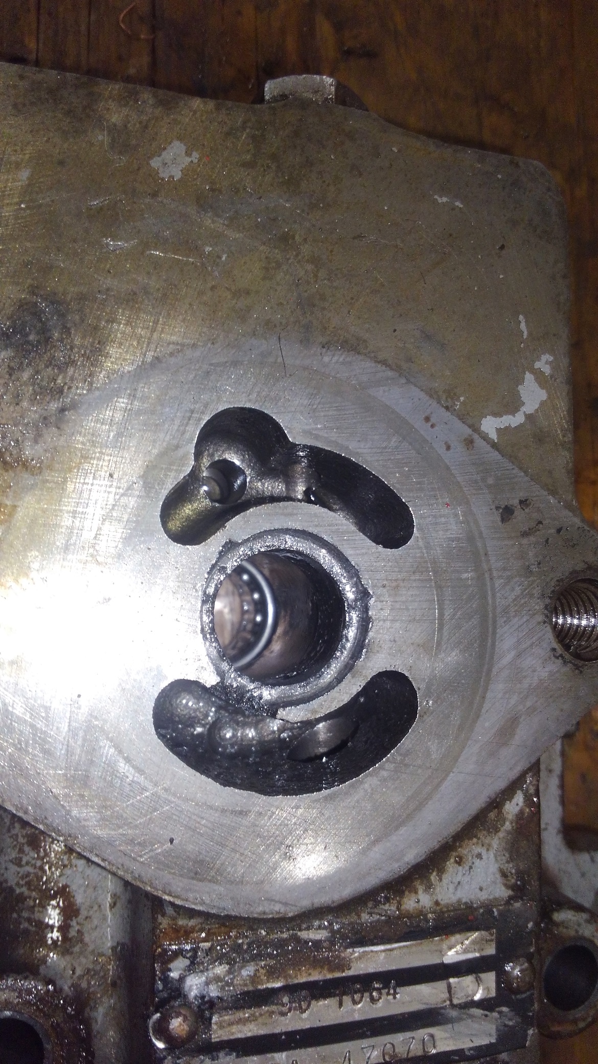

i got the drive gear off today so i could get the charge pump apart took getting it red to get it off no idea why it was on there so tight when its not supposed to be a press fit.  got the drive torn the rest of the way apart. other than the relief and check valves ect probably safer to keep that stuff installed for now. i did take them apart and look at them all looked good then put them back in there housings.
most defiantly a failure of the charge pump. looking at what i found i wonder if it wasn't necessarily the bearing failure that caused the charge pump failure. but a seperate issue maybe a small rock or something ended up inside the hose when i was snaking the new hose threw and got sucked into the charge pump. there is a little chunk of the housing that is broken off. quite a bit of debris in the charge pump.
also now that i know what pump it is rather than looking for information based on application. was able to find a service manual in pdf. seems i don't so much need to change a pressure relief valve to make the replacement work but delete one. looking at a flow diagram the implement relief valve is between the two implement ports. and the charge port is prior to the feed port, so in normal operation the flow is regulated to charge pressure then threw the open center valve of the implement then back to the pump. so the flow bypasses the implement valve until a load is put on it. so basically i will just need to remove the guts of the second relief valve and plug the ports.
