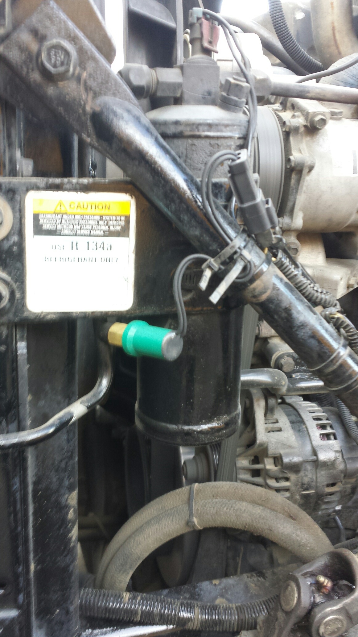

Teammates,
I after lots of guessing and fan clutch replacement (expensive), it turned out to be a bad AC high pressure switch (picture - green switch). Fan works normal now, and only comes on when coolant gets hot. I appreciate the input from all.
