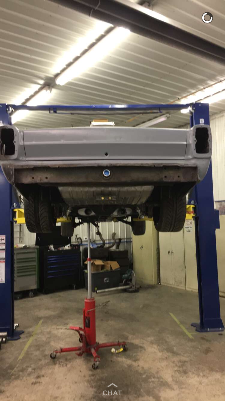

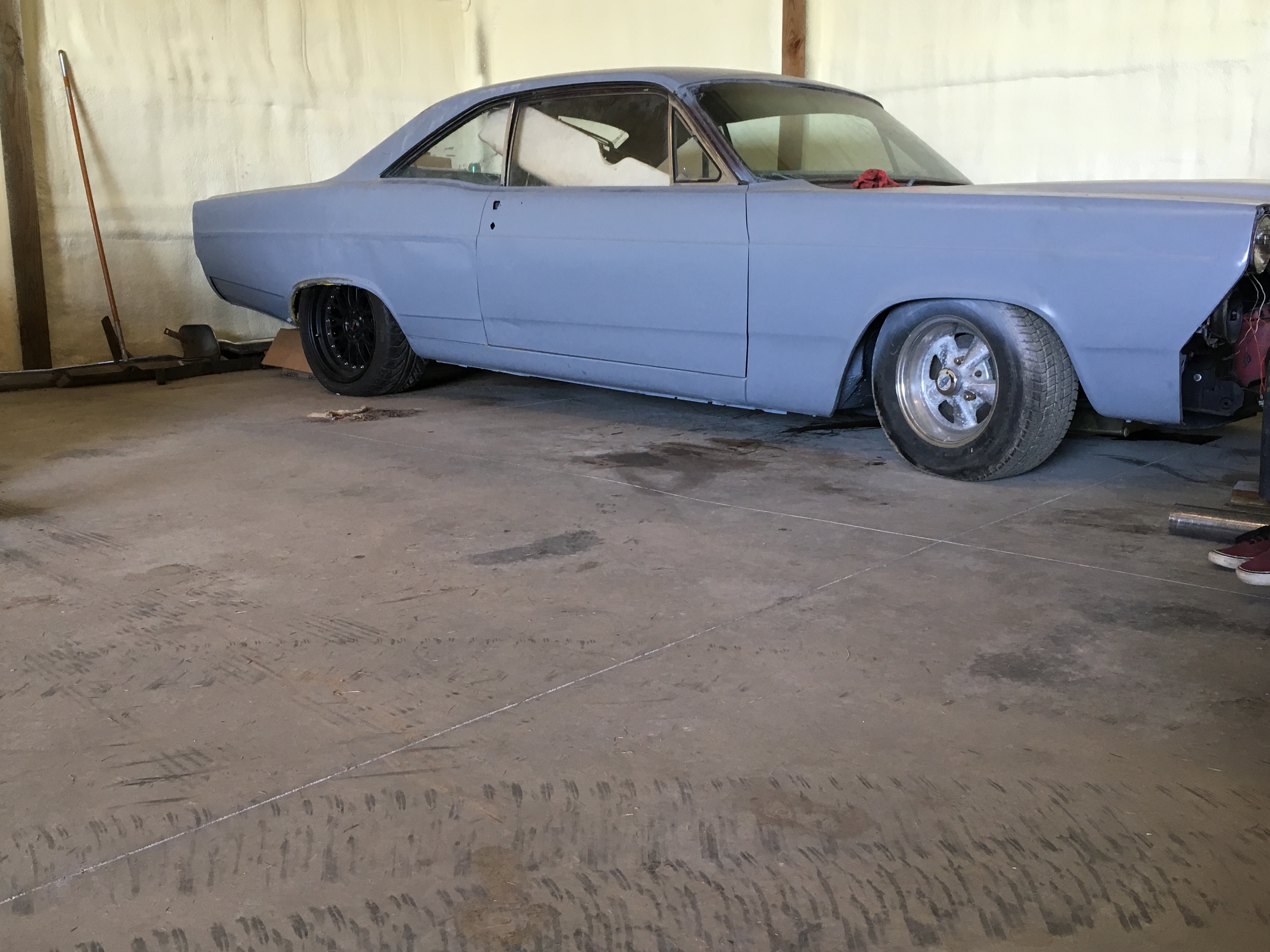

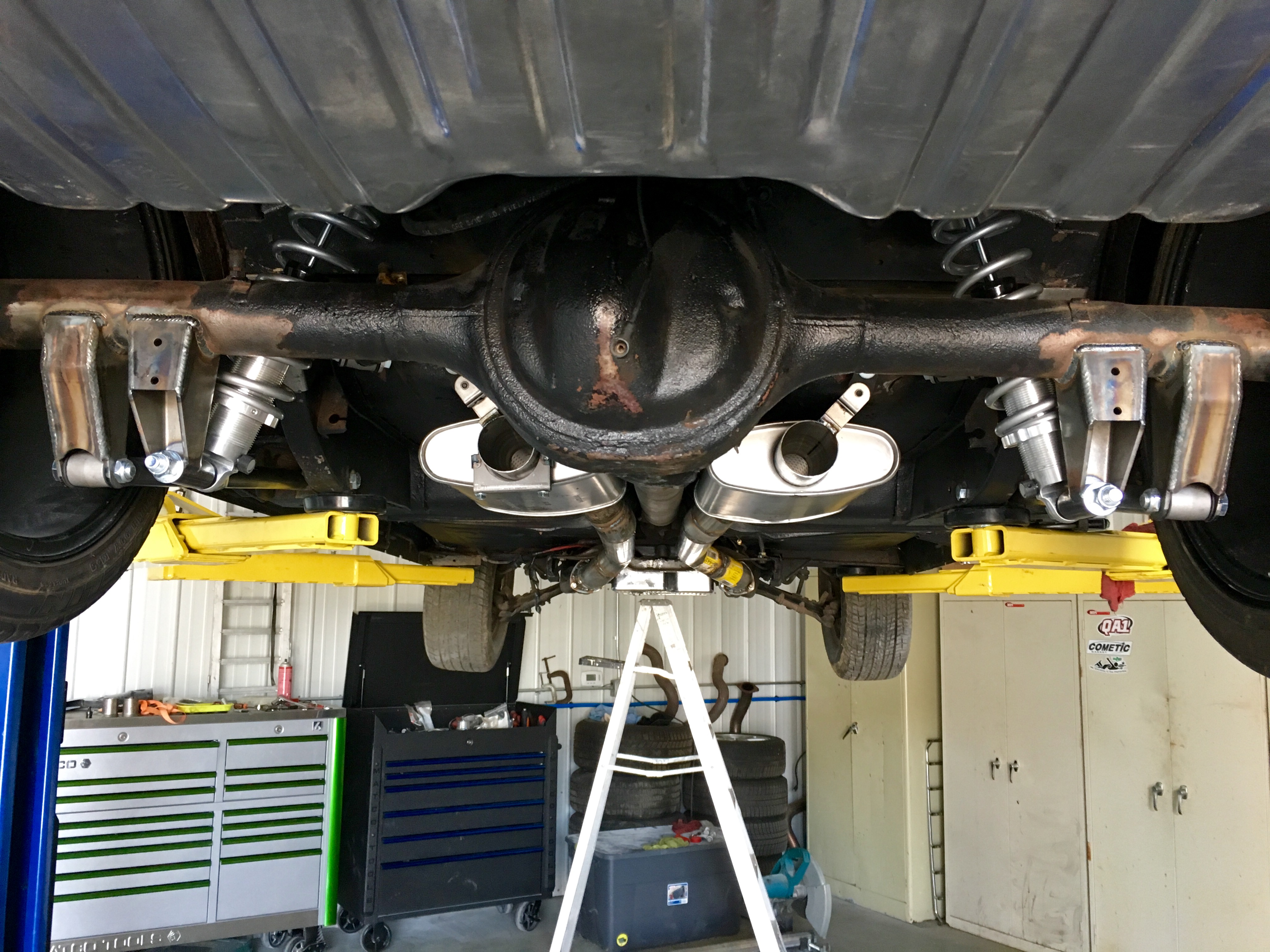

Not a truck, but a car. So I have this car and I am trying to find outer wheel houses. I have the inner ones but am having trouble finding the outers. I was wondering if anyone on here may be able to help me out finding them. I am building a restomod. I love the old look of the car, but drum brakes and poor suspension is not my cup of tea. So I put 4wheel disc brakes in it tubular a-arms with double adj. coil overs. I also put in a custom triangulated 4 link. I have done nothing to the body. The guy I bought it from botched the quarter patches so I am going to put full skins on it.image.jpegimage.pngimage.jpeg

Thanks guys but I have the quarters and the inner wheel wells, I am looking for the outer. The wheel wells are two piece inner and outer I can't seem to find to find the outers. I may have to modify mustang ones.
There are no outers made for the Fairlane or Comet. Try Mustang or there are 67 T bird outer patch panels.
I figured that was the case. ( sad face ) oh well it's just a lil more work to modify the others. What's a lil more work, right?

66 R gotcha on the wife! My wife's friend tried to teach her on a Corvair,but it didn't happen! Started to look in Hemmings but just went numb,they have so many listings I'll try again tomorrow! I'm diggin' the 4link and coilovers should corner like it's on rails
