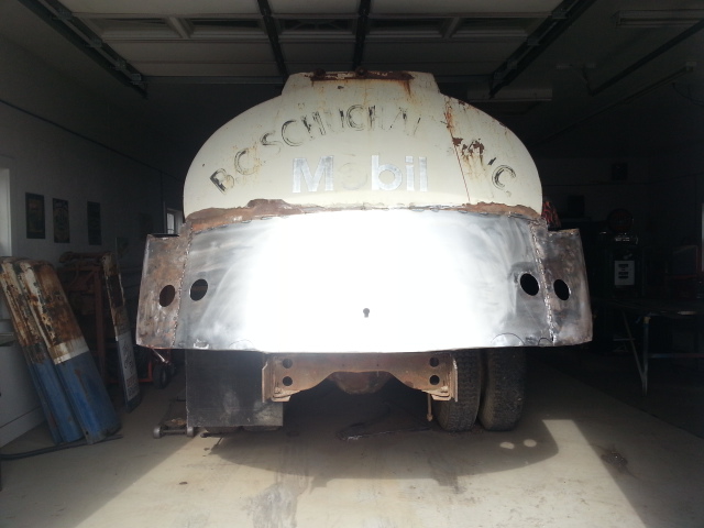

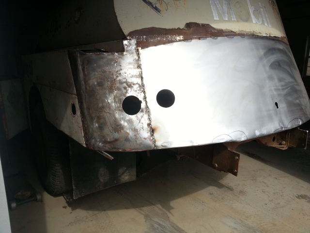

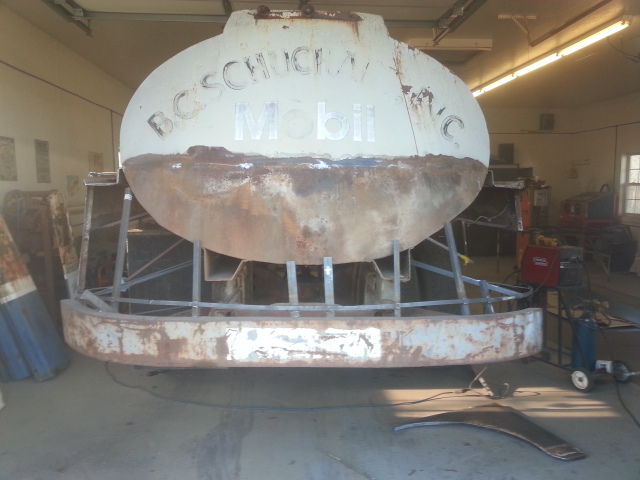

I still have some massaging to do along the bottom edge. I rolled it by hammer and dollie around the framework I made.  The panels on the far left and right sides are made from a roof section from a '57  Chevy pick-up.
They had the perfect curvature and fit the original panel perfectly.

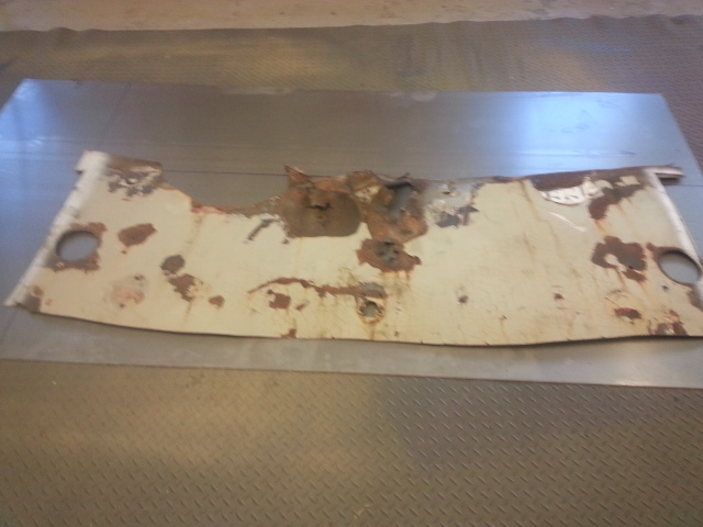

Then it was just a matter of cutting away the rotten panels and installing the metal.
