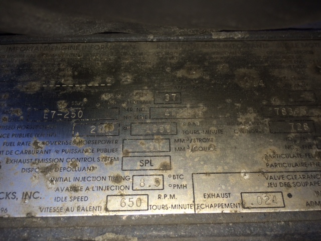

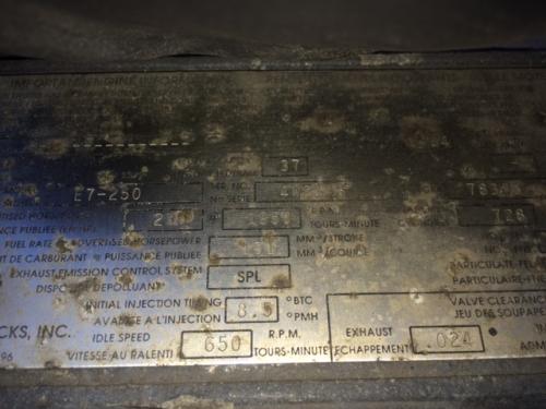

Engine tag shows E7-250 (not Maxidyne EM7-250). According to the 1993 Engine Spec Manual, the E7-250 was only offered in mechanical (no V-MAC). Since I do not have a 1995 manual, I don't know if the E7-250 was offered with V-MAC. I can't tell from the engine tag if your engine is a V-MAC.
E7-250 operating range is 1200-1950 and max torque is 975lbft. If you want to go to 300hp (1950rpm & 1083lbft), you will need different pump setting, injectors, and turbo. Again this is based on the 1993 manual information.
