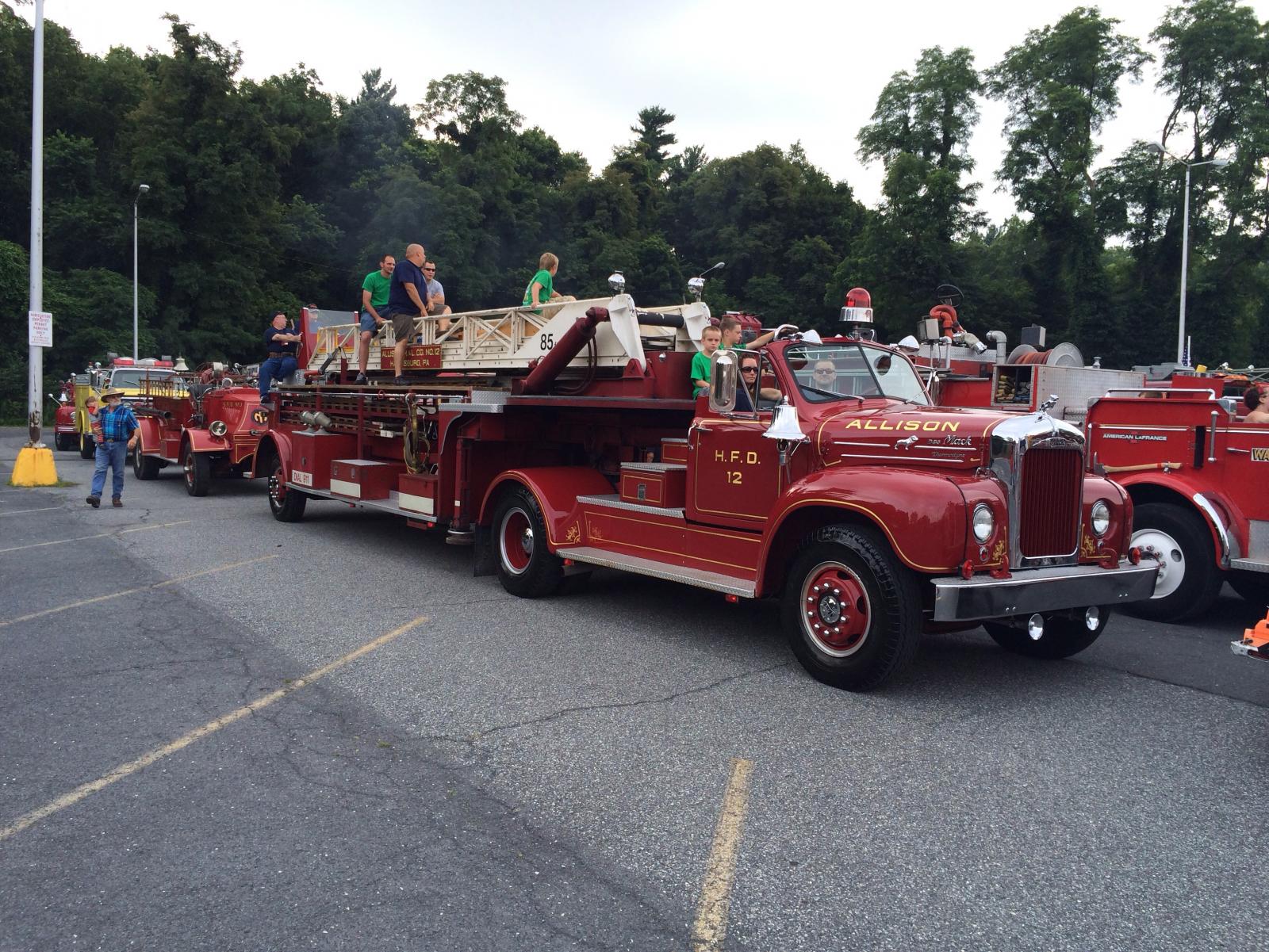

Posting pictures is tough. Go to "more reply options" in the lower right. Then "chose file" in the lower left. Pick the file. Then "attach this file". Then "add to post" to the right of the small picture. post-7810-0-47309500-1407629976_thumb.jp. This is Harrisburg PA ex ladder 12. Wish it was mine. Mike.
