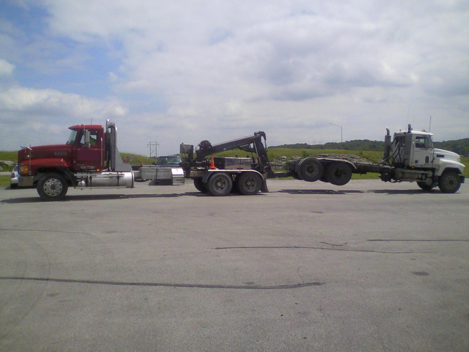

Yeah, it was pretty lucky. Something let loose in the front drive axle about 3 miles south of the get-off to the company yard. Managed to limp it in @ 5 mph with the power divider locked in to get it off the side of the big road and drop the trailer...then got to wait there at the yard for Mack to open (not paying for after-hours service when it'd only be a couple hours until they'd be in) and gave 'em a call to come get me. Had the truck prepped & ready to go by the time they got there....front axle chained up, steering wheel tied, exhaust stacks taped....their wrecker driver LOVES towing me because all of the dirty work is done by the time he gets there, so all he's got to do is pick me up, secure the truck to his, and roll.

I wouldn't have it any other way. It is embarrassing enough just being on a hook....don't think I could handle the shame of being dragged in by anything other than another Mack.
That "simple" wrecker (without all of the side boxes, bells, & whistles) hooked to the rear of my stretched-out daycab really makes for an interesting pic, though......veeeeeeeery long looking combination.
