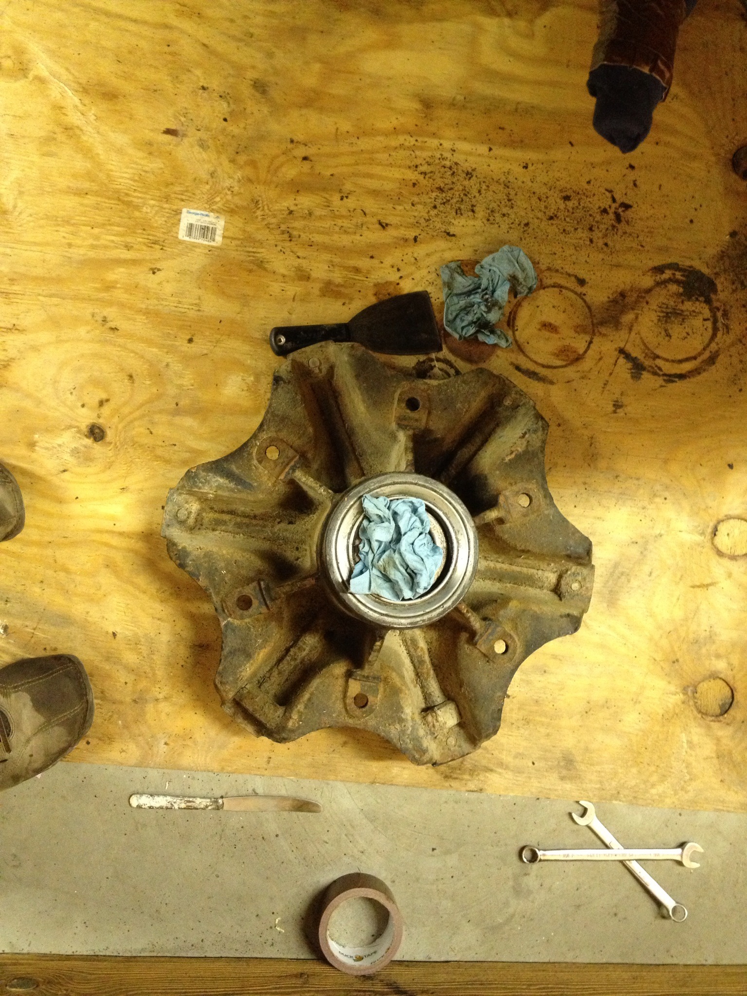

Hey folks,
I need to clean up my front hubs and through a coat of paint on them. I would also like to clean up the wheel bearings before I reinstall them. What is the safest way of cleaning wheel bearing? Can I wire brush and power wash the hubs without fear of damaging the inner races with grit and rust?
Thanks in advise for your help.
Trenton

Hey everyone,
Thank you all for the good advice. I am in the process of cleaning the grease out and washing them up with Zep purple degreaser. After that I plan to use stripper to get most of the paint off and a wire brush on my angle grinder to clean them up a bit more. I'll wash them again with the degreaser and use my power washer to make sure I've gotten all the grease and grit out. I plan to dry them with a rag and compressed air but I am sure glad that one of you mentioned not to use compressed air on the bearings.
By the way- I can't locate the same type seal that I've taken out of the truck do any of you know off hand what type will work in a Dayton hub off of a b 61?

You can blow dry them just don't spin them on your hand with air, as far as the seal goes it is a SKF/CR (Chicago Rawhide) 31281, this is for both wet and greased hubs.
You can use grease seals on greased bearings and wet seals on both oil bath and greased wheel bearings
