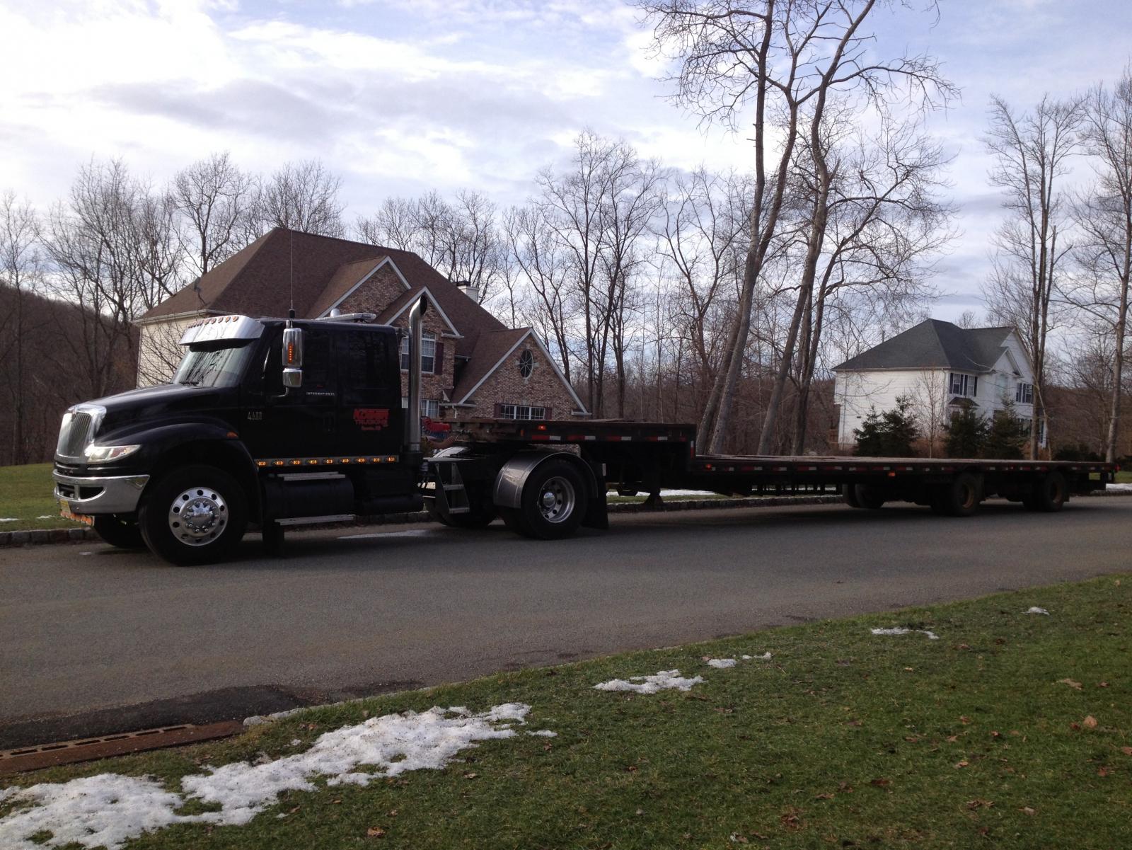

I have a quote to move a crane boom it's 50ft long, 35000 lbs. it's only moving 2 miles from one side of the construction site to the other side. How would I go about securing it to my trailer? I have chains and binders just wondering what's the best way to secure it.
Here's a pic of the truck and trailer

Longer than trailer, I think you have all the binders and chains you need to secure it, but you have to go slower than hell, even at 5 miles an hour it will only take less than half hour to get there. See wwhat these other guys have done in same situation, but you also don't want to damage boom, especially if you put it up on the deck over the 5th wheel. Will you're trailer handle thjat weight too?

I was reserving comment that it may be time for you're rigging division to add a twin screw tractor to you're fleet or at least if you can get enough of this type of work to pay for it.

STRAPS ONLY!!!!!!!!!!!!!!!!!!!!!!!!!!!!!!!!!!!!!!!!!!!!!!!!!!!!!!!!!!!!!!!!!!!!!!!!!!!!!!!!!!!!!!!!!!!!!!!!!!!!!!!!!!!!!!!!!!!! you put a chain on it that is the easiest way to never get called back and they will unload you after chewing your ass out! 2 straps 1rst 10 feet by law 1 every 10 feet. I like a few more. Maybe 2 on the back. I would say 8 or 10 straps. Make sure not frayed. But 2 miles your call. Do it right the first time and you'll have less headaches. You might also need bridges to level it out. Get wood and make sure it levels and secure to deck

I was about to scream the same thing. Do not scratch a crane boom, no chipped paint means no rust, "Rust Bad" use straps, use thick rubber under the straps, conveyor belt type. Block your trailer up level and make the blocks wider then the boom, carpet them. I always strapped through the bottom of the booms not over the top, it's acording to how wide they are, these were 9 1/2 feet square by 40'. I used the 2" staps four, like slpwlkr says, every ten feet. Mine set up on blocks because we carried 2 20,000 lb counter weight under the boom. Hauled many booms up many old mountian trails and cross states to wind tower projects and they stayed on just fine. I know I am too late but maybe some help Tuesday.

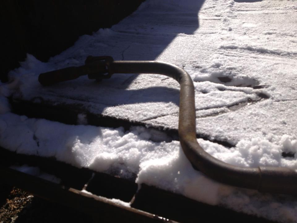

It was an overhead crane in doors all the time. I asked what they preferred and the said chains and binders over straps. I had corner protectors and put them under the chains... Everything went ok, I broke my landing gear handle, broke a bead on a trailer tire, got harassed by Randy :) JK!!!! But everything went well! Pics coming soon. If you like my face book page you've seen them already.
