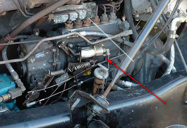

that RW that you are looking at,, should have the old red cable shut down... I see that the leaver has the ear for the cable,,
this truck mostlikly has a kysor alarm system
In the 90's mack used the air shut down solenoid in the V8s but still had the red pull cable that now will read (secondary engine stop)
