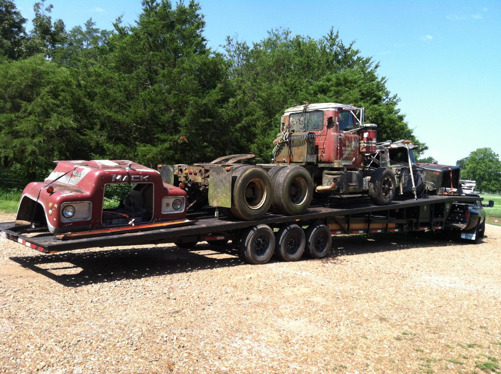

That backhoe should weigh around 15000 lbs plus or minus 1000 lbs depending on the set up, I would pull it with my 1 ton pick up, but then it is a Chevy with a Duramax, pulled my B61 that weighs about that or more a little more with the cruise set at 74, 231 miles.
Chain down good, center your load on the trailer watch out for your dipper boom streach it out, that back hoe is just over 11 feet tall, my JD backhoe has the ROPS, no cab so when I haul it around I am not concerned about height. Watch how you load and off load on the trailer with the angle, and location being level or sloped up the backhoe has a tendancy to drag on the road/ground when when on ramps
