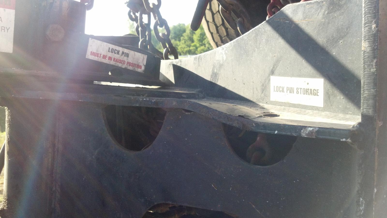

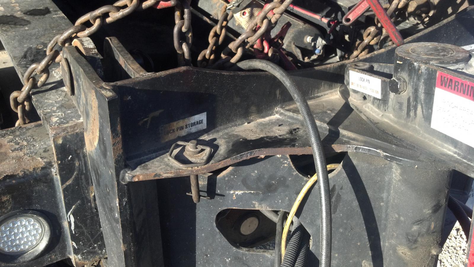

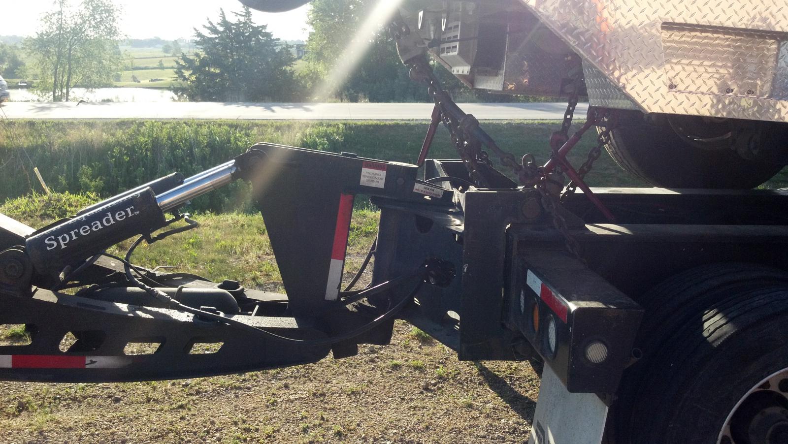

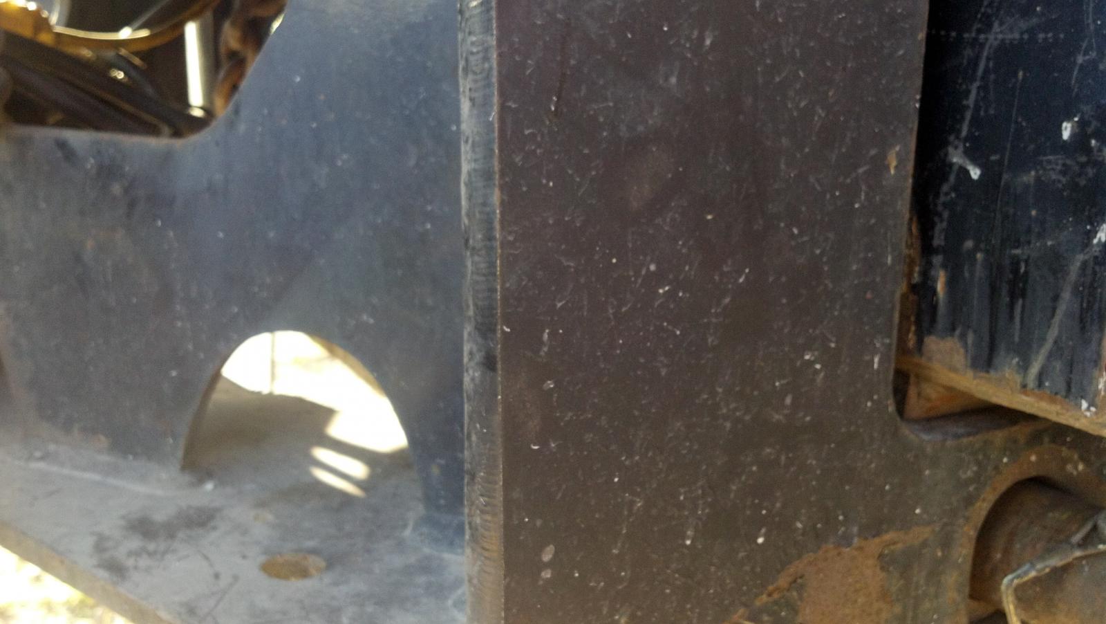

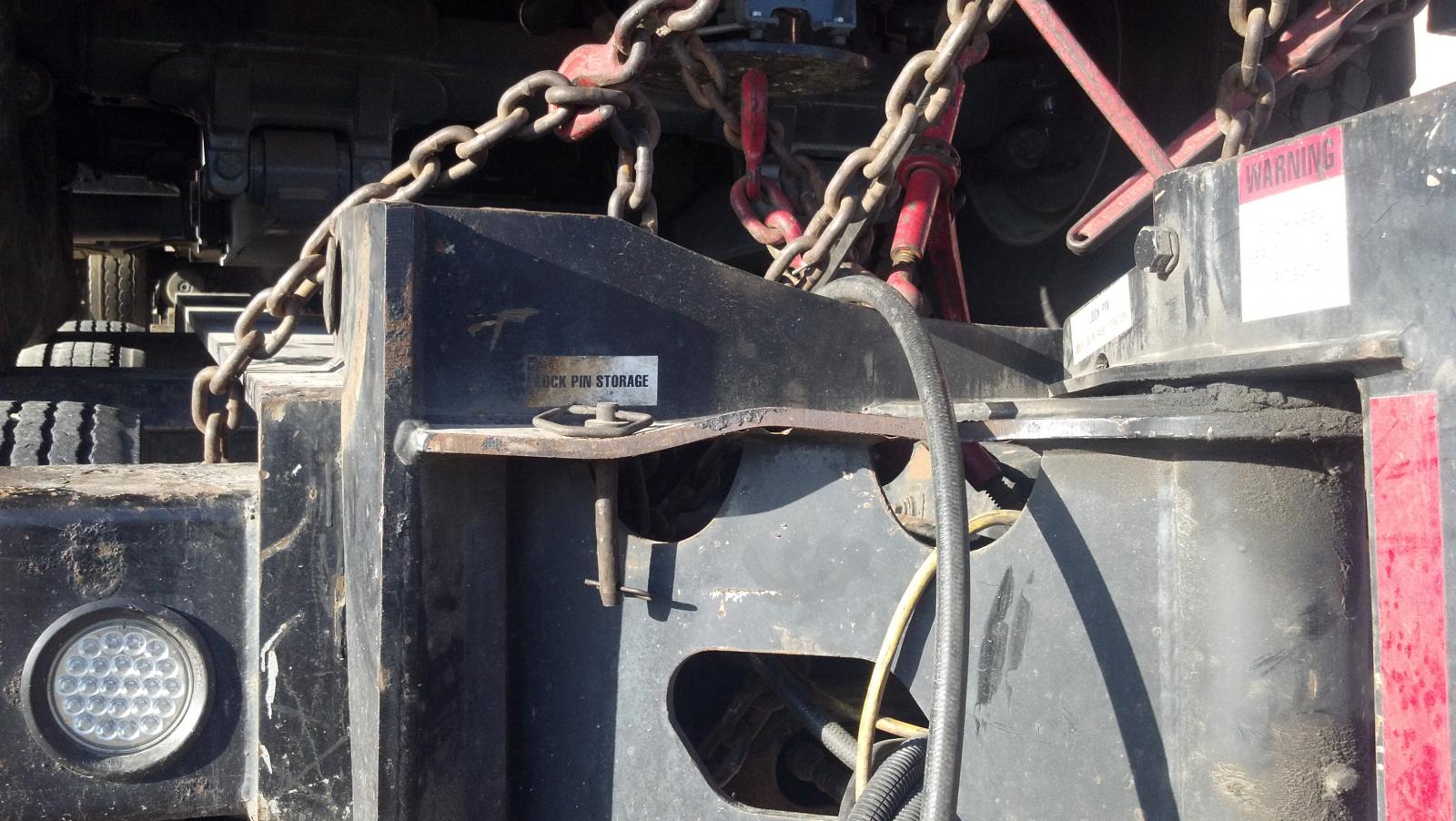

First pic load I had on when I tweaked it
post-8266-0-40537100-1343132734_thumb.jp
Second pic is of the bend
post-8266-0-69086800-1343133229_thumb.jp
3rd more tweak right side
post-8266-0-62896100-1343133281_thumb.jp
Cylinders are all the way out and top is hitting on the swivel
post-8266-0-80204900-1343133386_thumb.jp
Crease on the bottom
post-8266-0-29547500-1343133609_thumb.jp
post-8266-0-15728400-1343133439_thumb.jp

Hell I left thursday went to the truck stop and scaled. Was 7k over on the trailer. went back and moved the 8k of counterweight to the back or front of the trailer reloaded and dropped the trailer for the memorial day weekend. Might of been another one I do not remember. came back tuesday and picked the trailer up set everything walked to the back to check lights and it was bent. This you can't back with on the ground it is made to be lifted the hydraulic and nitrogen system supposed to move and give and equalize out. My system has been flawed from day one.
I remember the hydraulics but not the nitrogen system. Is this an accumulator system with the gas over the top of the hydraulic pressure to "cushion" the shock loading on components? If so, they can be troublesome to keep operational and most operators do not have the capacity for field testing.
Rob
Nitrogen tank or accumalator is underneath. Everybody loves them. I hate it and will not buy another one. Or it will already be plumbed to run of the pto and the lever will be on the back. Not convert it. but battery power will never happen again. probably will just go back to the old style shim and go less stuff to go wrong
