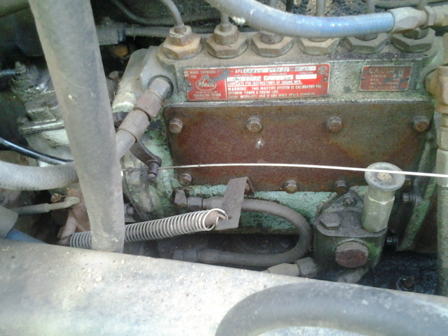

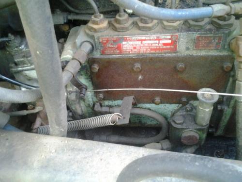

Here's a pic,and the numbers off the governor.6VB250/1050C-56238.The engine is dark grey,pump is green like the older engines.
It is predominantly those numbers from the injection pump tag, and the governor tag you will need to work with. For the most part torque and horsepower curves are generated by these parts and their calibration(s).
The absolute best thing to do is go to a truck shop and have them chain it down and dynomometer the truck for horsepower and torque curves. Install a pyrometer prior so you can watch one of the most important things, (exhaust temperature) so you don't melt things. With a competent shop doing the work this will be no worry as they will use external equipment fitted to your engine.

I'm thinking it's a 350 with a 250 pump,but i could be wrong....
It probably started as a 350 block. Engines can be built to whatever. The pump and governor settings are what controll this. There are variations to the base engines to allow them to withstand the higher stresses of higher calibration setting and therfore horsepower, but one can't be certain of what is what unless the truck is dyno'd.
