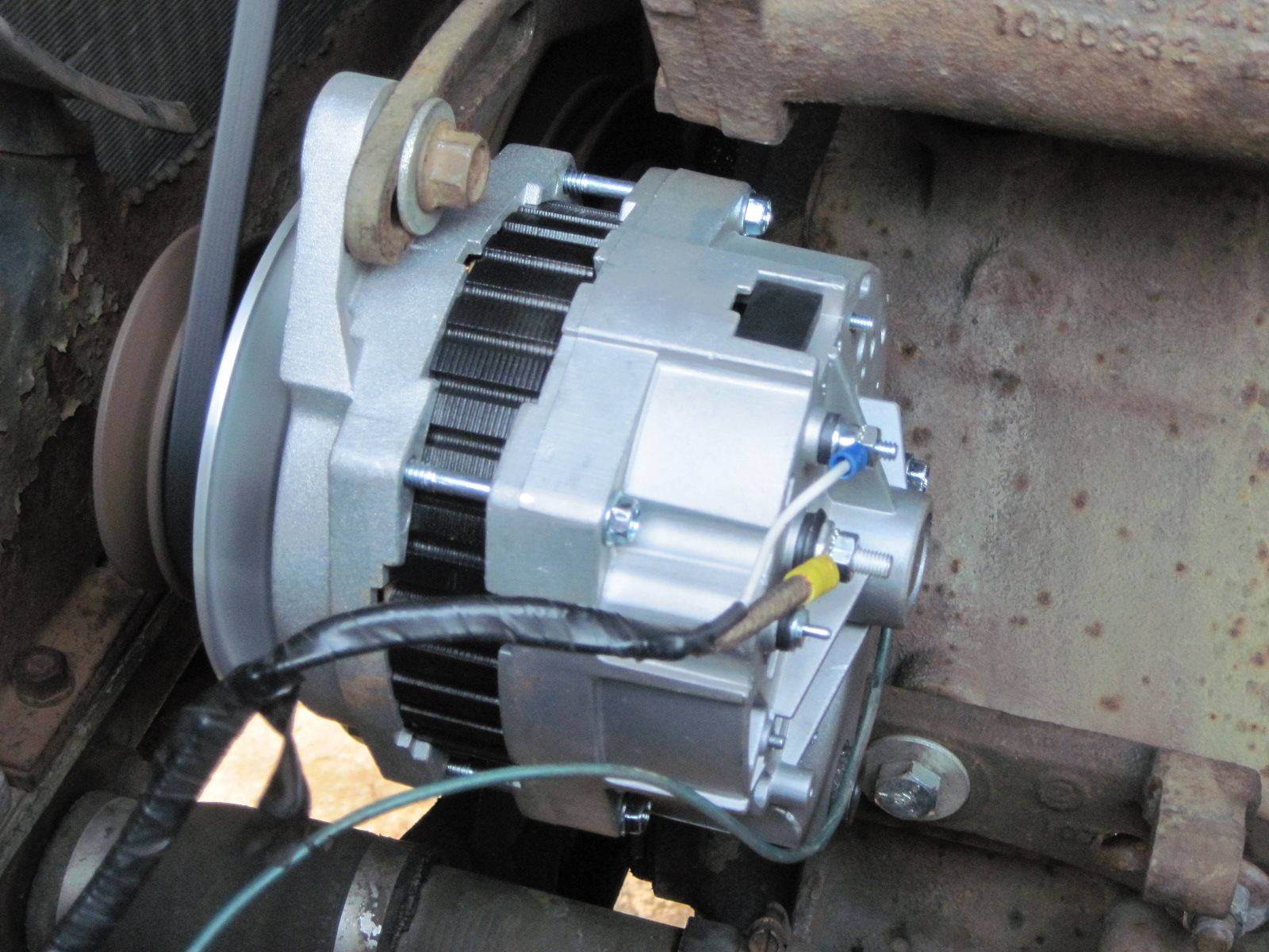

Got rid of my cheesy automotive (Delco 10SI) alternator...never liked it cause it wasnt very sturdy (cheesy adaptation of the stock mount) could not get the belt tight...replaced it with a Meritor ALT-1004 150amp (Delco 22SI clone) for only $120
Simple hookup, my original generator pulley slipped right on, the mount is solid (stock generator mount), simple three wire hookup (battery, dash light, ground)...I love it...will put a truck belt on this week, may sturdy up the mount with a sleeve to catch the rear gen mount, but dont really think it needs it.

I would get a second mount on it. The high frequency vibration will eventually fracture the single mounting.

Hi, hows the alternator attached at bottom?
Grant
Same as the generator mount...just not supported at the back...it is sturdy but there are concerns vibration may take its toll so I will build a spacer and get a long bolt that runs from the rear alt ear to the generator mount rear tab.

It is even simpler than the small ones! One wire to a guage on an ignition circuit (even this is optional!) and one for charging!
