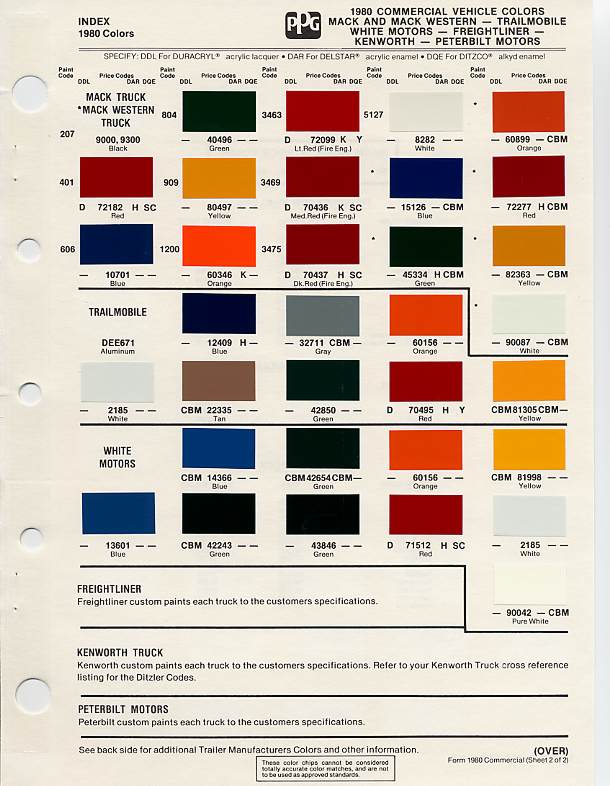

Will obviously be painting my CF600 in the near future. Waiting on paperwork from Mack Museum. Was curious as to what type of paint (enamel, etc) Mack used in 1980. And did they have certain types of red? I'm told red paint can approach $400 per gallon, yet I saw "Mack red" on a website for $69.00. Any help as usual, is appreciated.

Most were done in Acrylic Enamel with Hardener. Here is the PPG color chart, there are 3 reds specificly for Fire Trucks. Click image to expand. Paul
