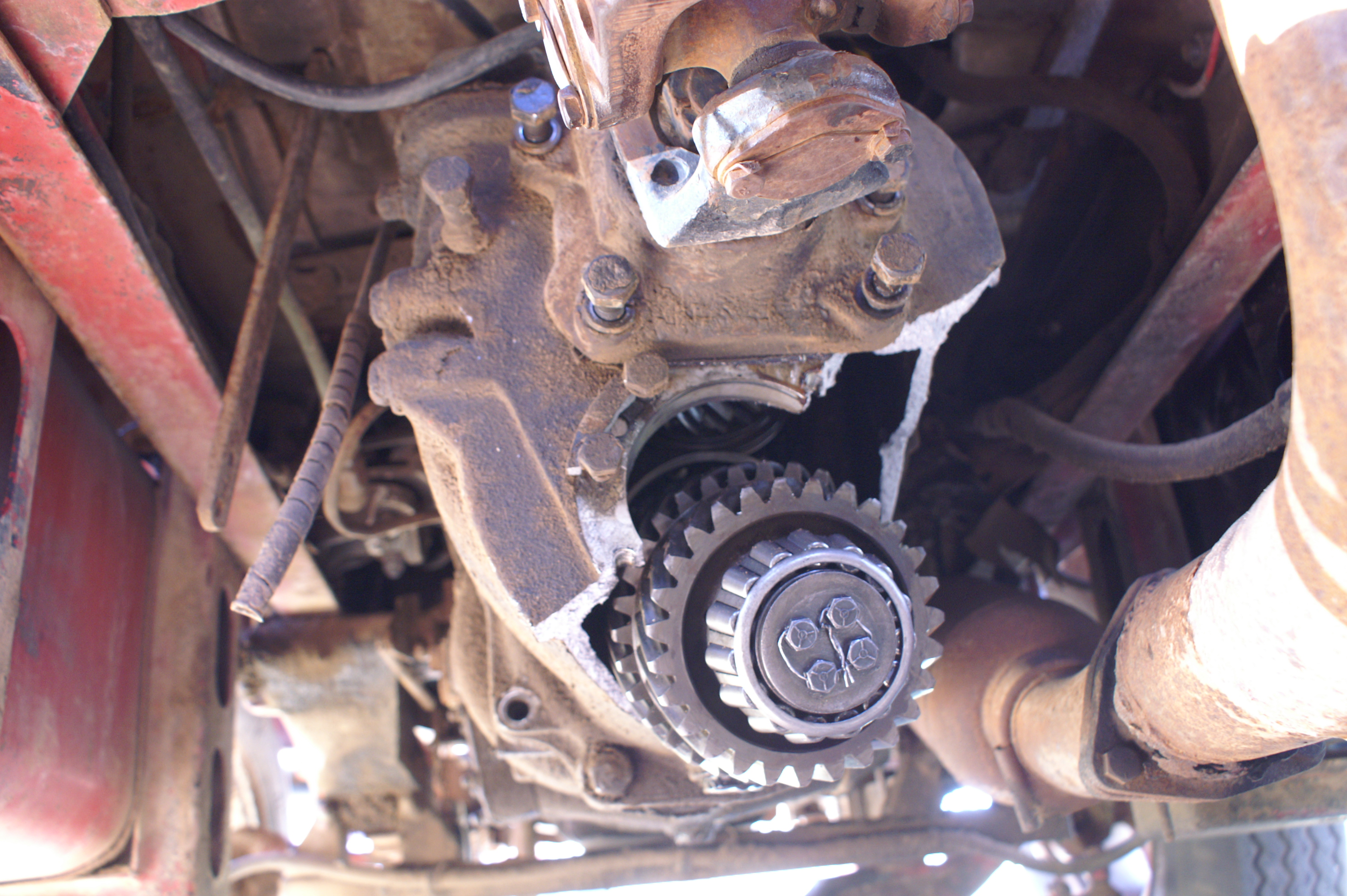

no wasnt towing anything i just got it running and ran it around the block was going about 10 mph and wham thats when it hit do you guys know what kind of options i have on just replacing the case or do i have to change all the gears and everything. Not a tranny man i can usally fix alot of stuff but this is out of my area. I dont think i could weld it to much pressure on it. So we will see i hope it dont cost to much if thats the case i might have to part with her. Wife is deff not happy about the situation.
I have seen them do that and most time its from getting in two gears at once. Low split and when you go into direct the low side fork comes lose and if your moving slow enough it will stay in low and go into direct then bang. Also a hard pull with big HP may do that. Look at the PAI website for parts.

Amen to what Glenn & Mike H. said! We had that happen to a DM600 with a quad box. The end of the compound stick was worn, and as the driver rounded a corner, he tried to downshift from Hi Split to Lo Split. The stick apparently jumped out of the hi split/direct rail leaving the compound still in hi split, then the stick got into the lo split/lo lo rail and put the coumpound in lo split at the same time. When any manual trans gets into 2 gears at once while the vehicle is moving, something has to give!!!!!!
