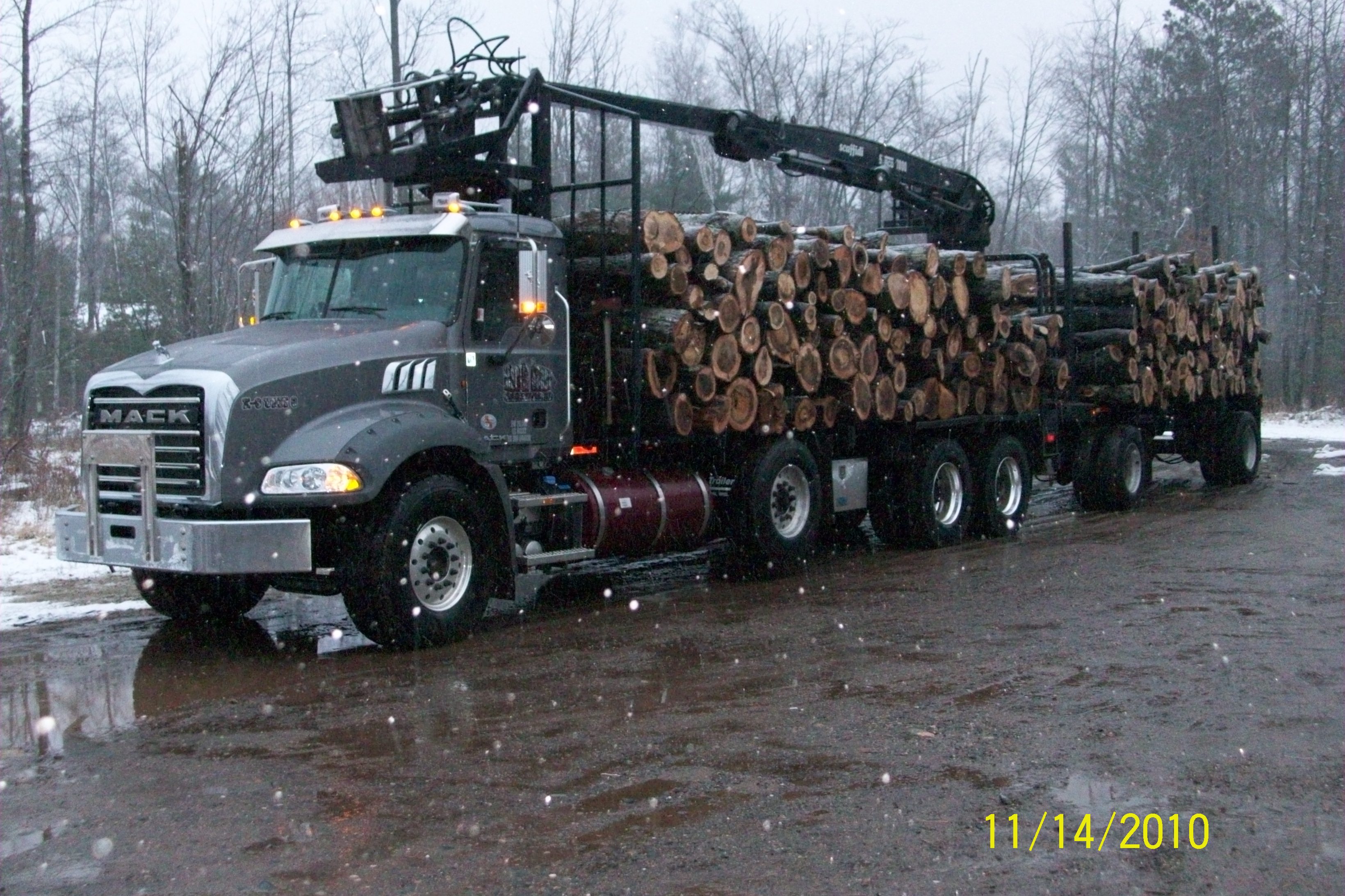

Things We Did To The 2011 Granite To Make It Work Fo Rme
1 We orderd it with two steel fuel tanks total 110 gal. Took them off and replaced them with one 26 in. 129 gal. alum. tank on the drivers side.
2 Moved fuel water seperater under the hood.
3 Move air tanks back between the push axle and the drives
4 Put hyd. tank where air tank and passinger side fuel had been.
The wheelbase is 292 in. wich is the longist you can go with this size frame. the bed is 23.5 ft
Why do all this ? to get as light as we could and to be able to axle out in Mich.18000 steer 18000 pusher 32000 drives and it works great. our empty weight is 38500 with the pup not bad for what we do and 500 lb lighter then my last truck with the same loader and rack.
My dealer Scaffidi motors put alot of time in this deal to make it happen.Sam Scaffidi one of the owners sat in on the sale to help with the (we'll pay for that and you pay for this.) Rick Lorenz was the salesman and answered all my questions or found the answer if he didnt know. I have been freands with both of them for 30 years. The enginers at Mack have a great weaght and balance program that really helped with the axle placement.
Setback Vrs setfoward Setback shorter wheelbase and lighter frame with same deck space 1000lb saved.
I heated the shift leaver and bent it foward about 2 in. and left about 1 in. fits good now
Added more coat hangers thanks for reading

Nice looking unit.
How do you like the Serco? I run a Rotobec and love it.
How strong is the mudflap behind the tag? with the air tanks there, I would want something substantial to avoid crap getting kicked up and damaging lines and such
Set back axle makes for better maneuverability

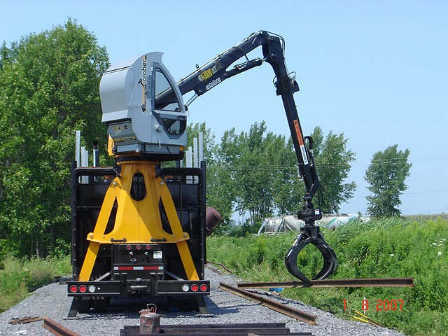

Rotobec did offer an enclosed cab that tilted down. Still looked like it would be too tall.
attachment=8962:rotobec cab.jpg
They do offer heated joysticks though

About the air tanks Its just a mudflap not much you can do with out putting a bunch of weight on. the reason for the tanks being outside the frame is to make it easier to keep dirt and bark from building up and with the concerns with invasive species this helps keep down the transportation of them.
Loader cabs Serco does not offer one but we are only up there an hour at a time at most unless you are sorting logs but the log buyer gets cold too so you stop and warm up. I have insolated rubber gloves and heated grips and a heated seat pad.
The rotobec cab does fold down to make height
Loglift and Kesla offer cabs as well but once again weight is the issue. In my world 500lb is worth $2200 a year so we are trying to keep it down.
Thanks for the input.
Serco 7000 is the lightest of the bunch 600 lbs lighter then a Rotobec and way lighter the a Prentice
Serco will build the boom any length you want up to 25'
This is my forth Serco so I like them. they are not quit as smooth as a Rotobec but the hyd system is not as sencitive to debris. Serco is also about5 to 8 grand cheaper depending on options.
Thanks again for the input

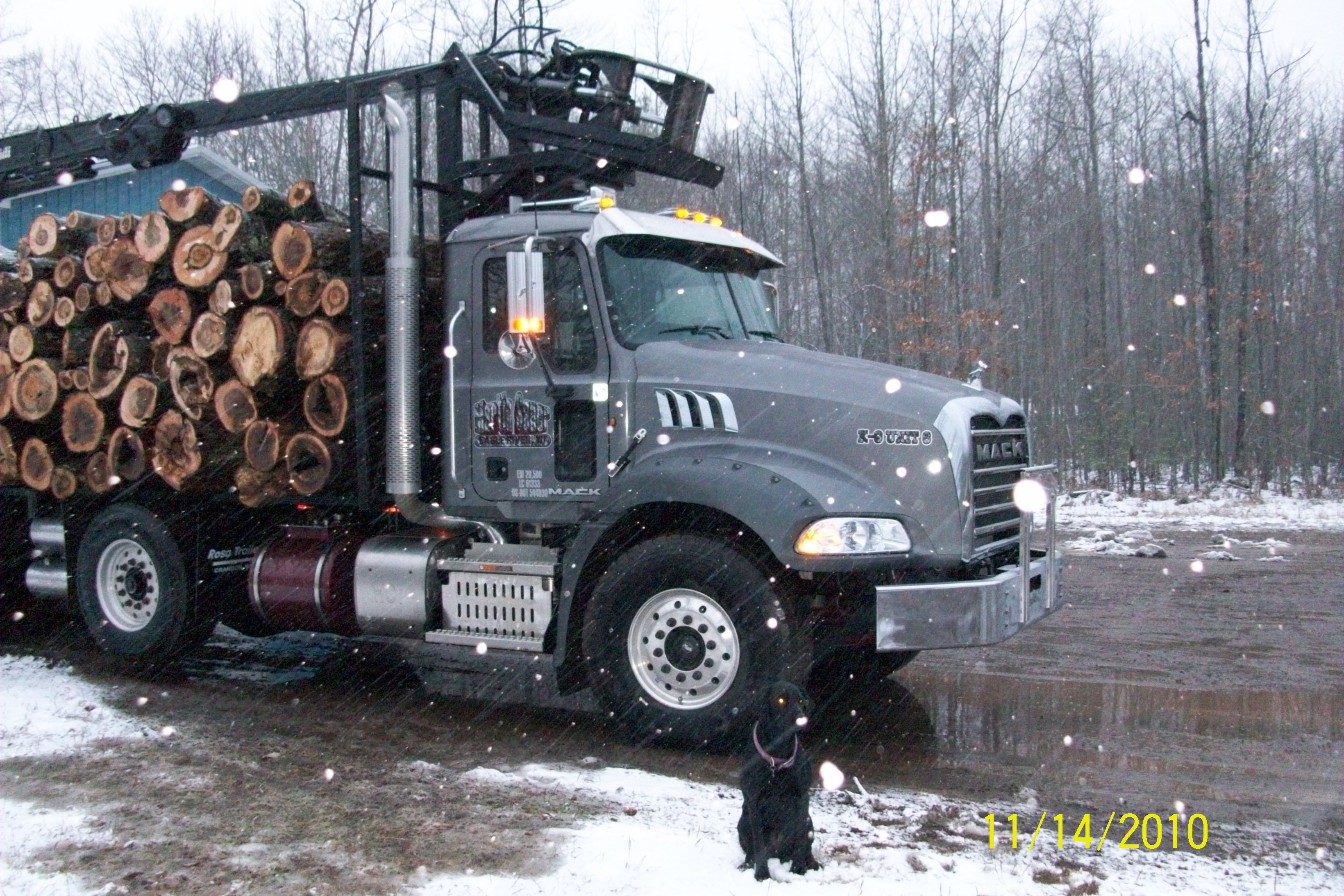

Snorky, Any reason you didn't get the Cab mounted exhaust? Probably could have saved you another 50lbs
It was not recommended becouse they had trouble with the mounts. You would save even more then the weight of the bracket becouse you can make the frame 6" shorter too.
We made a bracket that goes on the front of the stanchion that rotates the exhaust pipe out and forward about 6" so we could get the log rack as far forward as we could and still get in there to wash the cab.

There's a picture of one in my gallery, nothing too spectacular though.
The worst part about it was that the factory installed the air tanks behind where the SCR catalyst would have been if it was frame mounted, so there is a gap between the DPF and the air tanks that is basically unusable space.
Ive seen that style it tatkes up why to much room. the rr trucks Scaffiddi is setting up have those where room and weight are not so much of an issue. There is a cab mount that has all the stuff under the cab with the pipe mounted on the cab it was in the last Bull Dog mag.
