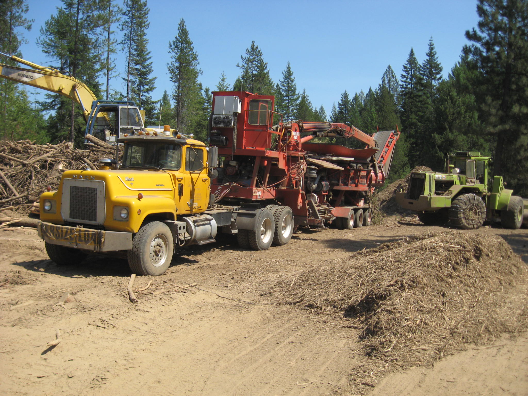

That is a real beautiful truck you have there. Are the drives on spoke or budd?

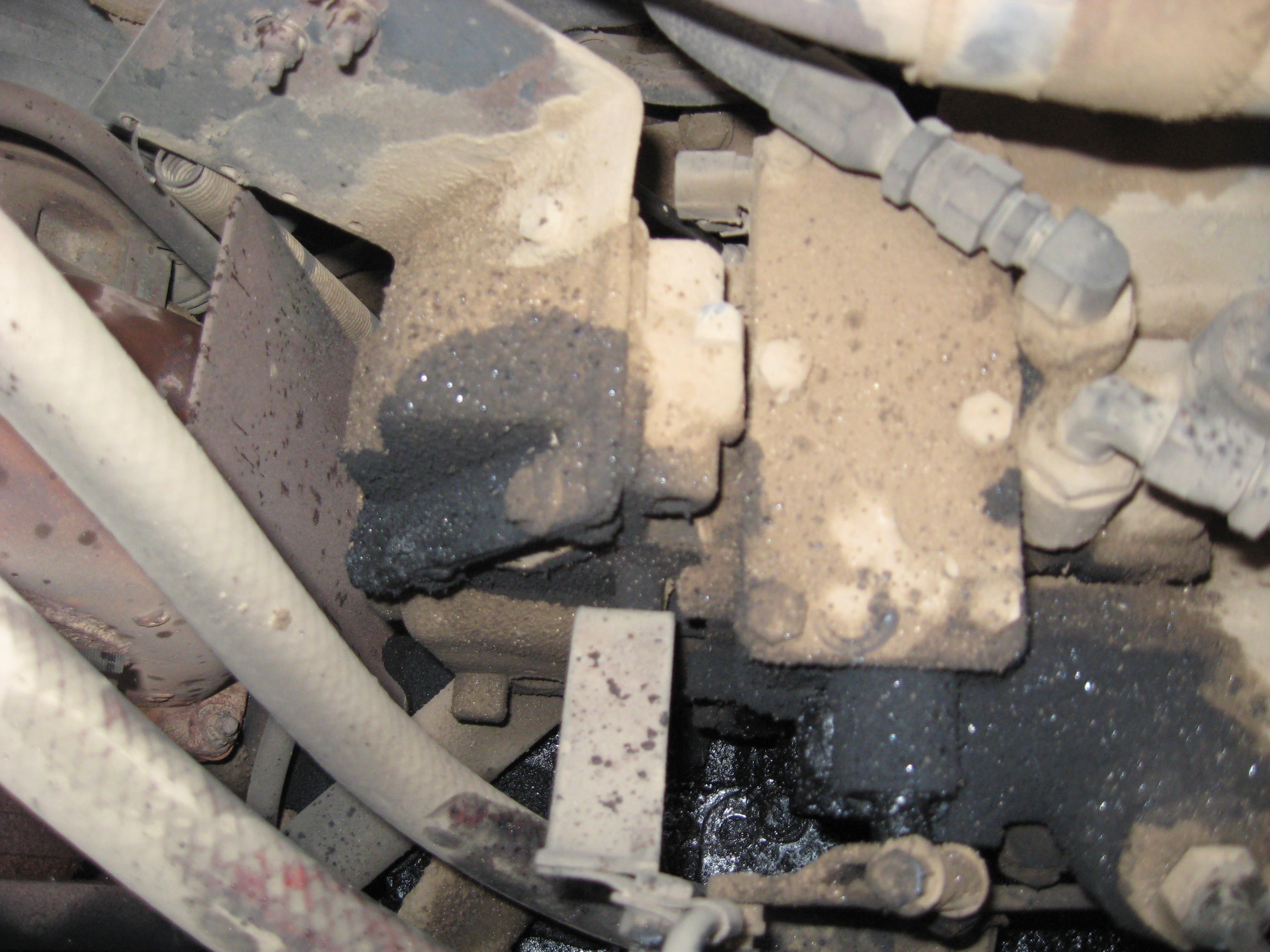

If you post a picture of the back of the fuel pump where the stop lever comes out I MAY be able to tip ya on a few tweeks. And I also agree with Thad on the Gramps truck thing ya don't wan't to go to far!A ten speed trans idicates to me it May be a 375 hp engine ya need to keep the rpms up a bit on these.
Thanks I really like her to.
It has budd wheels all the way around. and yes I do not want to go crazy turning it up. But I do not want to junk the engine while it still running. If i can not turn it up it is just dead weight i dragging from job to job with me and I would need to sell it.

here our some pictures of the back of the fuel pump. thank you for your time I have other pictures but they to big to post i can email them to you maybe. thank you my

OK behind that 4 bolt tin cover you will find a jam nut 3/8 with and allen screw thru the center( I BEleive )If I remember corectly loosen the screws jam nut and turn the the screw out one half turn and lock the jam nut And give it a try for power Its been years since I been inside that style governer but, If that dont doit or reduces the power turn it back the other way 1 turn !
once you find which direction does the trick tweek as desired don't go to hay wire with the turns youll kill the thing!

I totally agree with fhese coments and highly recomend checking them first before doing anything , the adjustment you will b making is the fuel delivery adjustment.
pictures of the front of the pump would be in order here to see if the puff limit is still operating!
