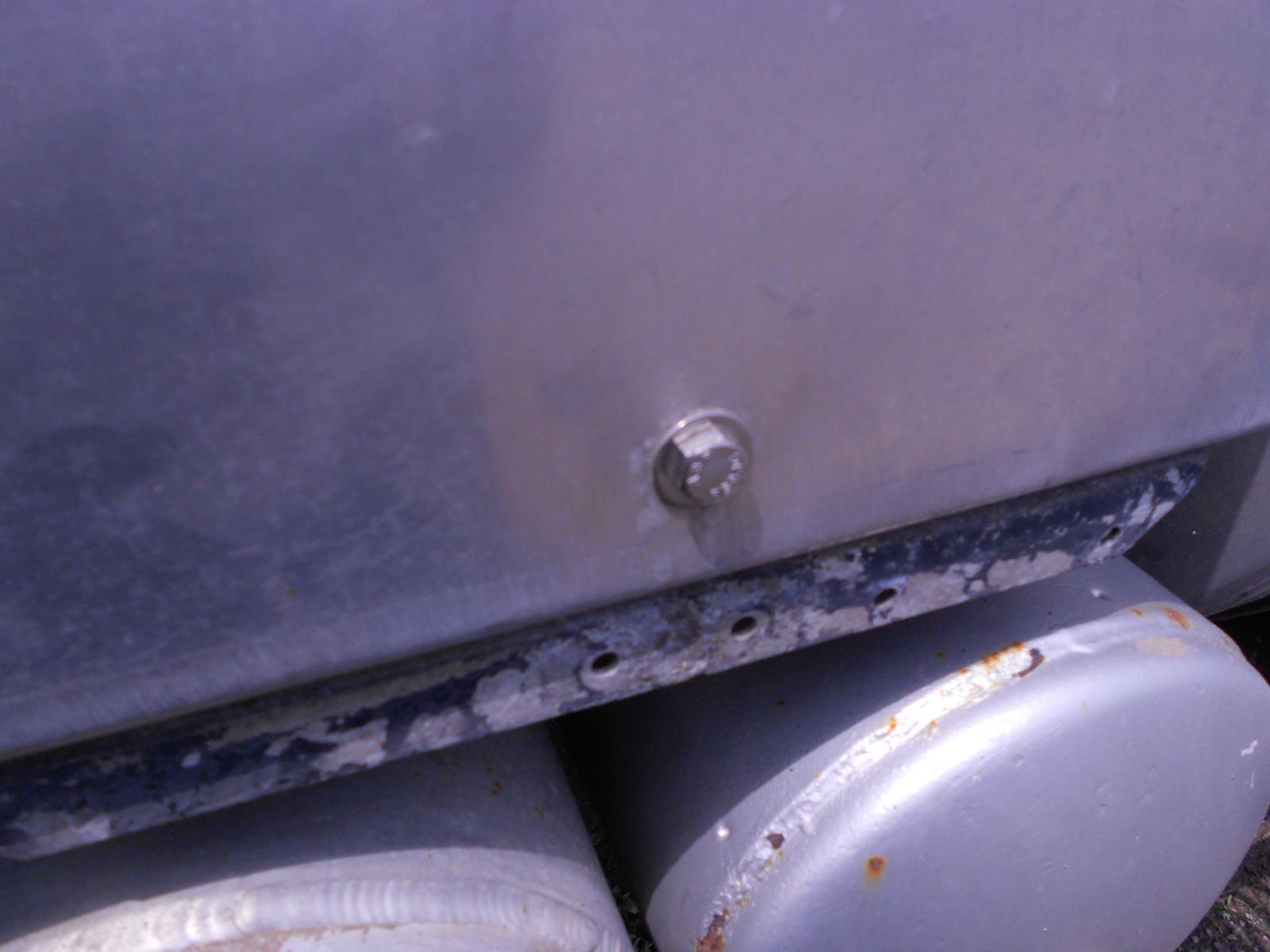

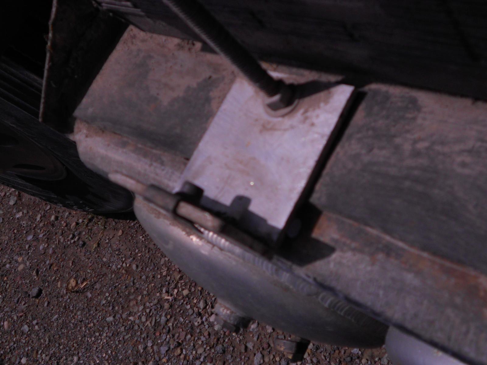

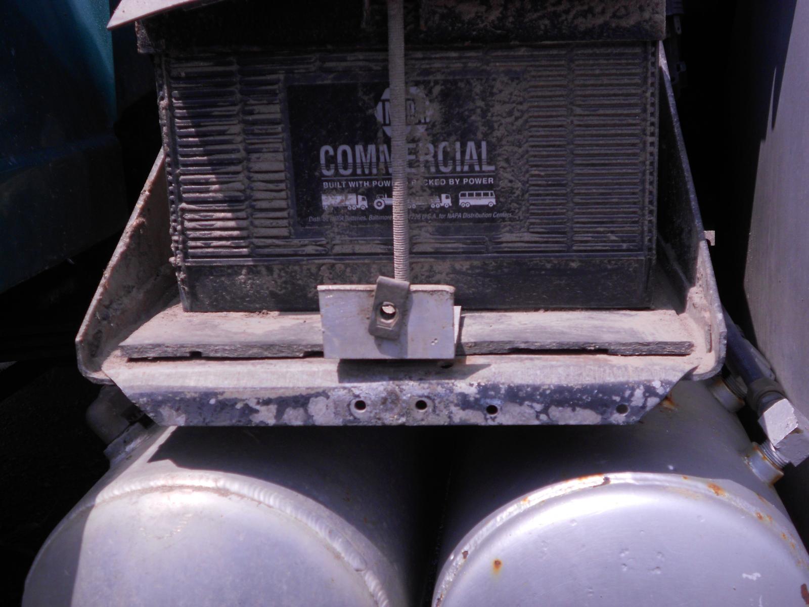

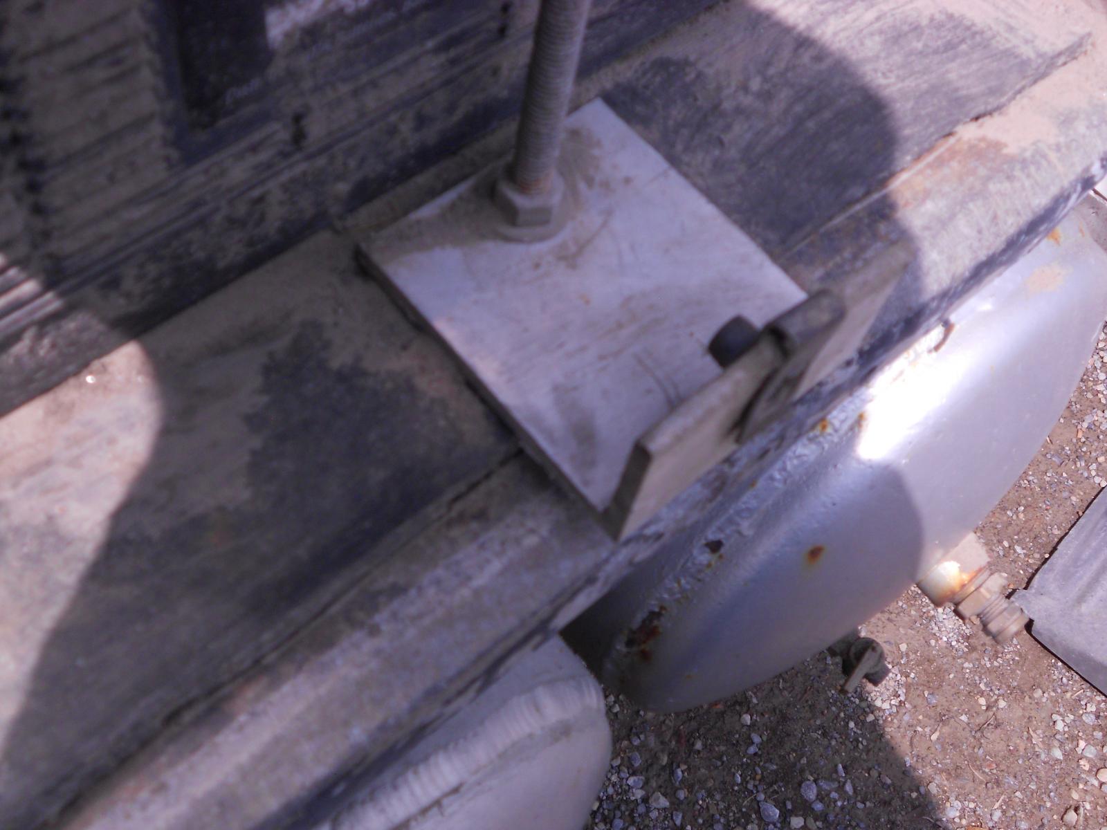

Thanks Mike. Every Superliner I've been around annoyed me with the rattling battert box lids.I have a 2 inch long piece of 2 by 2 alum. angle that is held on by the battery hold bolt. That is drilled and has a 3/8 u-nut in it. The lid is drilled and has a 3/8 by 1 stainless bolt holding it on. I'll get a pic tomorrow so it makes more sense. Steve

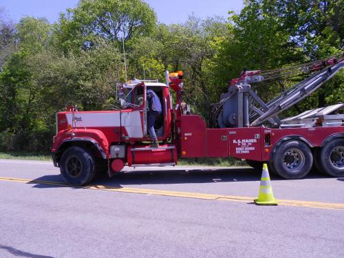

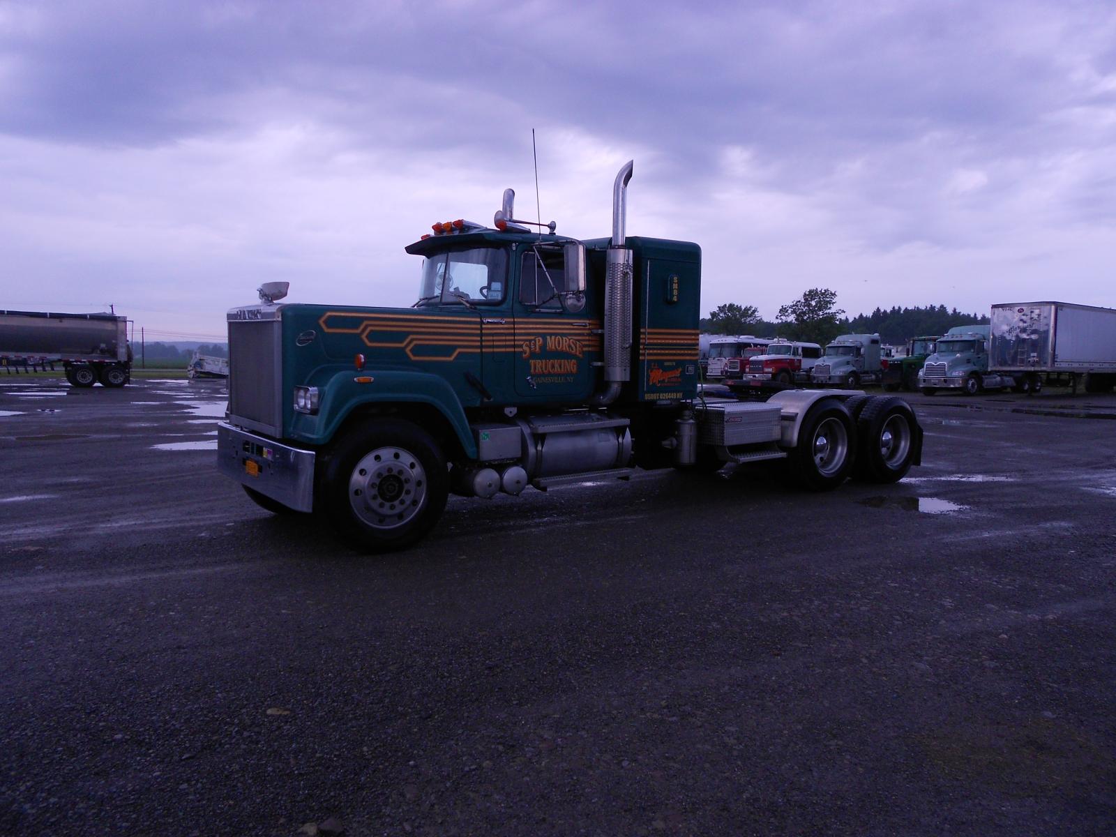

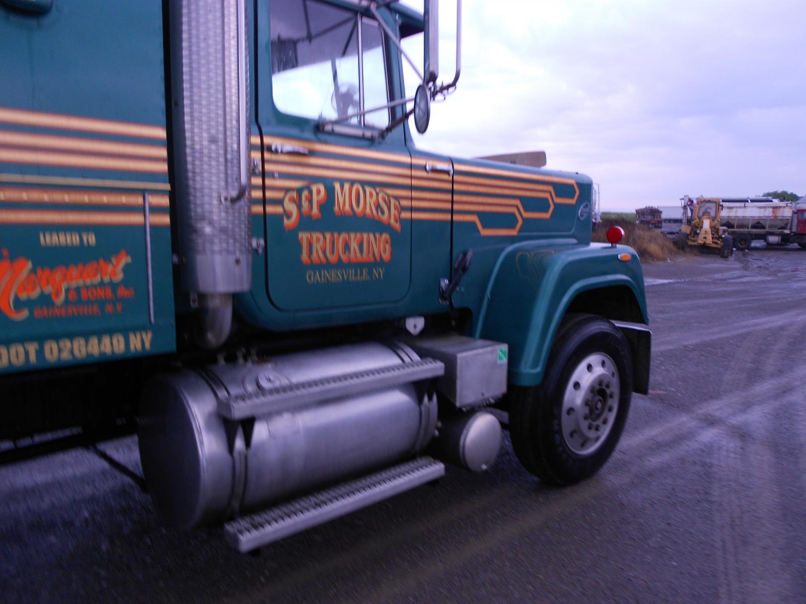

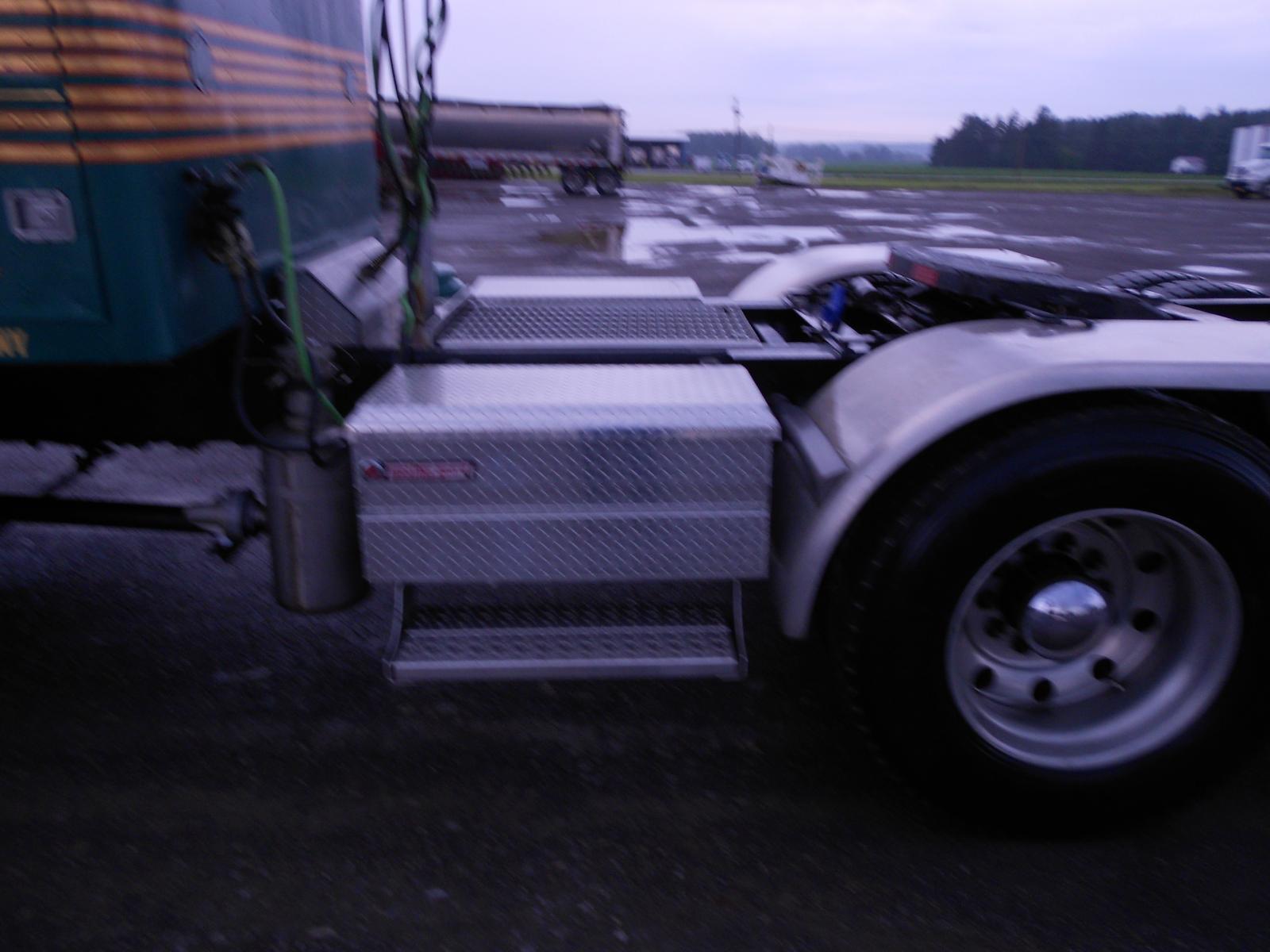

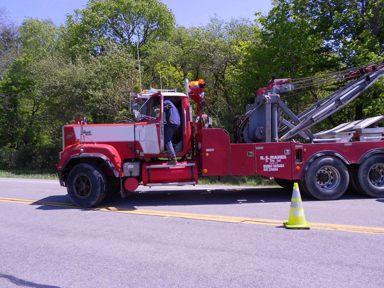

On Tuesday I had the pleasure of having Ray drop in at work to visit for awhile. He had unloaded and reloaded in Buffalo ,had time to kill so stopped by to shoot the breeze for a bit. It's always a pleasure to talk with Ray, we are on the same wavelength.I snapped a couple as he was leaving. That 60 Series sounds sweet. Steve
Thanks Ray. The old girl has been all over lately.Been running between Linden,NJ and Terre Haute IN alot.Lot of Winsor ON to Jersey too.Been too busy for my tastes,but make hay while the sun shines.Good hearing from you. Steve

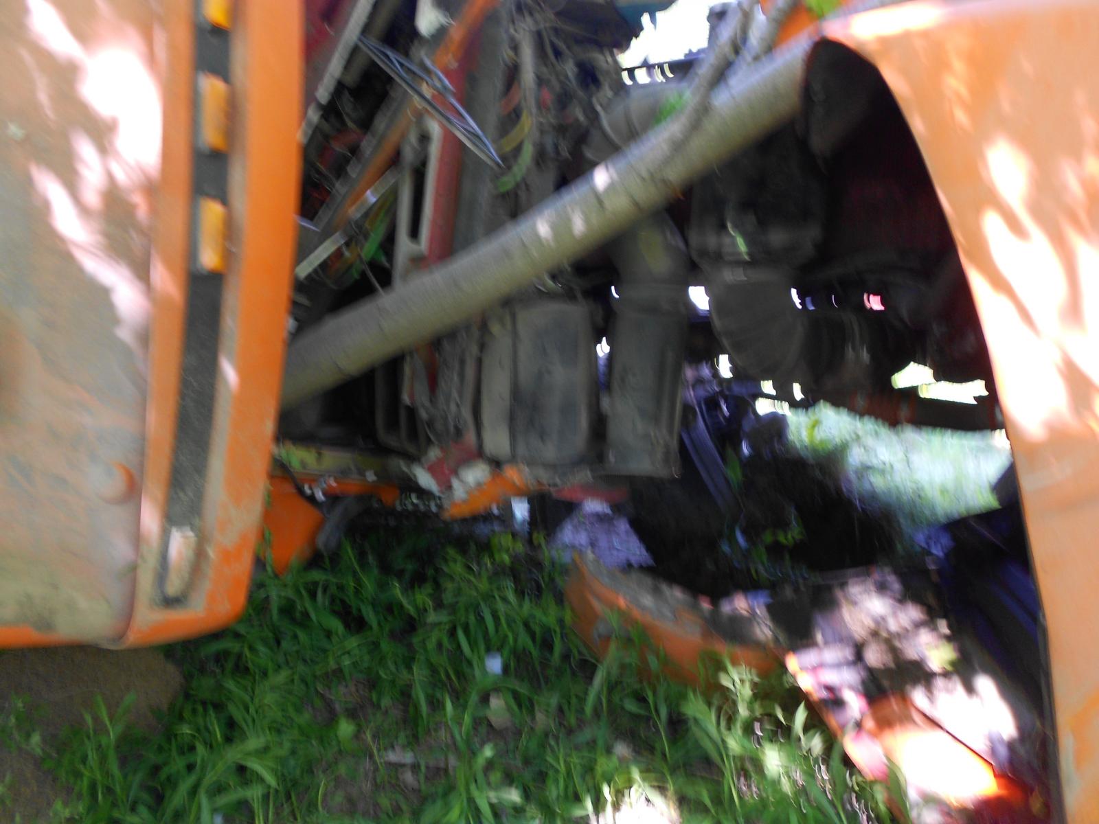

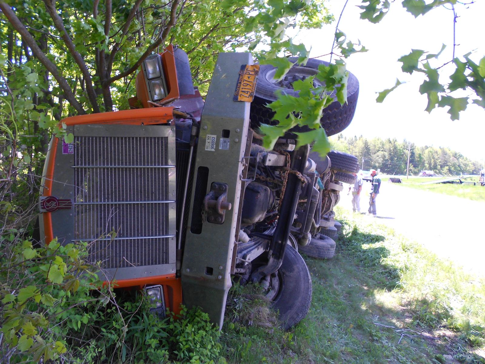

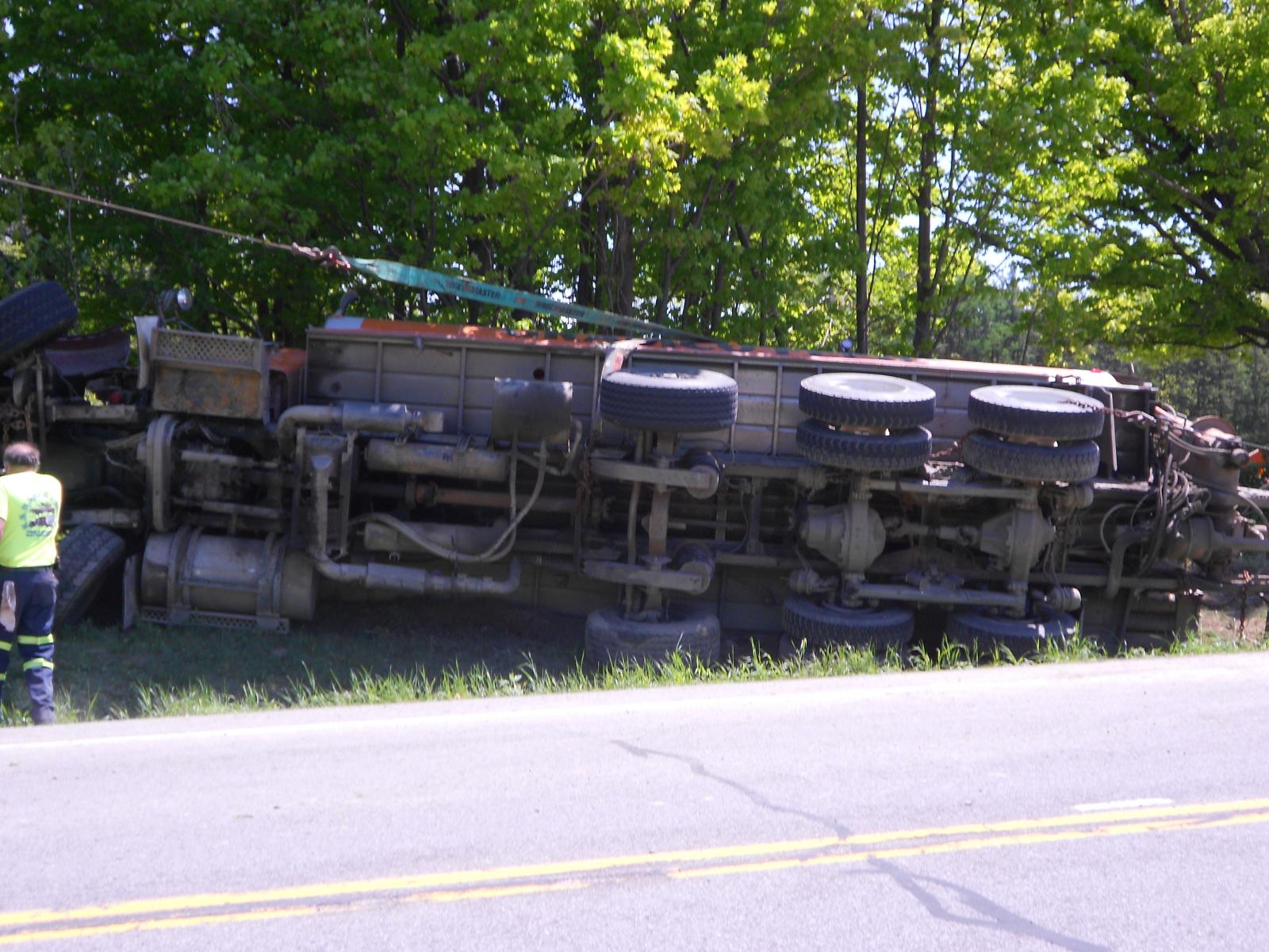

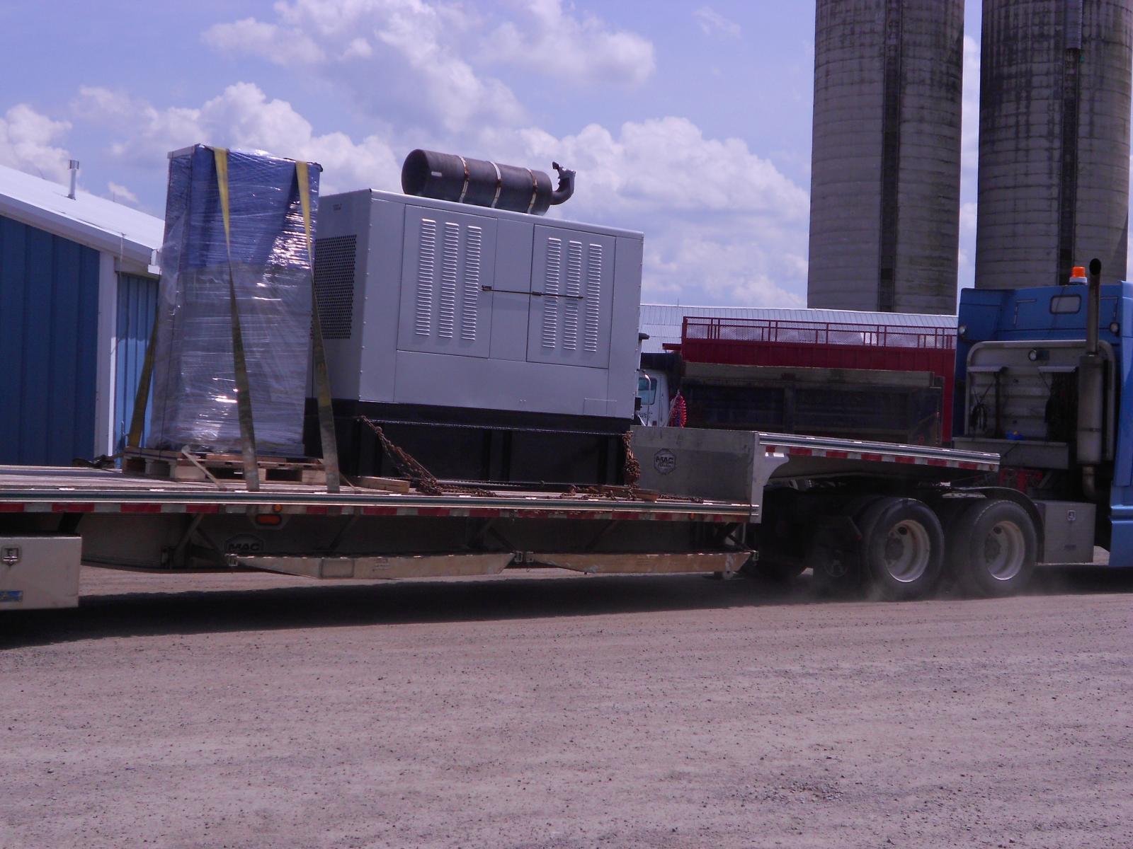

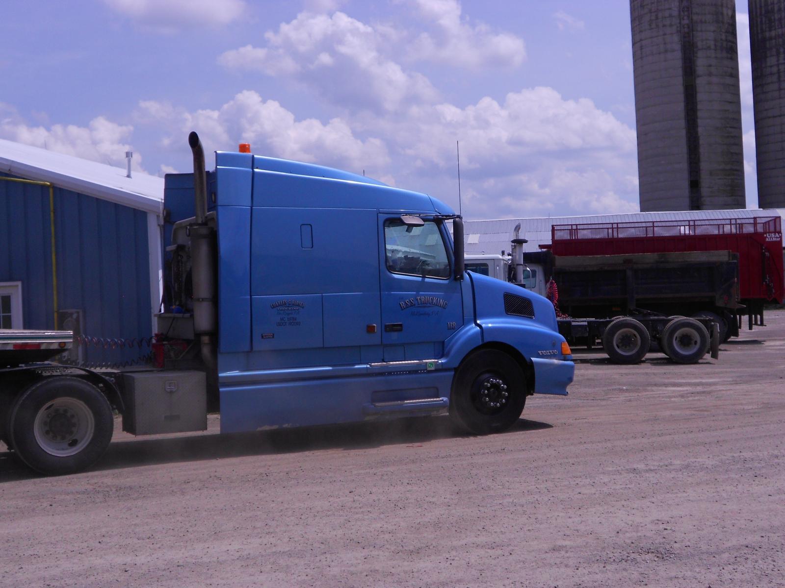

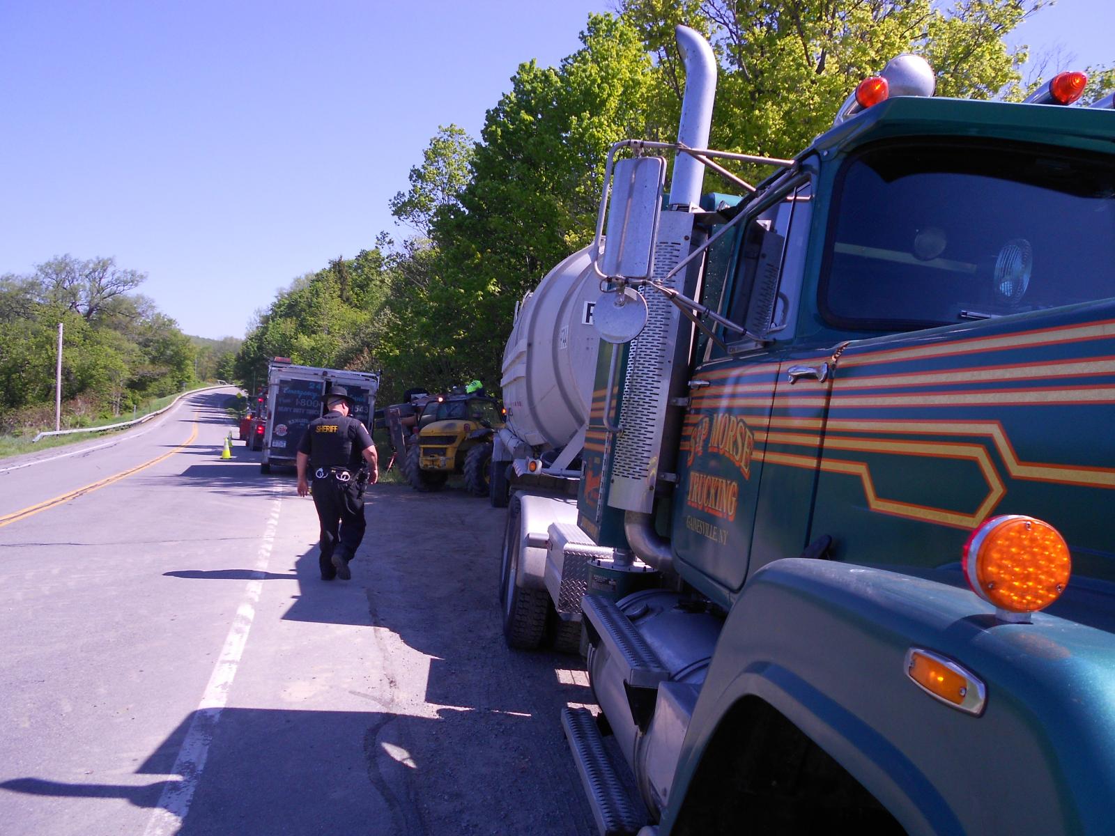

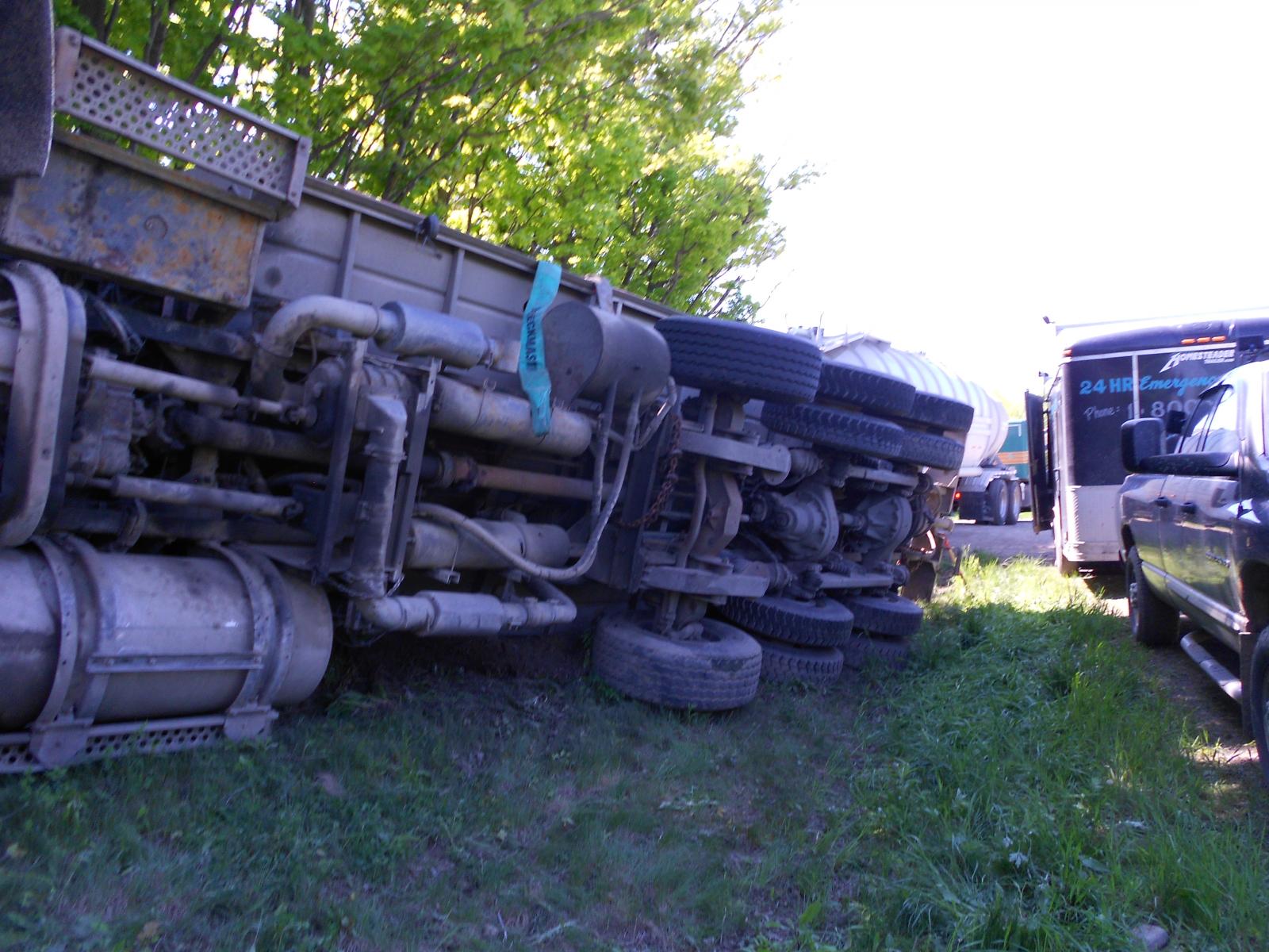

Went to vac out an overturned feed truck this morning.Didn't feel out of place 'cause there was another old dog there also. The driver was very lucky,didn't get hurt too bad, the firemen said he was out standing by the truck when they got there.

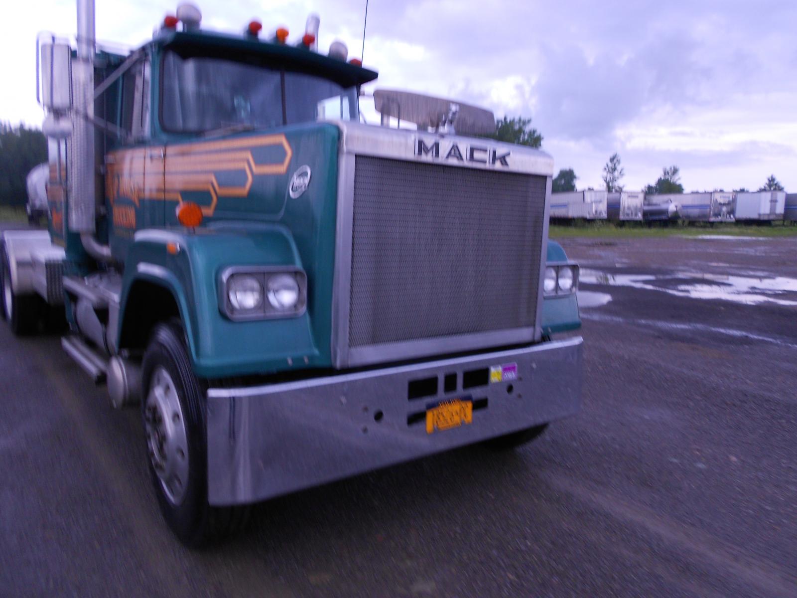

Lookin' good Ray! Glad to see the old girl back and ready for work again.Shouldn't lack for power. Nice job, looking forward to seeing it again. Steve
