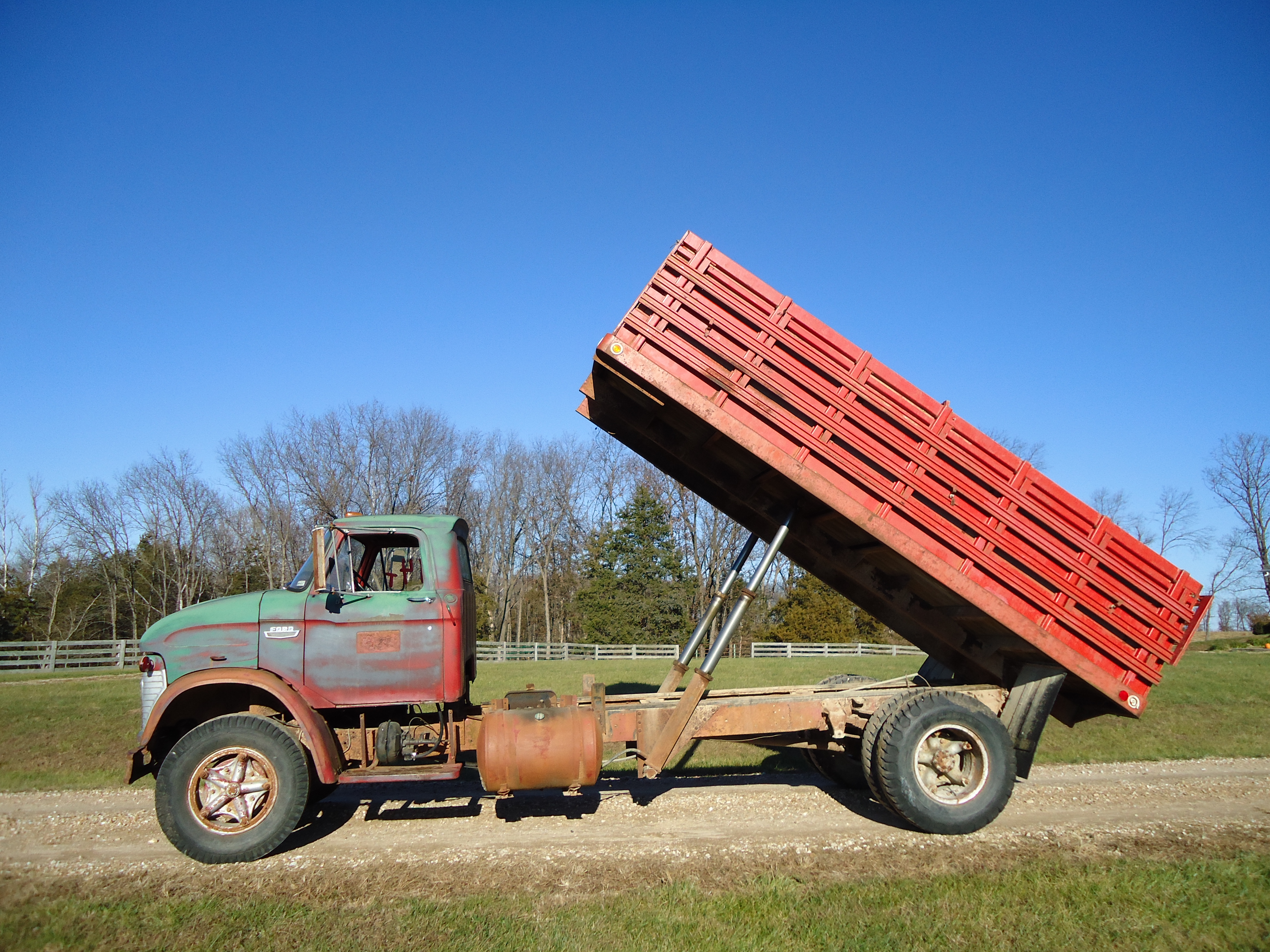

Check out this old Ford stub nose grain truck I am selling on ebay - I wish someone would buy it to restore, it is really a straight old truck. http://cgi.ebay.com/ebaymotors/ws/eBayISAPI.dll?ViewItem&item=330501168914&viewitem=&sspagename=STRK:MESELX:IT#ht_2119wt_1196
