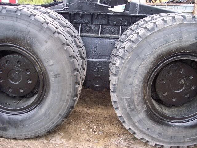

  2. 99% sure that's a Mack axle, lots of Mack part/model numbers cast into it. Seems like Meritor bought out Rockwell years ago, who did build a lot of front and rear axles in the US. They are continuing the Rockwell line as well as new stuff, but have been supplying parts for other brands as well. Recently noticed Meritor (not sure all or part) got bought out by Cummins.
  3. I'm seeing 18k # weight capacity from a parts catalog/pdf (PB-8951).
  4. That's what I've seen in the Mack manuals I have.
