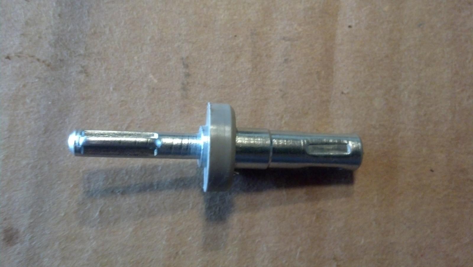

Good Morning Brian, thanks for your thoughts. When I tested it the speedo cable was attached to the gear ratio reducer and the speedo worked, with a drill. I suspect it could be slipping where the spline comes off of the gear ratio reducer and goes into the shaft & gear that slides into the trans. I've got to test it at that point next chance I get.

Almost a good deal.....got it all back together today and no luck, still no speedo. Removed the gear ratio assembly off the trans, put a drill on it and the speedo does work, my drill runs at about 35 MPH. Also, pulled the gear shaft out of the trans yoke and it looks fine and seems to fit snug back in place on the assembly and in the trans. Any clues?

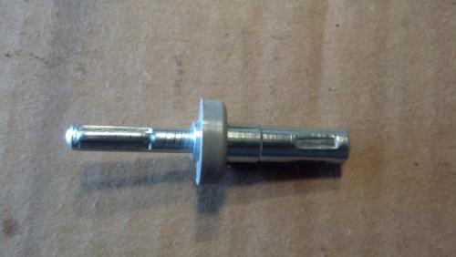

The correct term would be "tang". I got me a metal tang today so now I should be able to tell how slow I'm going.....

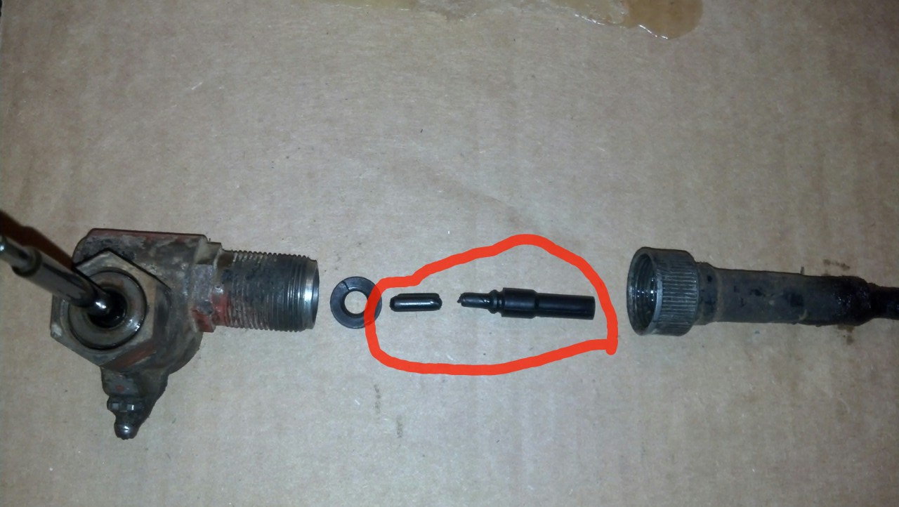

It's hard to tell, looks like it could have worn thin and just twisted. I read in another thread where these were replaced with metal but in return would break the cable if a problem occured.
Thanks J! Also, my cable spins easily but I didn't see any lubrication, should it have any? Other than it being plastic, wondering why it broke.
Hello everyone! Hope all is well. Started a speedometer repair on the 79 RD today and discovered that the plastic adapter between the speedometer cable and the transmission gear was broke. Anyone know what this is called and is it a Mack only item? Trying to save some run around time and didn't want to go in the parts store asking for a plastic thing-A majigy in the moring.... Thanks... edited: think either my brain or my fingers are not co-operating this evening.

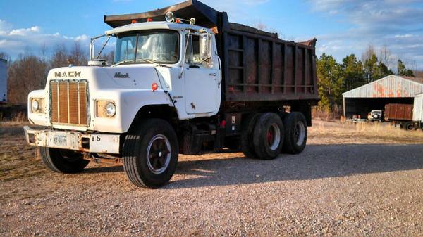

Found the pic of that DM with gold light trim, also had gold grill mesh. Not a real good pic, but this is the truck I went to look at and ended up buying the truck that wasn't for sale This DM wasn't a bad truck, just needed more work than I had time for, it's still available. -
