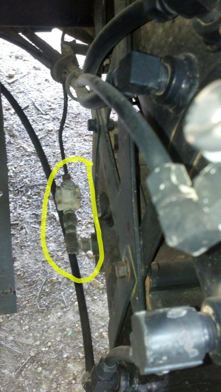

  5. Hello! Started having problems with my air system. Yesterday the secondary wouldn't build past 90 varying a little, today it seems to be stuck around 60, wont leak down past or build. Drainded the tanks, very little came out. Checked for leaks, found that my cab air ride bag is leaking a little. Wondering if the valve circled in the pic below is giving me trouble?

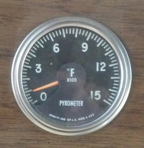

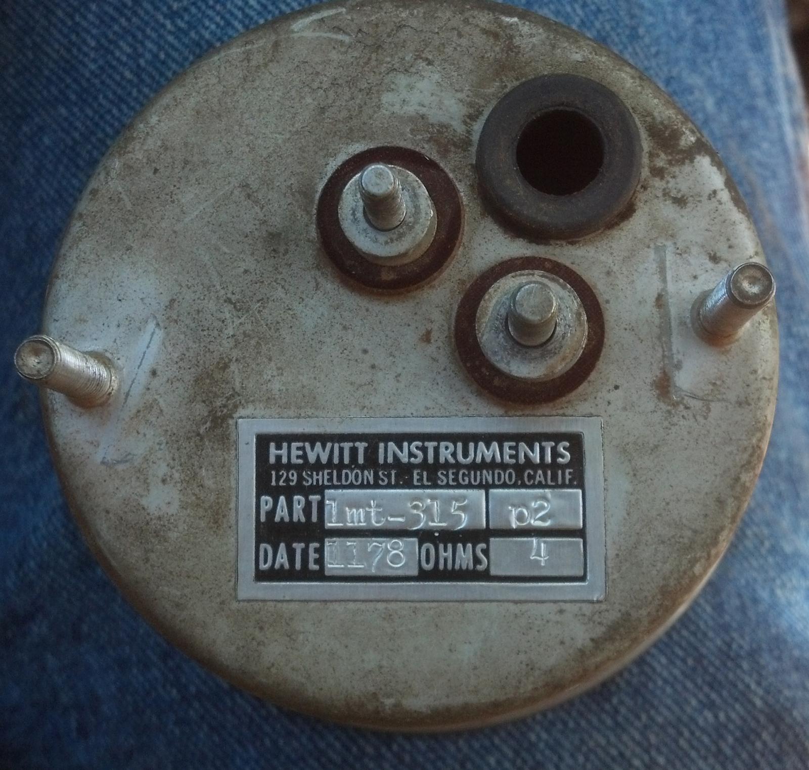

  15. Just in case the link ever gets removed here's the installation document. 180-0054 Pyrometer Installation Instructions rev 07-12.pdf
  16. I was all over that website and didn't see that link untill now. Thanks, who would have thought, no power. I wonder if they require a special thermocouple?
  17. Hello everyone! I'm rained out here in Bama today and trying to fix a couple odd things on the '79 RD dump. The truck still has the original pyrometer installed but it's not wired up properly. As you can see in the picture, it's got two electrical studs, a small one and a larger one. The light socket and power for it are seperate. Where do the yellow and red pyro wires go and how do you bring power into it? The previous owner had replaced the pyro wire and just wired it in straight to the probe and didn't bring any power to it...???
