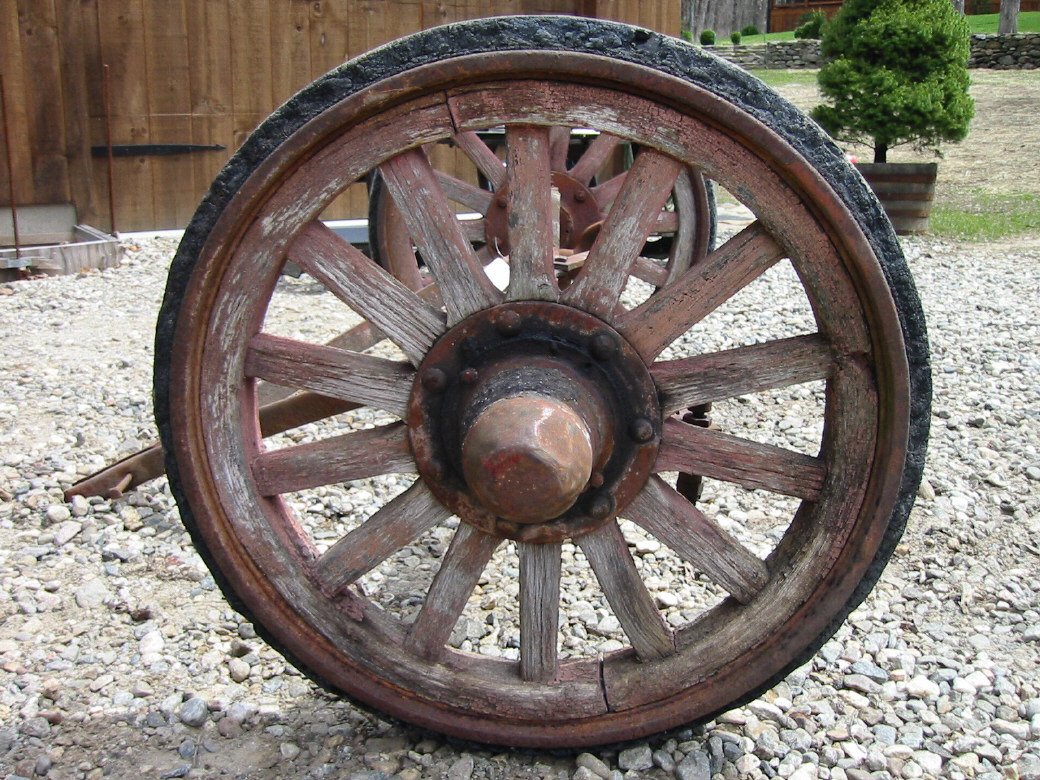

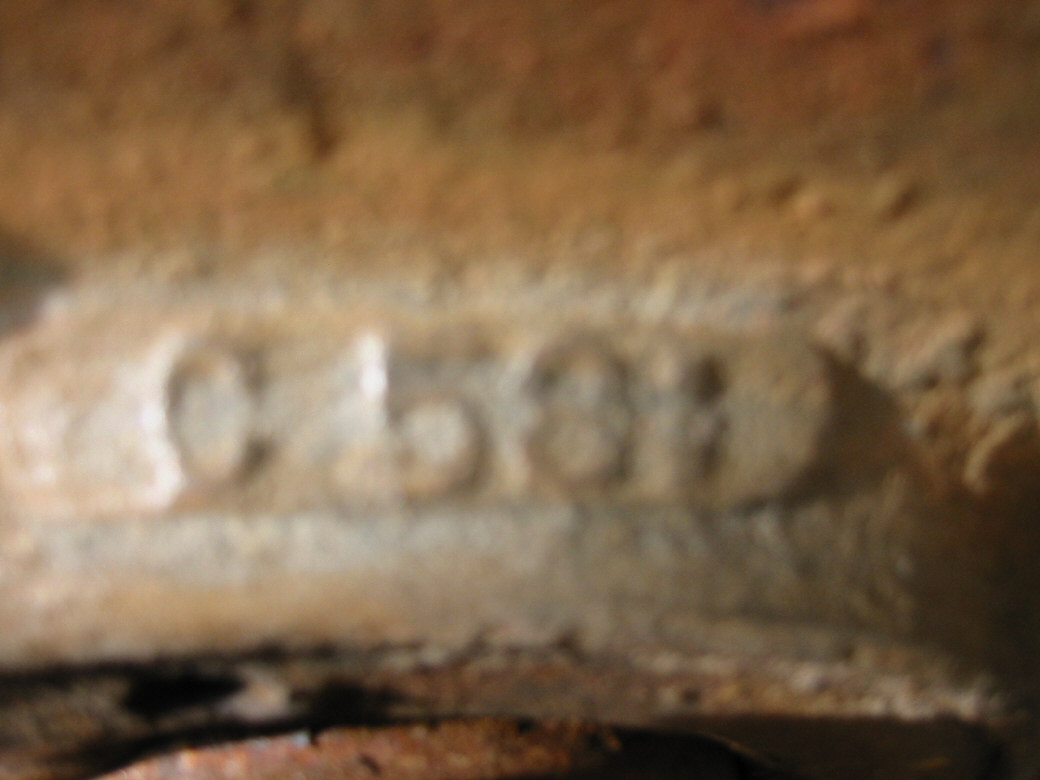

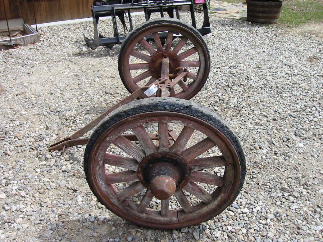

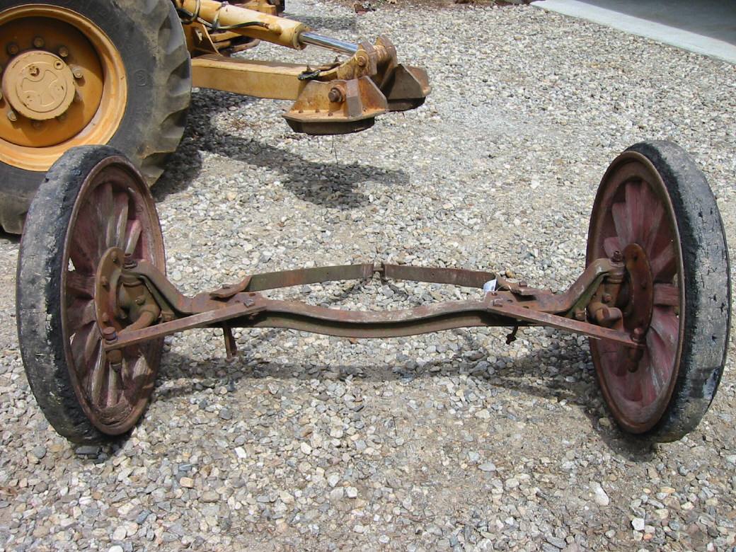

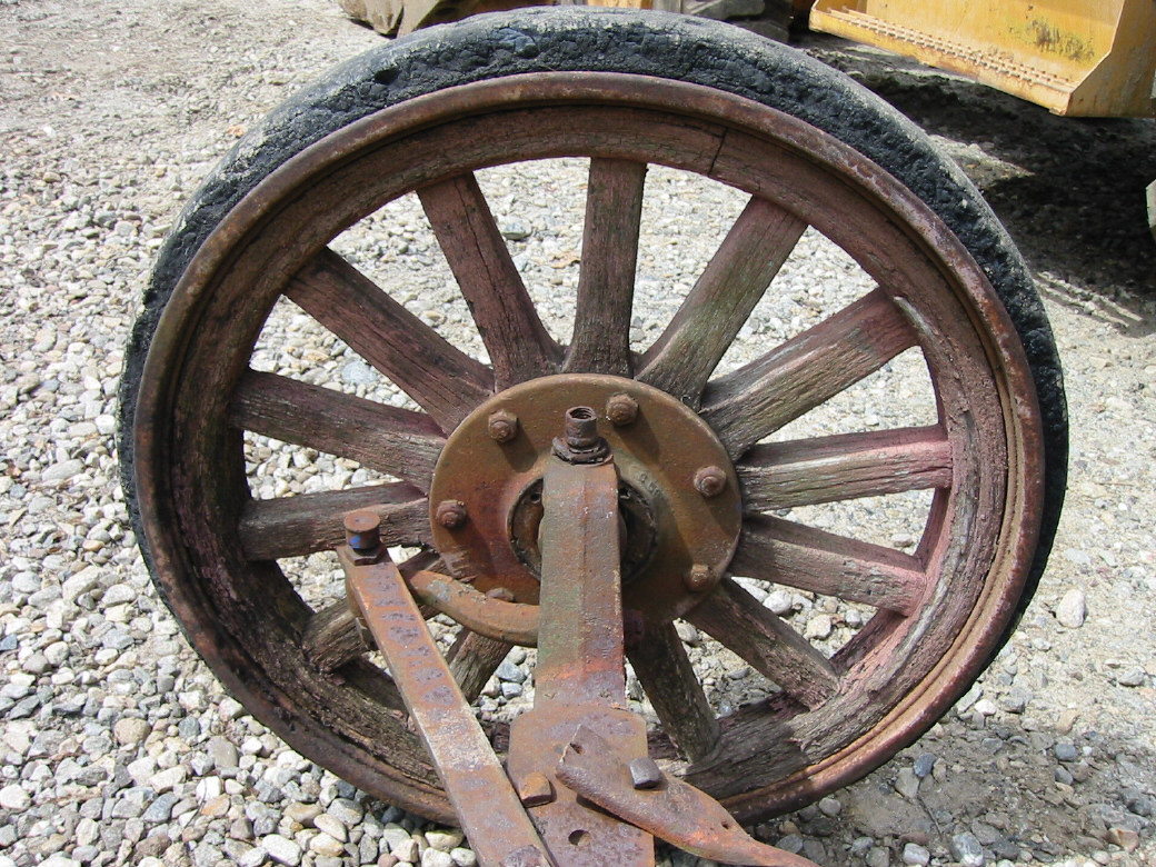

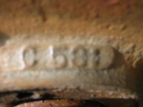

	I picked up this front axle at a farm sale and I was wondering if anyone knows if its a Mack axle? They have no markings except for C581 on both hubs. They are 59" wide from center of rim to center of rim. The rim diameter is 29-1/2". The wood spokes are 1-3/4" square at the hub. From center to center on the spring mounts of the axle it is 28-3/4". Its a narrow width axle but a tall wheel, looking in my Mack books, the number of spokes and the number of bolts matches an AC, an AB or even a Manhattan. I was leaning towards a Manhattan only because of the width of the axle. Any help would be appreciated. Thanks, Art

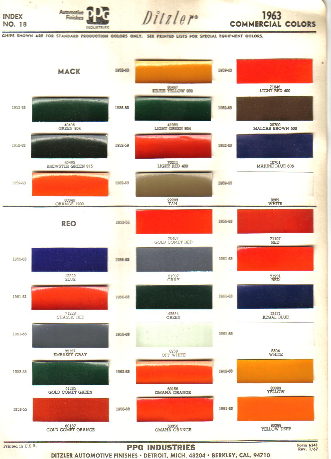

	I have a 1963 PPG / Ditzler paint chart and for Mack it lists for years 1952-1959 Light Red 400 #70211. For years 1959-1963 Light Red 400 #71046. Hope this helps. Art P.S. Click on picture to enlarge text.
