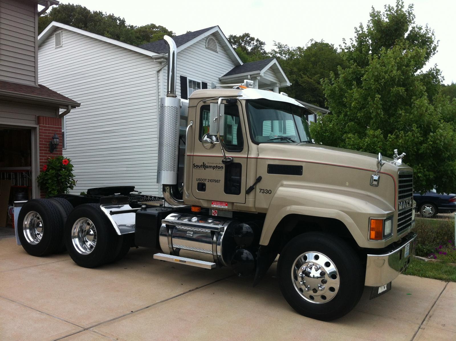

Just an update to complete the thread for future reference. The dealer flashed the ECM with the latest software update applicable. It retains is original 71 series turbo. We have had it back and been running it without any further issues other than a persistent burp on decel. The truck still throws an 8-3 EUP code and an occasional 1-8 code which I believe is a fan speed code. A few pictures are attached for fun.
