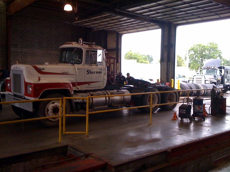

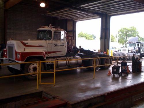

  15. I pulled my drop deck today into a local truck tire store to try and get a tube for a 1000x15. When I got there, this RS795LST was in the bay getting 10 new tires and wheels. I wound up buying the ten 1000x22's and wheels they were taking off. They were in great shape, but are old. The truck is in very good shape and has been repowered with a 3406 Cat. Not sure if its a DI A model or a B model, but it is definitely not PC. I talked to the owner by phone and he still uses it to pull some farm Cat's around. All the guys in the shop were trying to figure out the odds of 2 Mack RS700L's in the shop at the same time, much less the same month nowadays.

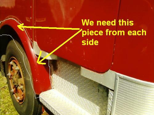

  19. Has anyone bought or tried to find the front outer fender for the front axle on a CF? I'm working on a CF that has the usual corrosion through the skirt.

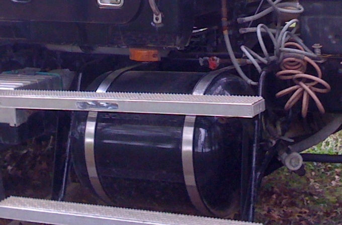

  25. Here is a picture of the air starter tank I was referring to. It is aluminum but painted black.
