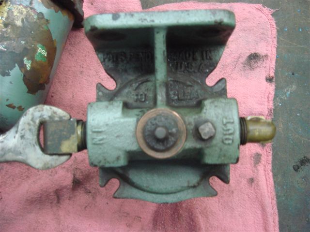

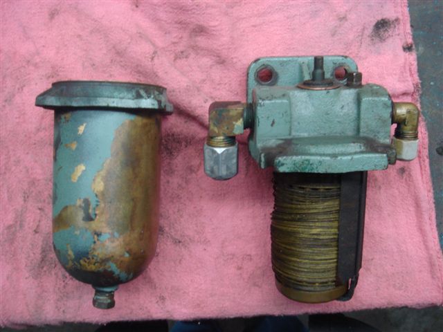

  24. this is fuel filter off of a 1961 b-61. end673. i assume some part is missing off the top where the small bolt is. like a knob or something that would screw onto the 1/4" threads. the serevice manual says a cup nut which would be inverted and screwed back onto shaft to rotate windings to clean. does anybody have a pic with this all intact? i see on top it says "to lean" with an arrow. does this mean there is some type of adjustment or something? service manual says this unit is a manually operated self cleaning permanent element inside.
