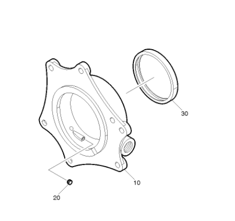

Old number 14QK382P2, new number 24434811.
According to a 1991 RW7 VIN I have, old number 227QS310BM, new number 7843-1S6026. See picture below for what I see.
