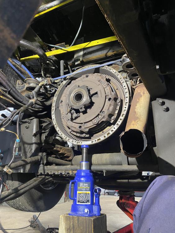

  19. Thanks a lot! I just wanted to ask before getting to far into it. Just got the flywheel back from machine shop. Trans is rebuilt and new clutch is ready to go in. We are doing away with the hose (Vogel system) as it wasn’t working properly and the hose was also cut. The new bearing has 3 grease fittings on it. I was also curious how to measure the gap between release fork wear pads and bearing. I have some “tools” for it but it seems to be very difficult with the Mack’s fork being “upside down”.
  20. Also how are you guys measuring release bearing yoke gap with the release yoke upside down? The 1/8th measurement.
  21. Hi, I didn’t take notice to the bearing orientation when the clutch was removed. First time doing a clutch on one of these and couldn’t find info on it. To save me time tomorrow and looking at another truck I was curious if someone could guide me in the right direction. Does the round side face down or the flat side? As usual all your help is greatly appreciated.
